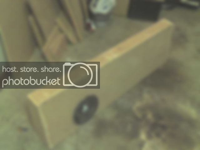

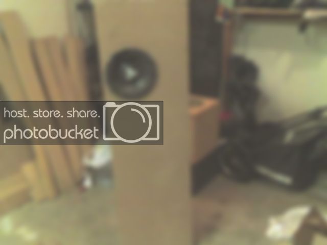

Built this last night for my brothers 4 door.. Fits behind the rear seat.
It's 2.5 cuft
Built to house some fashion of 10s... 2, 3, possible 4
Originally thinking 3 JL 10w6v1s if we can find them. Test fitted one of our old blown ones and it fits like a champ. Because of the lack of finding these, we may have to go with 3 JL 10w3v2-d6s... Not quite sure if we can fit the 5.75 mounting depth of those as compared to the sub 5 inch w6s...
The mounting depth dead center is 5.75, but we aren't sure if we can fit the sub with the taper of the box. If we don't end up going this route, we will find some other 2 subs that are dual 4... we will end up needing a final 4 ohm load to go with the Kicker Impulse Ix2302 (900 at 4 ohms bridged)...
Any input for 2 SQL subs if we can't find either of the JL options?? We would prefer dual 6 woofers so that we can go with 3, but 2 dual 4s (or 2 svc 2 ohms, or 8 ohmers would be fine too... We are even considering 4 JL 10w1-4s... I'm not a JL fan boy, but they are very efficient subs, most with a slim mounting depth... My brother is old school and so he would love to go with a tried and true w6v1, but again, because they are hard to find, who knows....
Heres some pics... btw, budget is around 400 for whatever... Maybe even considering Image Dynamic something or anothers... Either way, I'm impressed we were able to get 2.5 cubes behind the rear seat with a reasonable depth...
Carpet... ha, I terribly doubt it... even if I was planning to and told you I was going to, I would never get around to it... It the box was any sort of exposed, I probably would, but you can't see a thing with the seat in the upright.
Went ahead and order 3 10w3v2-d6s!!! So they will see 300 each and will have ~.8 cuft per before displacement... should sound pretty nice and get decently loud... Looks like we will have to use speaker covers to protect the woofers, but again, it is all hidden so won't matter... all about the sound baby babaaay!
I'll get better pics of the finished product when they come in...
btw, spent 360 to the door for 3 new JL 10w3s and that seemed pretty reasonable to me...
