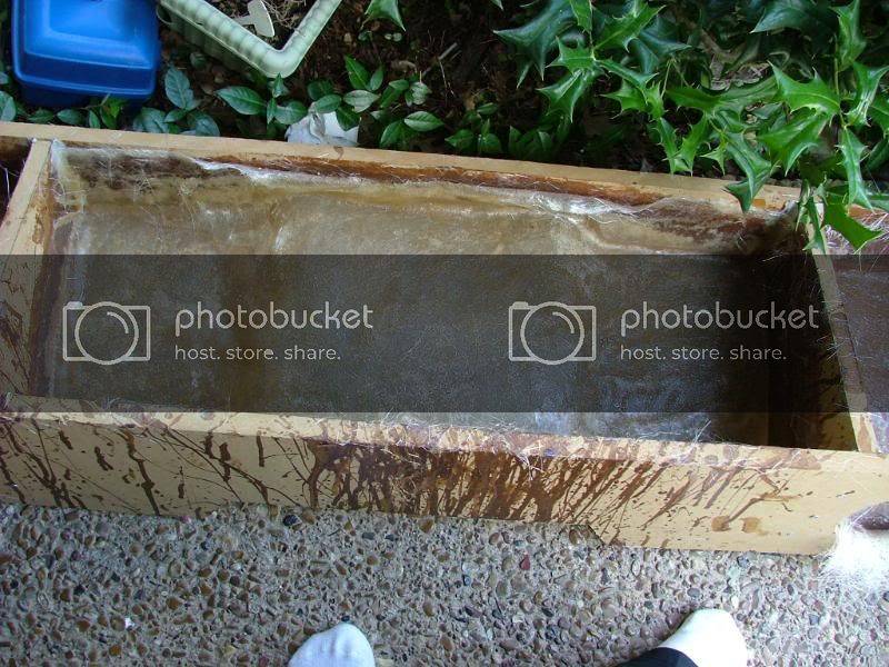

After my first time fiberglassing, well second. The first time I forgot to put the hardener in and I had to restart the whole **** proccess. //content.invisioncic.com/y282845/emoticons/rolleyes.gif.c1fef805e9d1464d377451cd5bc18bfb.gif

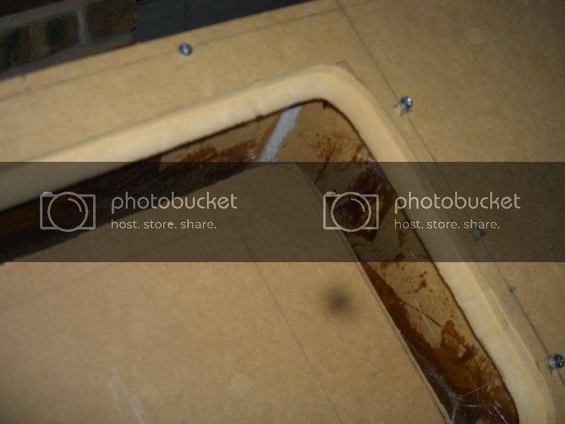

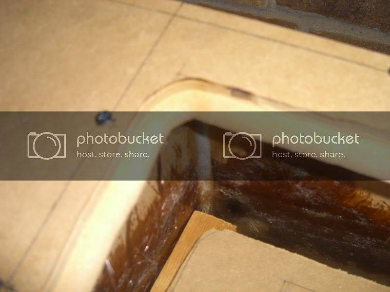

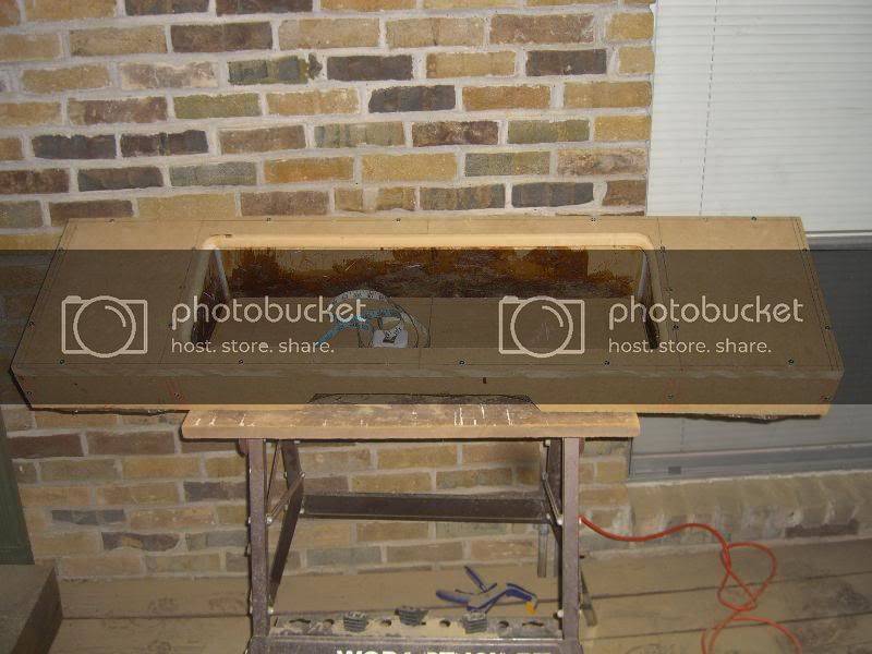

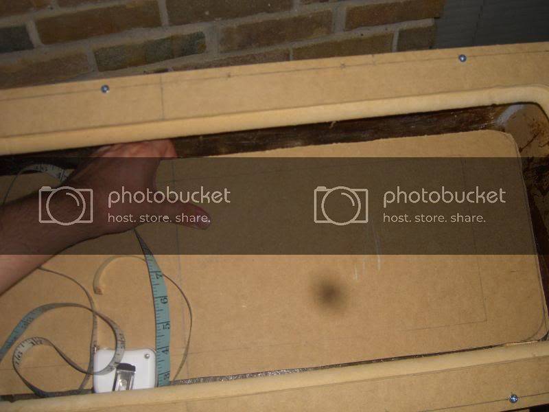

Starting the amp rack, without the amp here yet lol. I first took the top, measured the amp to about the center gave it 3/4" top and bottom and I think 2.5" left and right. Then I used a router to make an indent and a jigsaw on the inside to cut the middle out. Don't have any pictures of the process sense I really did a bad job on the cutting, only 2 or 3 of the cuts were really straight since it was my first time using the router. Thankfully when rounding the edges with the router I fixed much of my mistakes.
If you can see in the first pics theres a 1x2 in there, my dad had suggested I use it as support but I didnt want to created a hole into my sub compartment which for the time being is completely sealed so I just tryed to use the felt as the support... figured I could just lather it with resin.

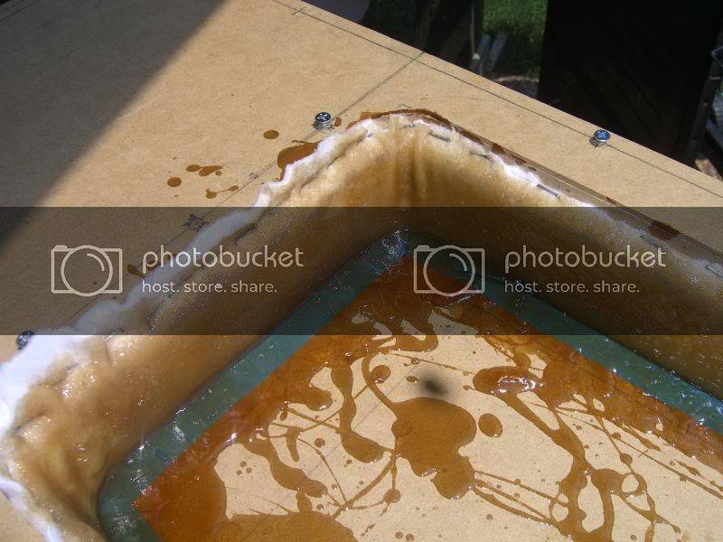

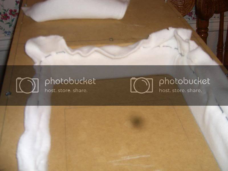

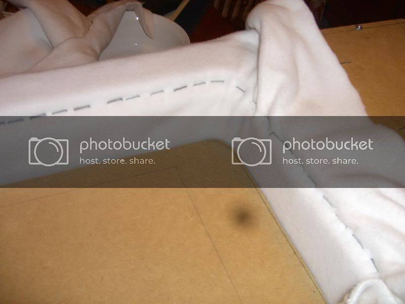

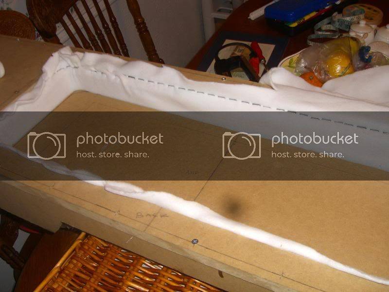

Next step was trimming the fleece and starting the fiber glassing... soo I thought I should tape up the edges of the wood in case I needed to take it out... Well first off that didnt work, second off there was no point to it... so the blue painters tape on the edges of the middle piece, those are indeed pointless.

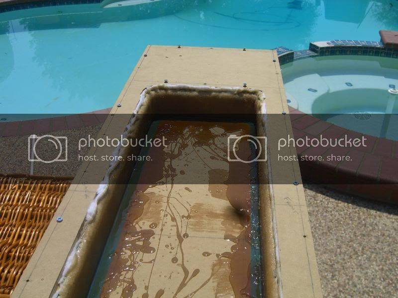

I have 2 layers on the inside of the fleece, I dunno how many ozs or anything just lathered it on. So thats where I am right now.
Im thinking tomorrow I will begin by taking the top off, I only put a few screws in to secure it, I will put a layer of resing on the outer sides and bottom just to strengthen it up, and possibly some mat as well. Im gonna see how it stands when the amp gets here tomorrow. If it seems like how it is after that glassing is too weak I will put mat on. But I figure since its pretty much sitting on the fiber glass thats dry underneath it and its not getting pulled on too much by gravity it would almost be ok as it is now.

The fleece should have been stretched after the middle board was in place. Or you just didn't pull tight enough.
I wouldn't have glassed the center portion, just the actual sub enclosures.

Well the fleece is pretty tight, the whole time I was applying the resin I was pushing down on it, just to make sure it was as tight as it got. Essentially I put it where there was 2" from the top of the middle board to the bottom of the top board, which is exactly the height of my amp. I just want to put more resin on it to make it stronger.
And if I could do it again I wouldn't glass the middle section either, I just wasn't positive what I was gonna do with it so I went ahead and did it anyways.
And thanks, the glassing wasn't all that hard its just time consuming. Now glassing kicks may be a whole different story...

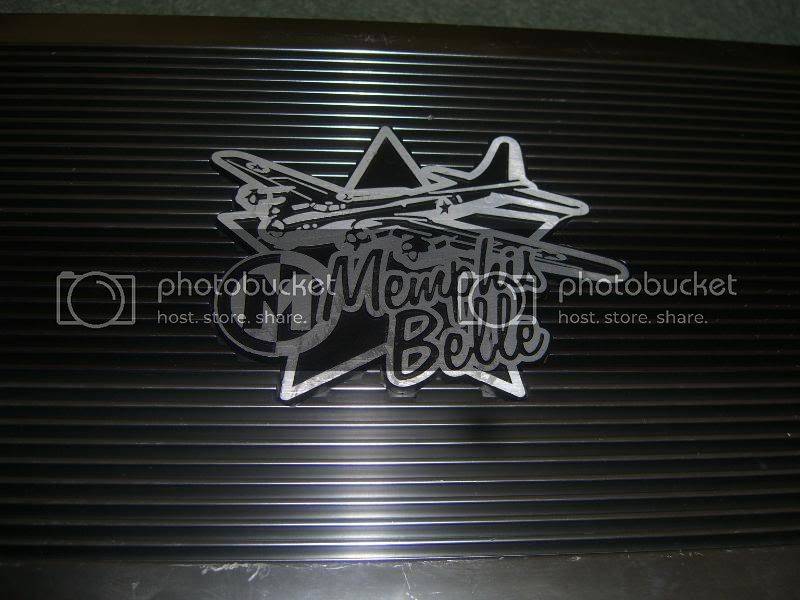

The ultra sexy Memphis Belle!

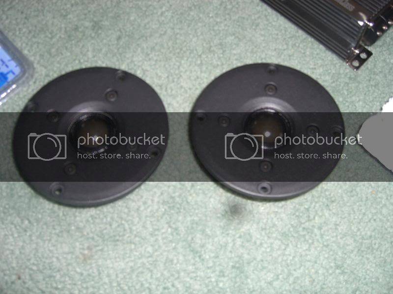

Peerless HDS Tweeters and...

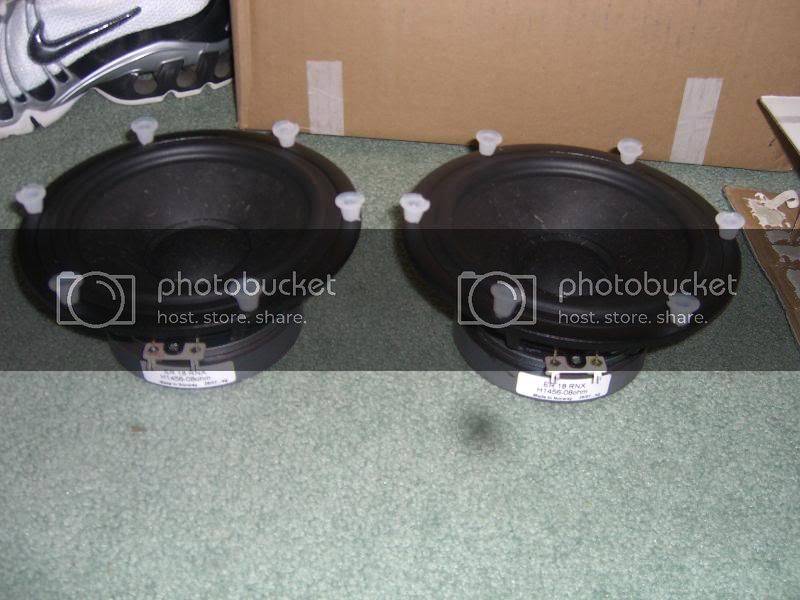

...Seas Prestige ER18RNX mids!!!!

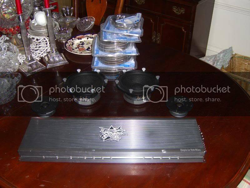

And a group shot of todays little christmas
