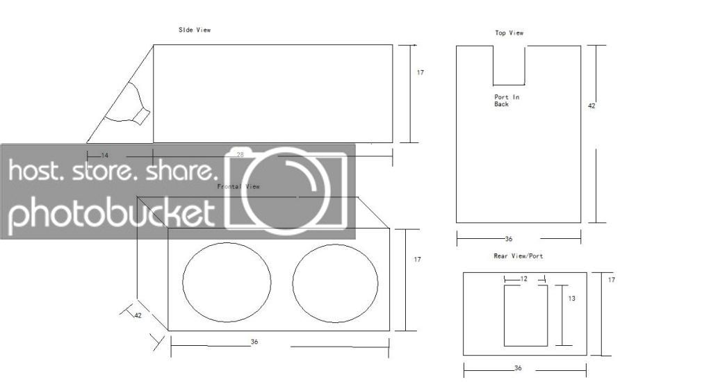

Hey these are my measurements and it comes out to about roughly 12-15 depending on how i do things.....how the **** would i go about tuning this beast hahahaha
O wow...I can barely get my box for my 12s in my grand am trunk...and the 2 cars are almost made the same...
Hope you plan on building the box in the trunk //content.invisioncic.com/y282845/emoticons/santa.gif.e1ec9cf2e0a0dd232ad35aa594a126d0.gif
Also yea...port in back = bad.
Think really the 2 best places to put it would be the top or front...I THINK the top...not too sure about that though
yeah are you sure that box is going to fix through the trunk hole? or are you gonna do an in-trunk build? and I didn't think you could fit 2 18's back there with proper airspace but then again I could be mistaken.
^ x2
edit: if you look its actually the true height so the angled piece would be a bit larger
ya i saw that but i couldnt tell for sure....well its only 36" long and the two subs are prolly about 38" side by side if you get what im saying...it needs to be like 40" long...or am i wrong again //content.invisioncic.com/y282845/emoticons/frown.gif.a3531fa0534503350665a1e957861287.gif
nah your not his drawing is a little messed up 36 they would be right on eachother i dont think its a good idea 2 18s in a trunk but not my car
well the subs arent going to be exactly 18 across...will prolly be 18.5--19.5" across so 36 wont work IMO but i could be wrong...
