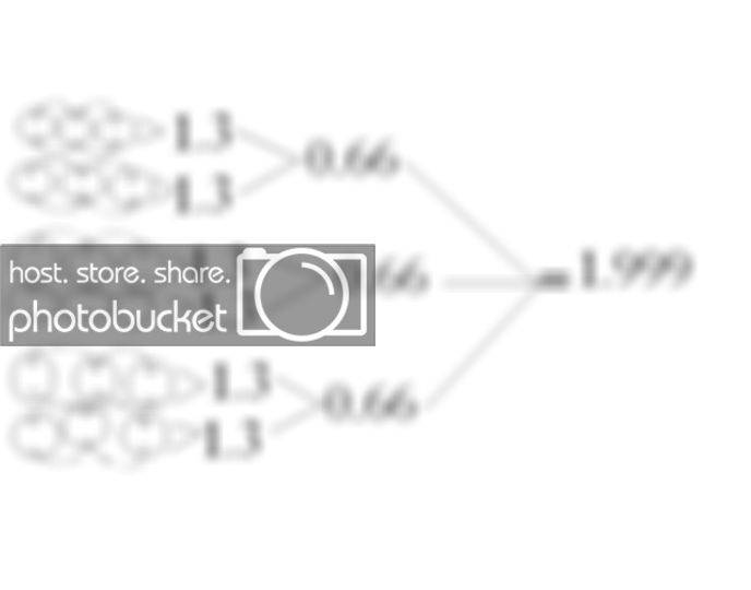

what load does this come out to, 1ohm+4ohm=? parralleled? trying to fig out how to wire up 18 10's at close to 2 ohms.
If you parallel a group @4ohms, with a group @1ohm... each group will be getting different amounts of power.
//content.invisioncic.com/y282845/emoticons/fyi.gif.9f1f679348da7204ce960cfc74bca8e0.gif
The total load would be 4/5ohm or .8ohms.
