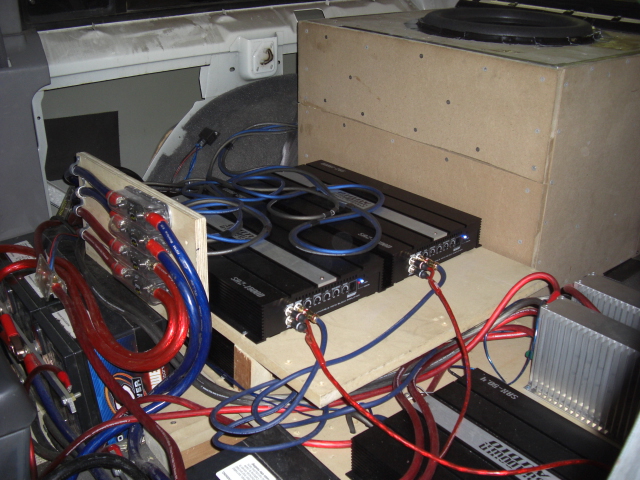

* Four SAZ-1500Ds installed

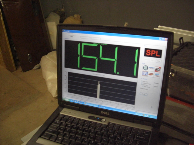

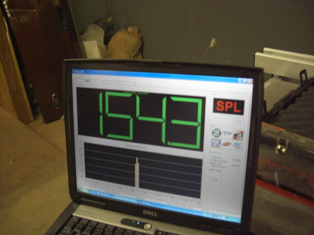

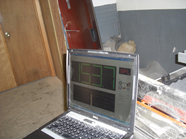

* First burp - HU Sub Control at +0
* Second burp - HU Sub Control at +3
* Third burp - HU Sub Control at +3 / One Hour Charge time on the batteries (lunch break)

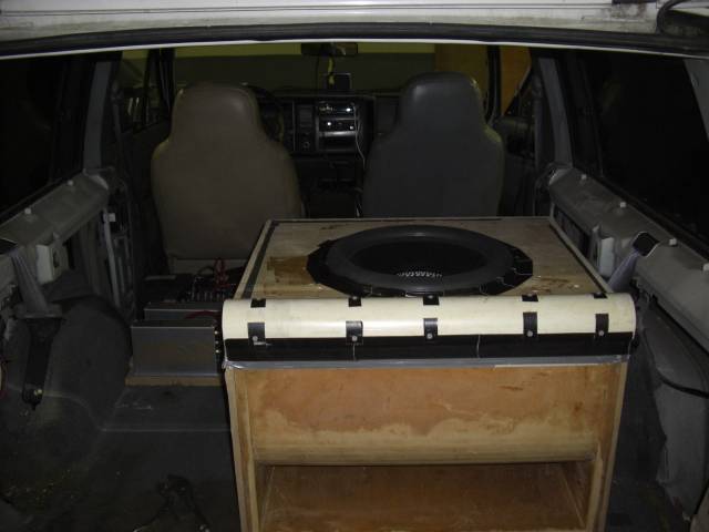

Pretty standard ported box - peak @ 53 Hz. My recent addition of Second Skin Damplifier raised my peak from 50 to 53 hz.
My previous best score with a single Nightshade was 153.0 dB with two 3000Ds (similar power to what I have now) but without the Dampener. On lower power I gained 0.9 total with the current amount of dampener and that seems to have risen to 1.3 dB with more power.

whats your impedance?
Dual-1
1/2 ohm per 1500D.
For two 3000s I had a Dual-2 and each amp at 1/2 ohm as well.
Rise in this box is low but not measured with this specific setup //content.invisioncic.com/y282845/emoticons/smile.gif.1ebc41e1811405b213edfc4622c41e27.gif

Nice,
Ya... I didnt care much for the box impedance rise I was just wonderin what each amp is seeing.
That is actually a lot of power
Thats a lot of wire. I really want one of those. lol. Maybe i can pick one up used one day.
The wire is a mess... it was neat for a little while until I changed the amp setup 10 times, haha. I will be re-building the rack again for four 3500Ds to power two subs so I will neaten it up again then.

3.5 cubes tuned in the high 40s with 96 in^2 of port area //content.invisioncic.com/y282845/emoticons/smile.gif.1ebc41e1811405b213edfc4622c41e27.gif
Indeed - quite a bit of power //content.invisioncic.com/y282845/emoticons/smile.gif.1ebc41e1811405b213edfc4622c41e27.gif
