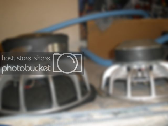

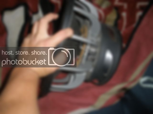

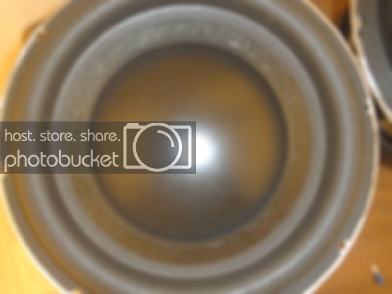

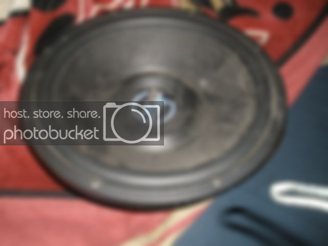

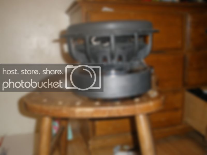

These were Crossfire xt2 drivers. They were nice as 15" drivers but Berny wanted some mean as 10s. I'm very happy with the way they turned out. The motor on these are pretty Massive. On to the pictures
As they started out

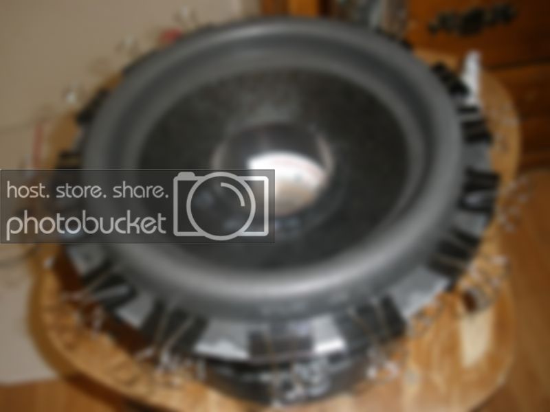

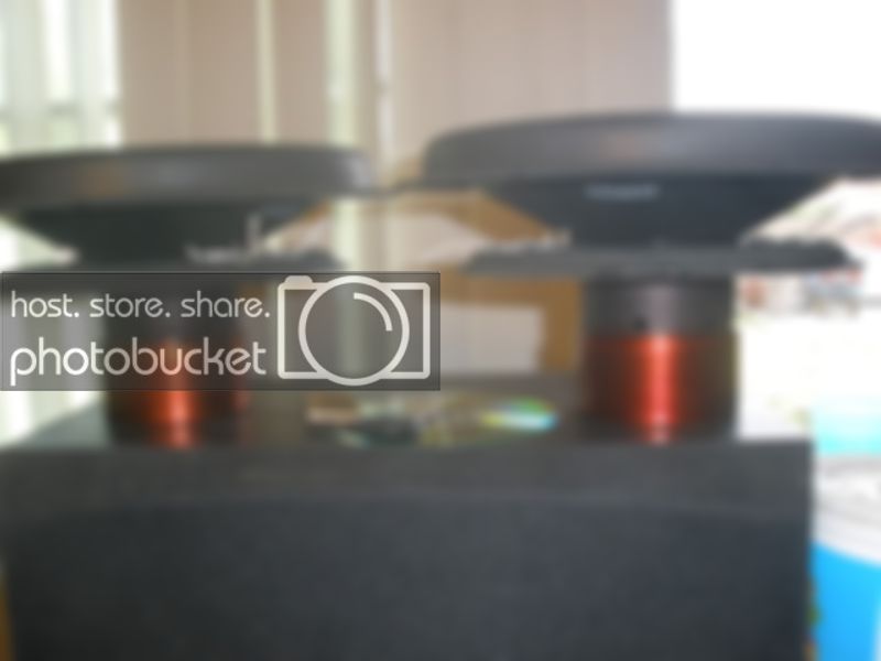

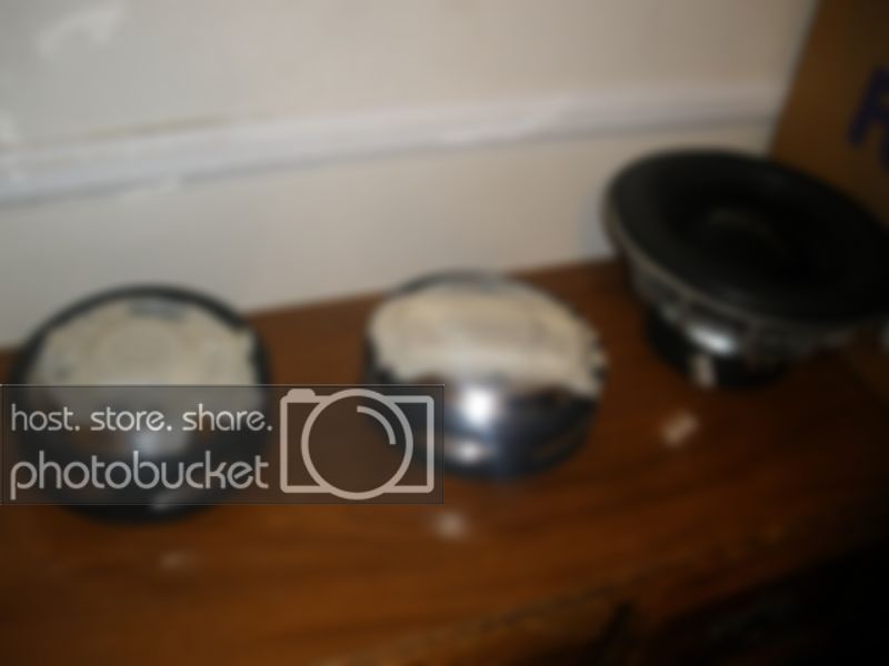

Motor comparison against the infamous Fi SSD

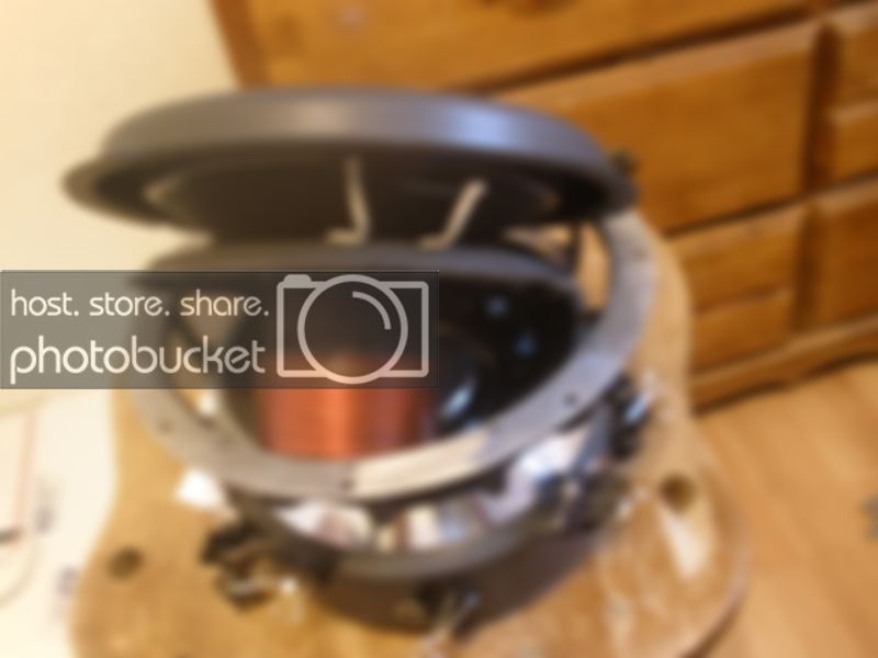

Bare motors

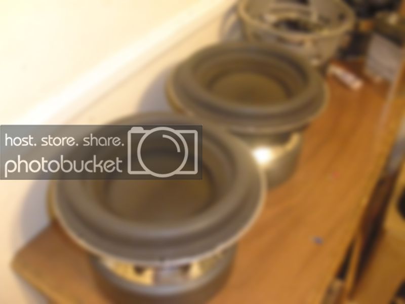

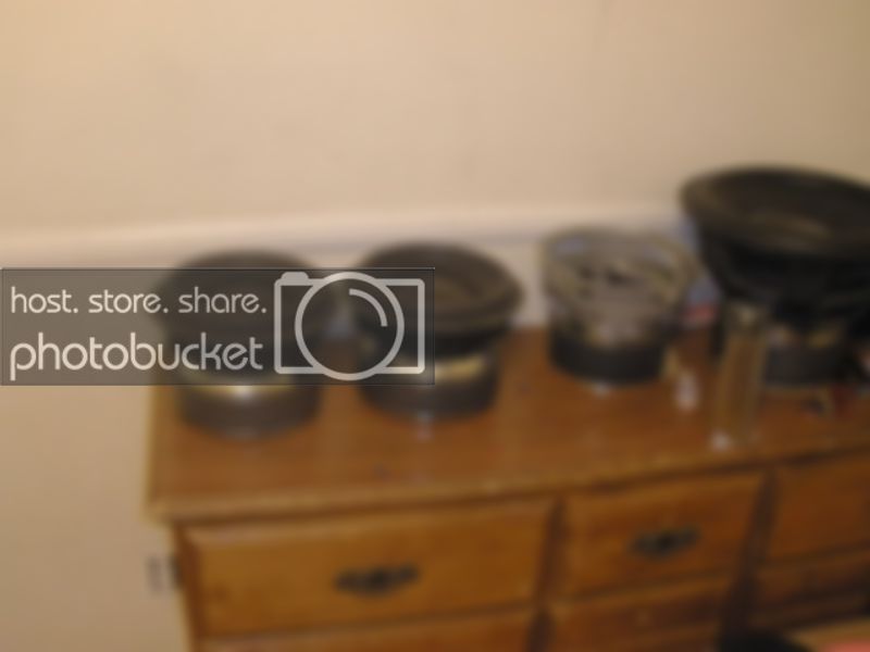

The parts

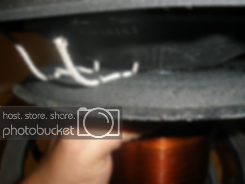

Stitched leads

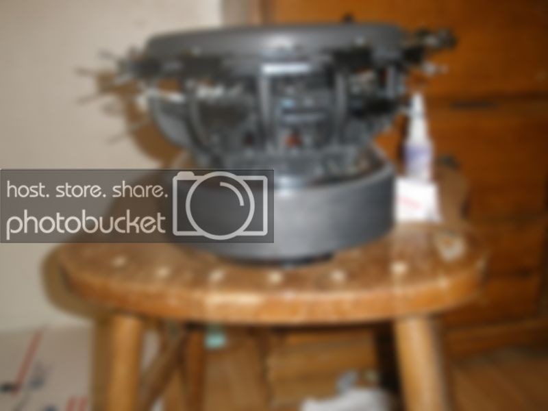

Looks great! Some beefy 10"s. Whered you get the soft parts from? Also is there a reason why you didn't put any weight on the cone while the glue for the spider was drying? I'm trying to research a ton before I do my first recone and was just curious since I've seen a couple threads where there was a sub sitting on the cone during that process.

very nice what size spiders did you use? and how many? is the coil flat wound aluminum ? looks beastly like the tall surroundings
8" spiders I believe stiff but to be honest it has been a while since these were done. Flat wound coil aluminum 8layer.
Soft parts are through a buddy, and I did not have to use any weight on the cone. Although the surround sat above the basket about a 1/4" so they had to be clamped down really good. They have a sub sitting on the cone to weigh down the dust cap as glue dries. I did that also but by the time I did it my camera was MIA lol
