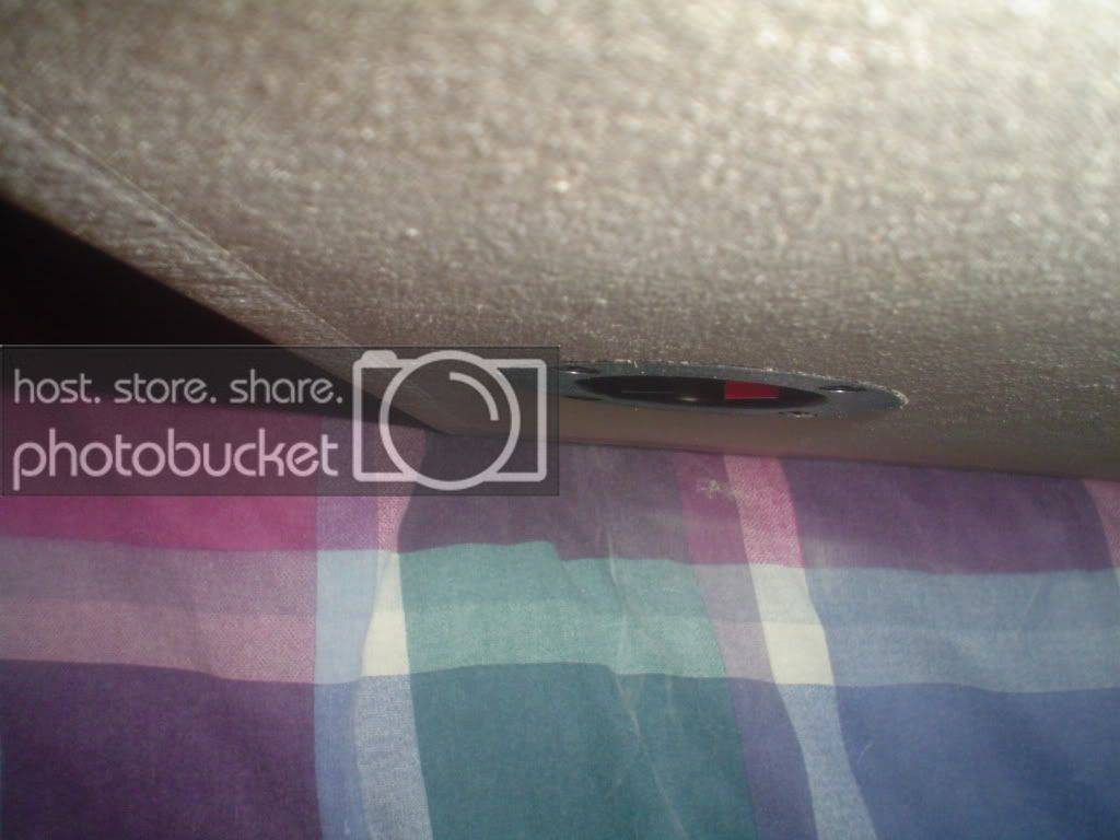

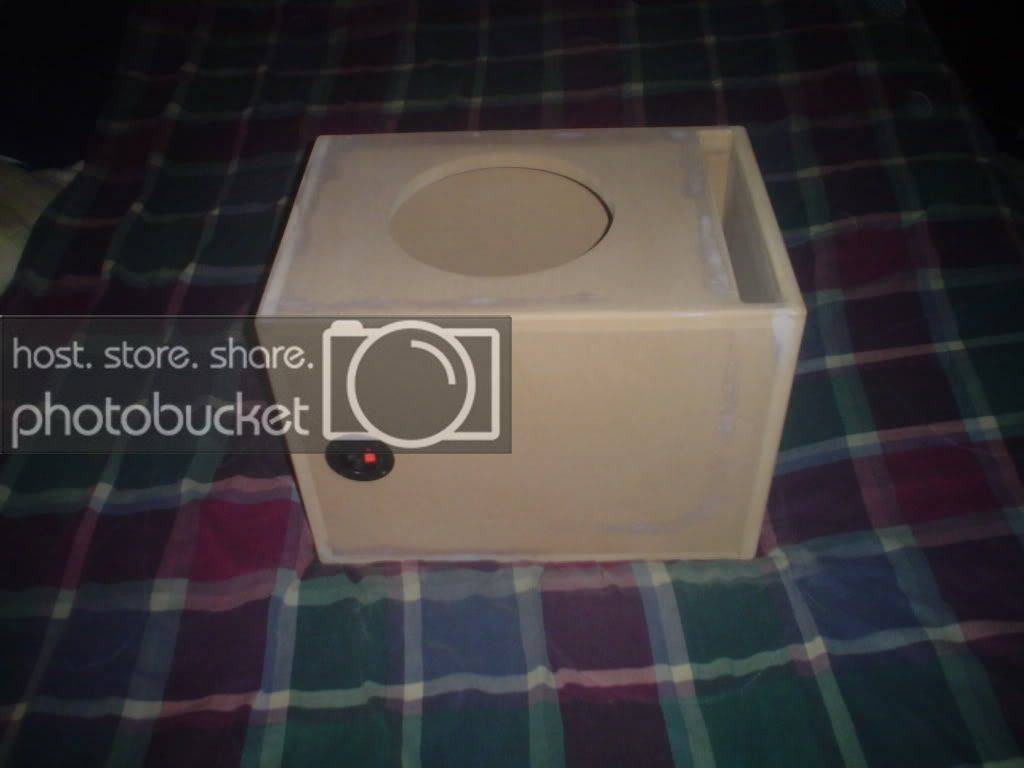

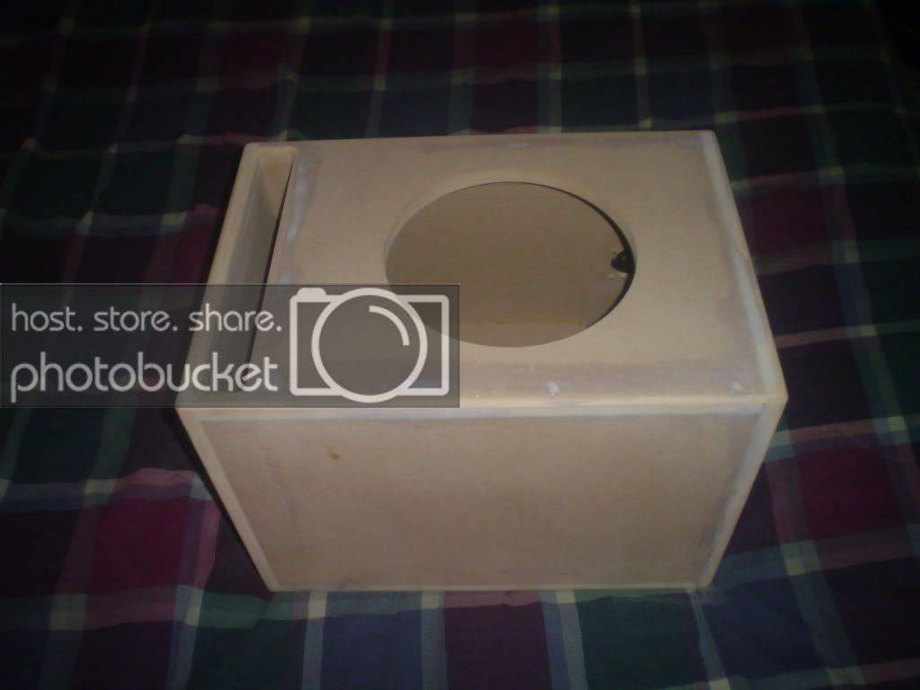

Not really a build but finished pics. If you are wondering what the different colored areas are....thats Bondo as the owner will be painting this box and i wanted to get the very visible panels very straight for him. Its a sub up, port up box hence the terminal cup location
20"w x 14''h x 14.5''d .......1.25^3@35htz
