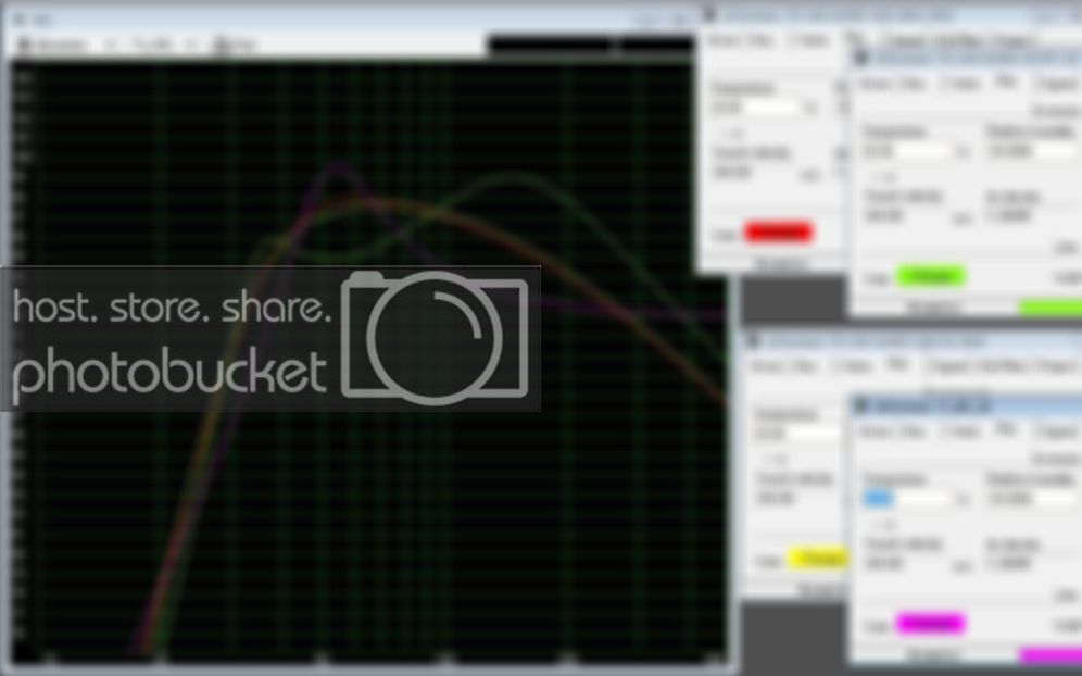

I modeled the BTL, Q, SSD, and IB3 for shits...doesnt have to be Fi.
SSD and Q look ok I guess, nothing I'd or any of us would want.
