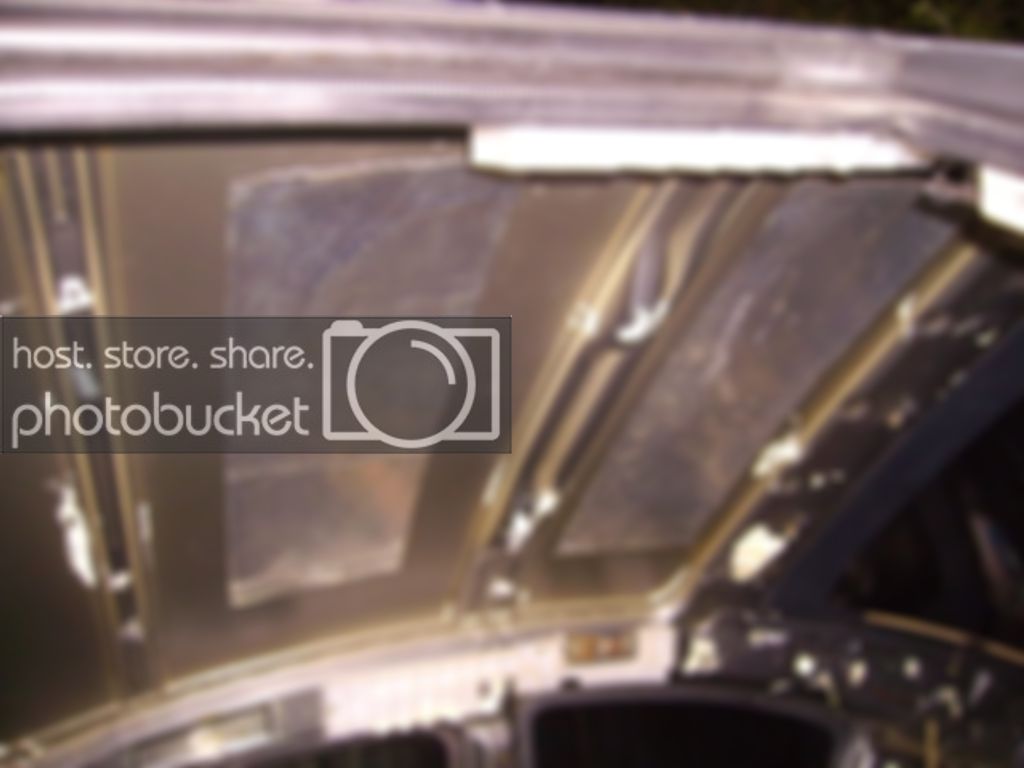

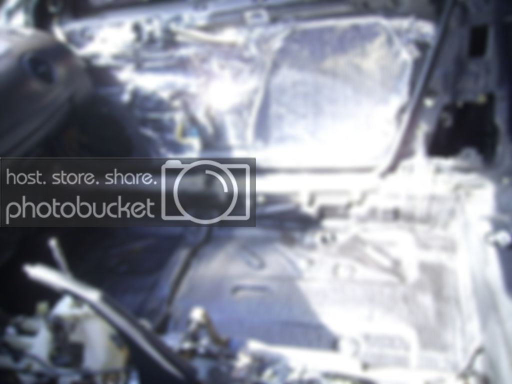

So far I have been through 20 cans of expanding foam still could use a couple more cans for the rockers, 2 gallons of eDead Liquid along with a roll of Raamat and a roll of eDead(junk). Then top'd that with 3/8" neoprene/gym mat.
I painted the entire car in eDead liquid multiple coats. I have 3 coats everywhere and 5 on the trunk/roof/decklid

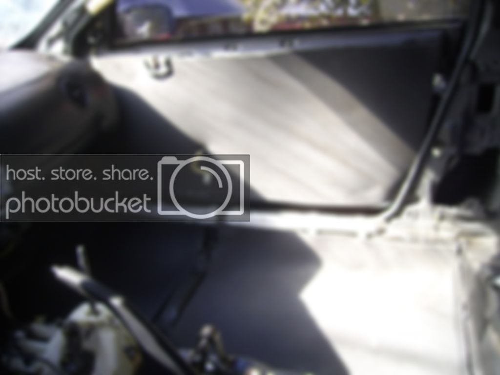

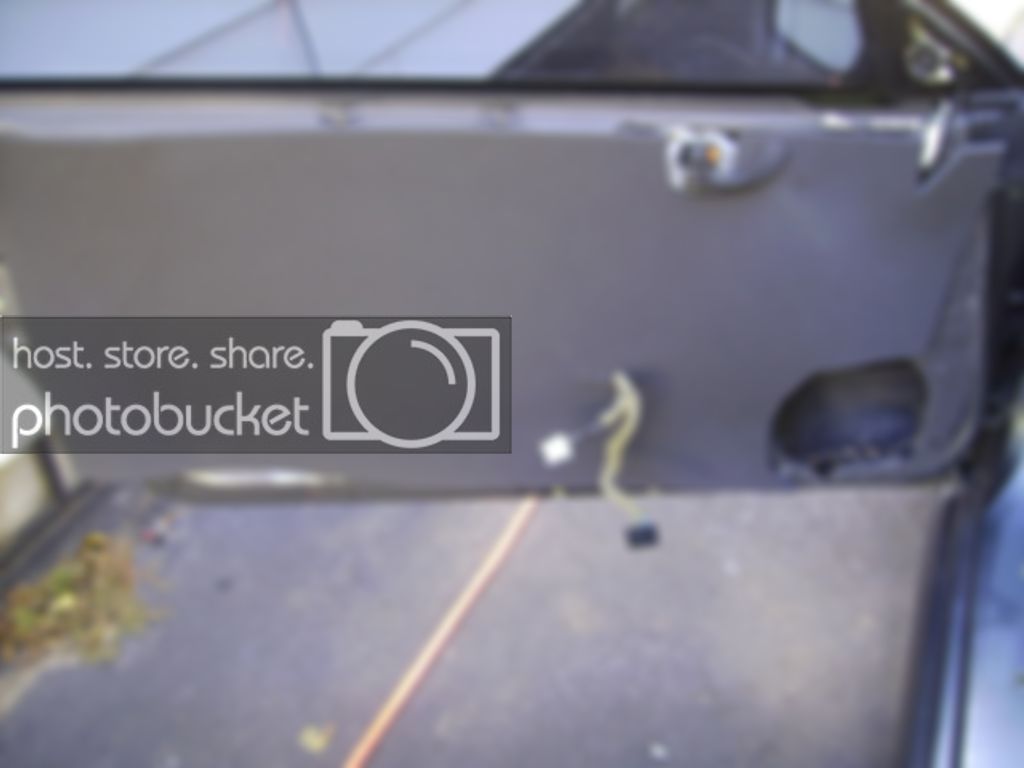

On the doors I used some layers of vinyl flooring then fiberglassed them with a couple layers of mat and sammich'd them together, then 2 layers of Raamat over it. Then I velcro'd 3/8" neoprene sheet to it.

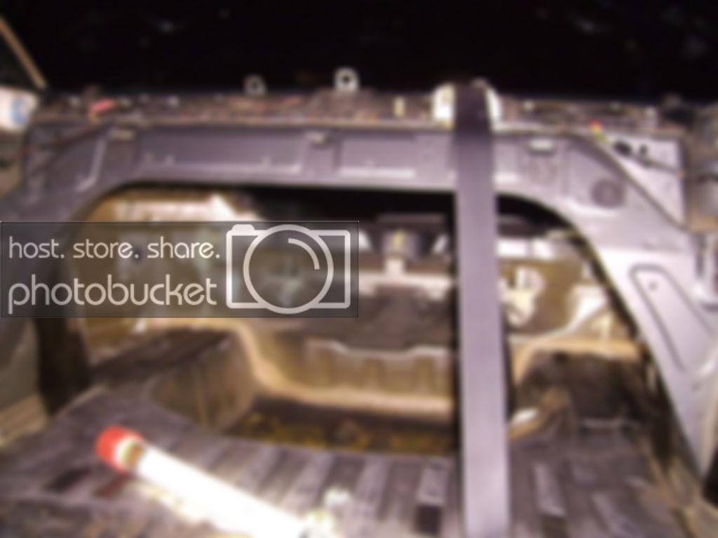

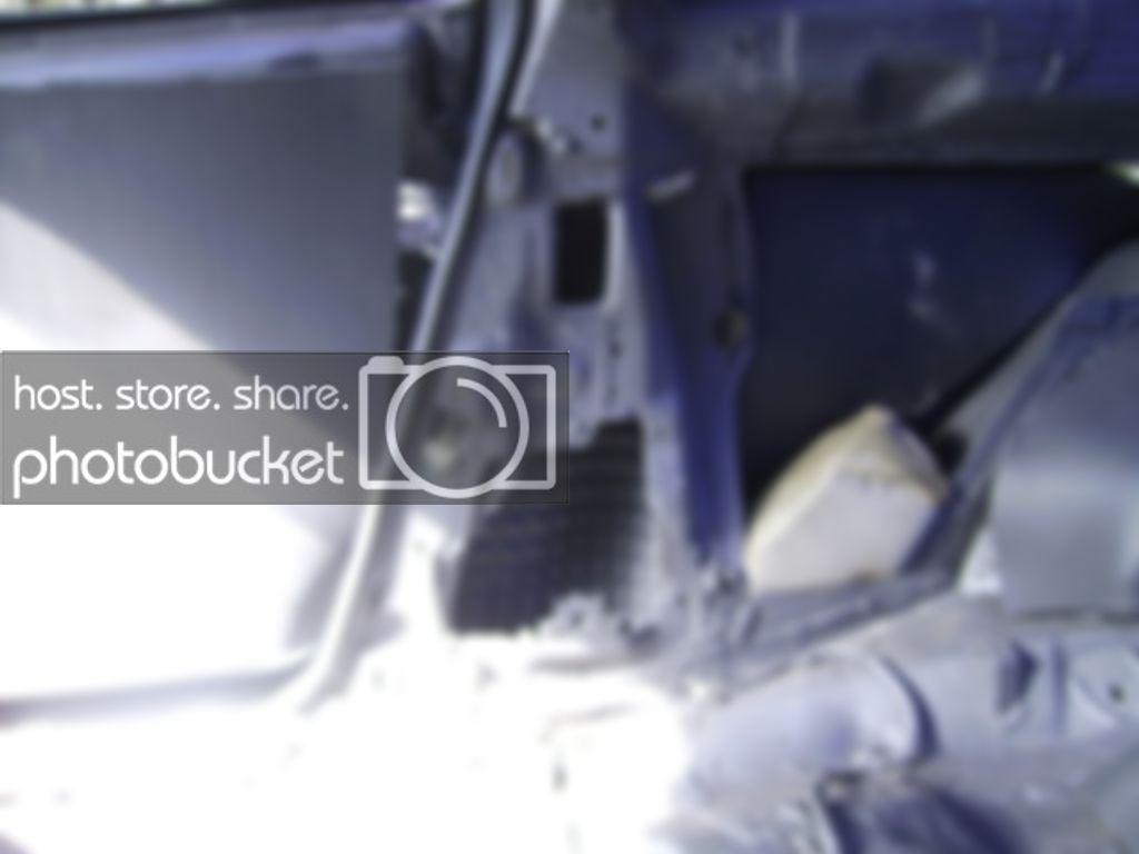

I fiberglassed the spare tire well also, added a couple layers of mat and mostly covered in neoprene. I did the main areas like tire wells and floor/quarters

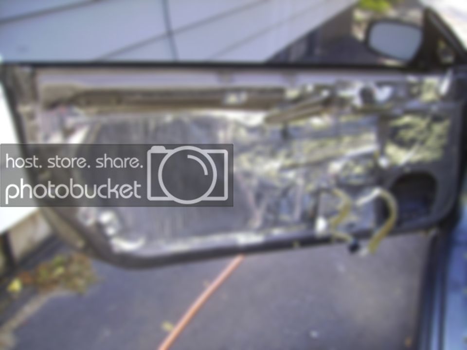

Stock deadening in this pic
Dont mind the gap in neoprene in this pic, as there is another piece that overlaps

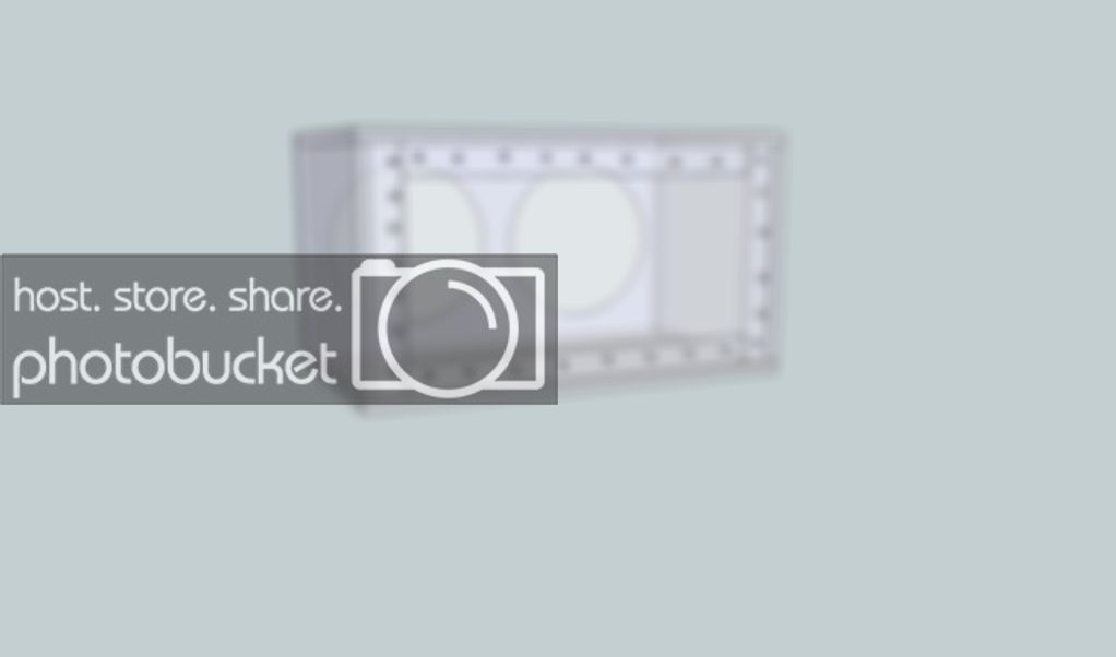

Heres what 1/2 of the box would look like or similar if I end up with 2x 12's

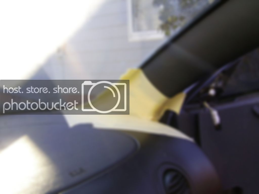

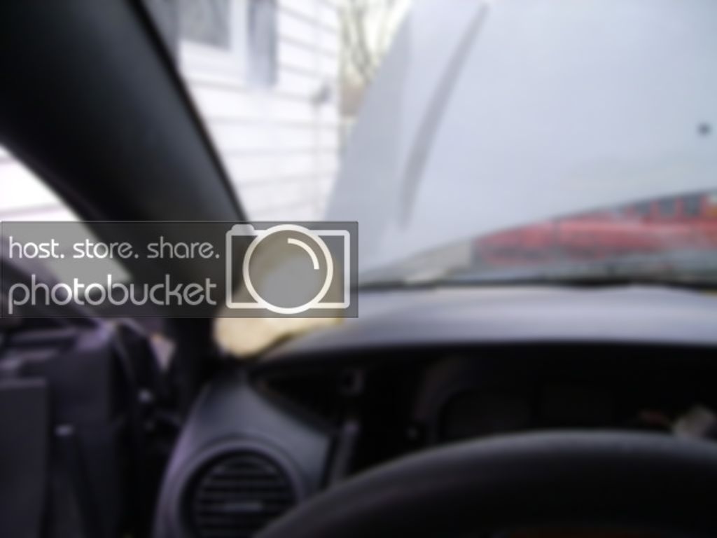

The x-overs for the mids will likely go under the seat. I'm not sure on the placement of the mid/tweet combo pod. Plan on testing out a couple scenarios like: Combo pod on A pilar, Combo pod on door, tweet in sail/mid on A pilar, tweet in sail/mid in door to see what sounds best

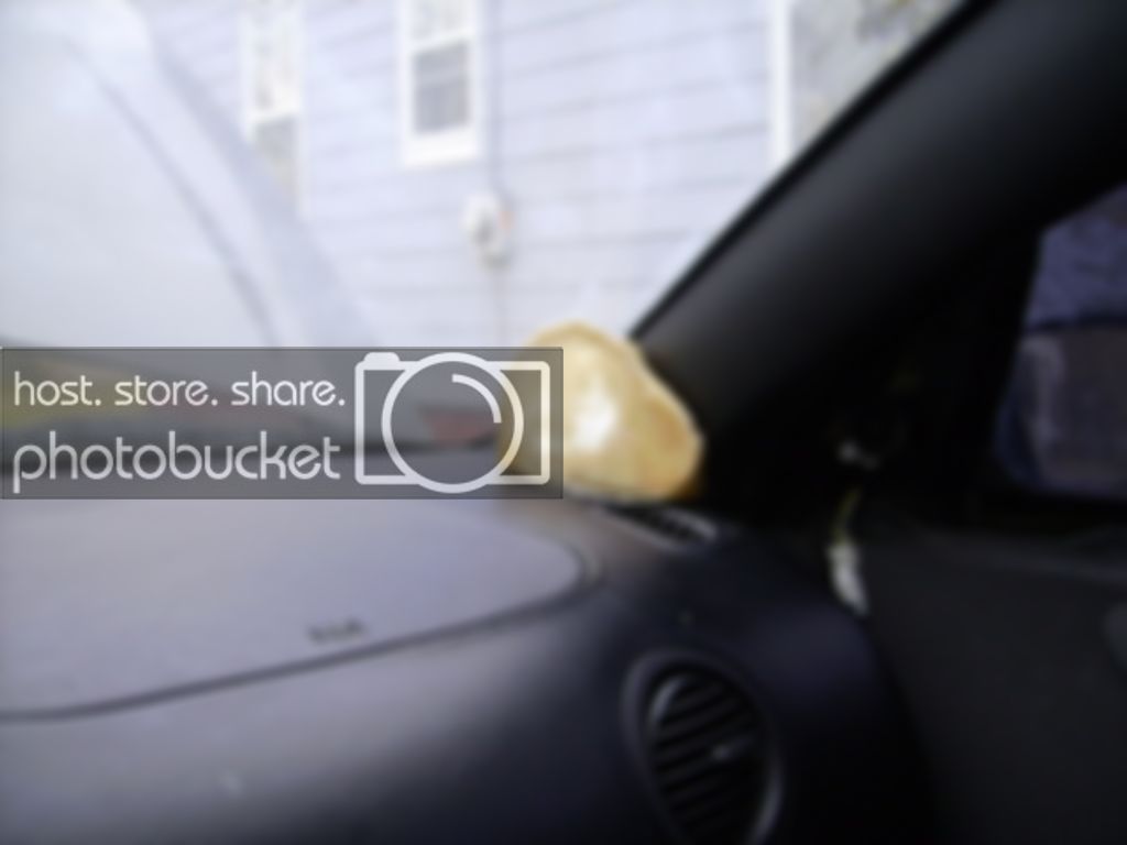

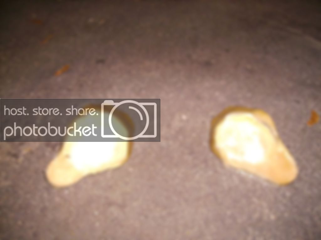

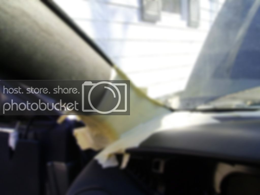

1st time making fiberglass enclosures, came out OK as they are just pods to mount the mid/tweet on the dash and not look too silly. Obviously they are not finishied yet, have to sand/bondo/sand/paint.
