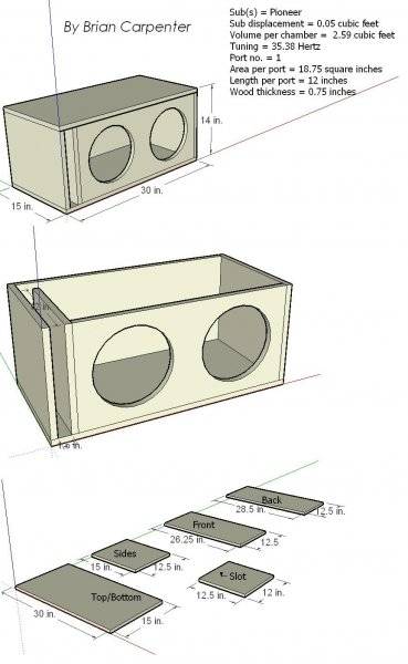

foomasta69 Apr 4, 2005 Re: my plans i dunno how much of a good idea that is to have both subs hitting on eachother..(no wood to seperate the two subwoofers)
denim Apr 11, 2005 Re: my plans the only difference there would be is time alignment, and to most ears, you are not going to hear the difference

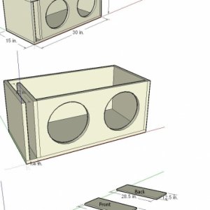

bcarpenterfhl Jul 7, 2005 Re: my plans soundjunkie said: if you want seprate chambers mesure and cut one Click to expand... not exactly that simple. you have to resize the port, and make an entire one again.
