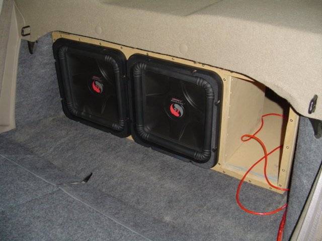

2 12" Kicker S12L5s, powered by Soundstream Picasso 880.2, ~1000 RMS. Upside down because I just recently flipped the box around and wanted the port on the right side, and haven't flipped them back yet. 6 cu. ft. tuned to 46.25 for SQL. 142.8 certified on new AudioControl, 145-146 on Termlab.
DSC00140
Thanks, I made the port as big as I possibly could, would have liked to go a little bigger, but no room to do so. The box is as big as it can fit through the passenger rear door and fit in the trunk through the back seats.
DSC00140
Sweet but have you thought about interior vibration? I had huge problem until I put in padding
DSC00140
Yep. Everything rattles. Maybe some sound deadening to come in the near future.
DSC00140
Sounds really good to my ear, nice and low but punchy and tight at the same time.
Re: DSC00140
have you thought about fiberglassing them in if not you need to you can get some sweet designs that way
