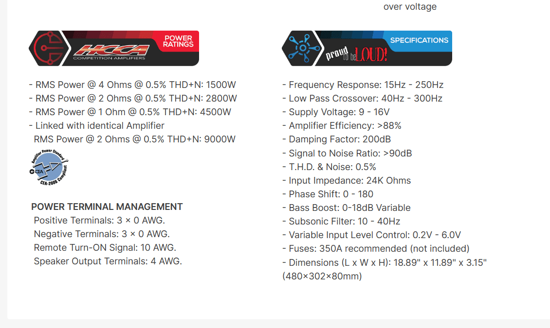

The Orion HCCA 3000.1DSPLX requires three 300A fuses. Does this mean I need wiring that can sustain 900A of current? (or does this mean I need three 100A fuses?) I have never worked with amps that have more than one power input. I also have to decide on what amp(s) I will be using for my mids/highs. I figure they will not use more than 150A of fusing between them.
So this leads me to my concern. Can I get away with NOT using 4/0 wire? Will 2/0 be sufficient for a single ~17' run to the back?

Wow, just read where the remote turn on needs a 10 gauge lead for the remote. Might Want to find out what the remote turn on requirements are, I could not find that info on the Orion page. I'd give them a call to see if the short lead from your RF DSP unit is going to supply enough turn on current. I don't believe that 10 gauge is unscary for a a 3 or 4 foot run, but best to find out. 16 gauge should more than adequate. If they say no, then you'll want to install a remote turn on relay, something like this Bosch:

Remote turn on is just a simple on/off switch, and usually only around a few hundred millivolts. That would be a 20 amp switch.

Remote wire can be tiny as it doesn't carry much current. If you use a relay you need a diode on the remote trigger to keep back feed from potentially frying the radios remote out. I don't really think it matters much for radios of this day in age but it's still recommended
