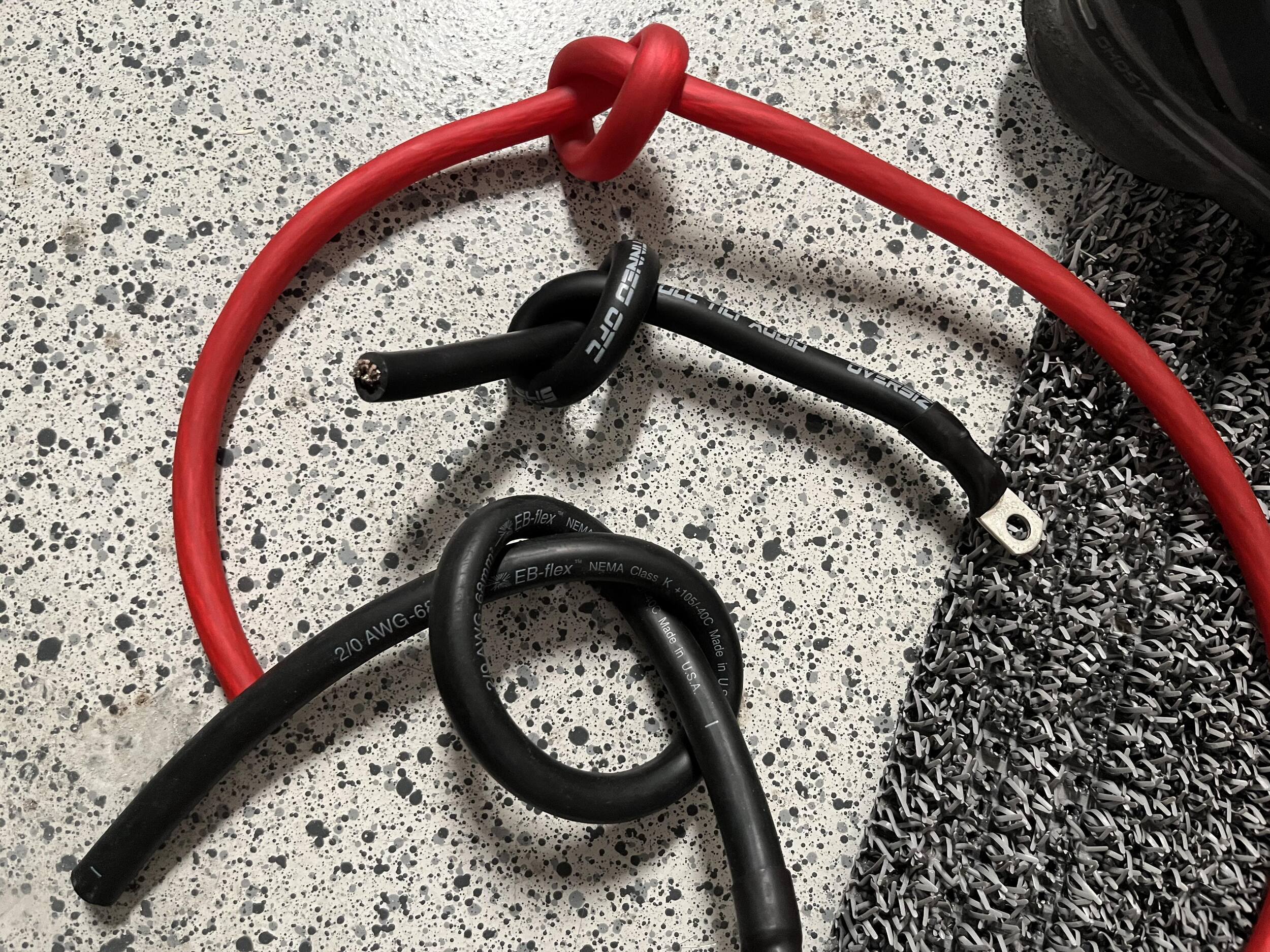

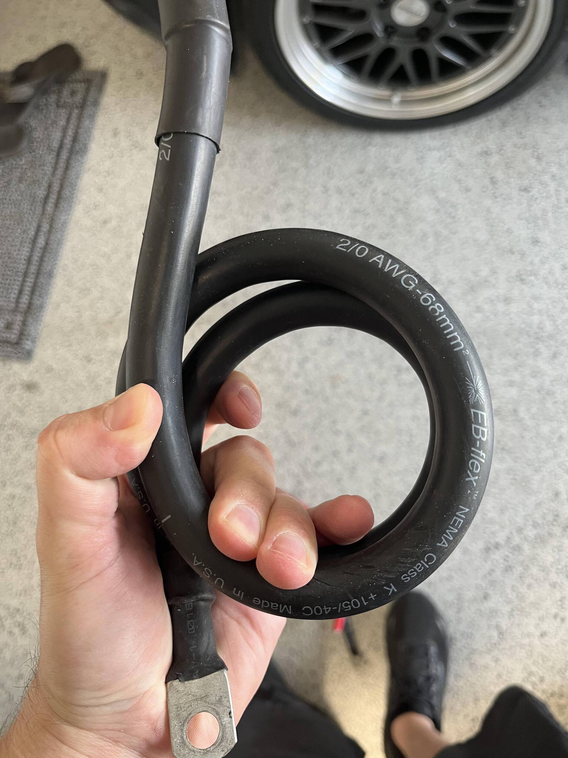

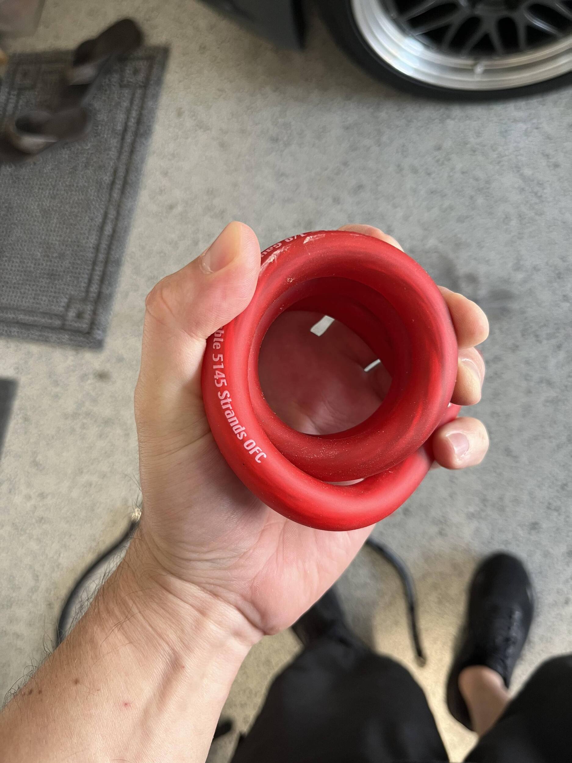

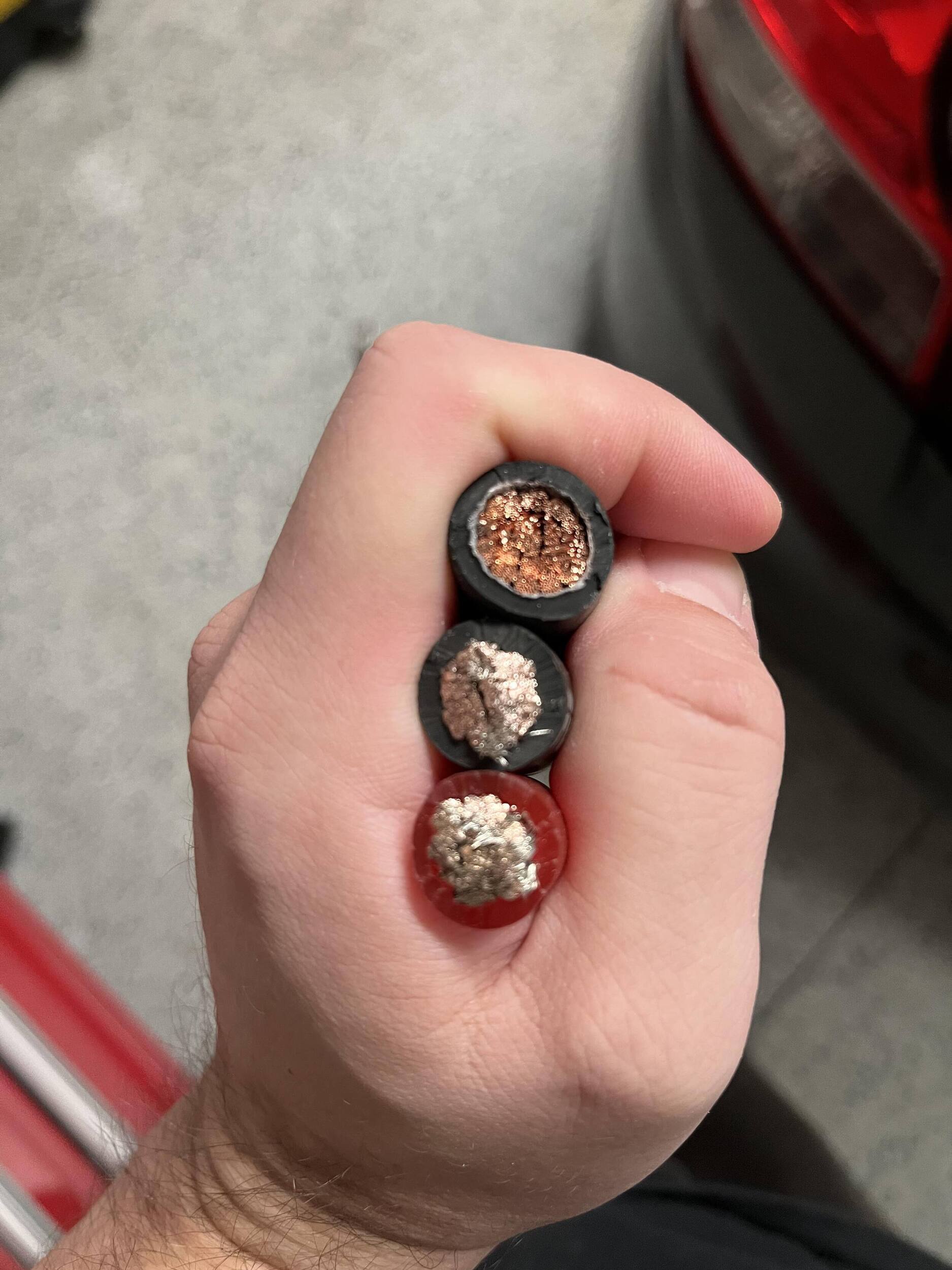

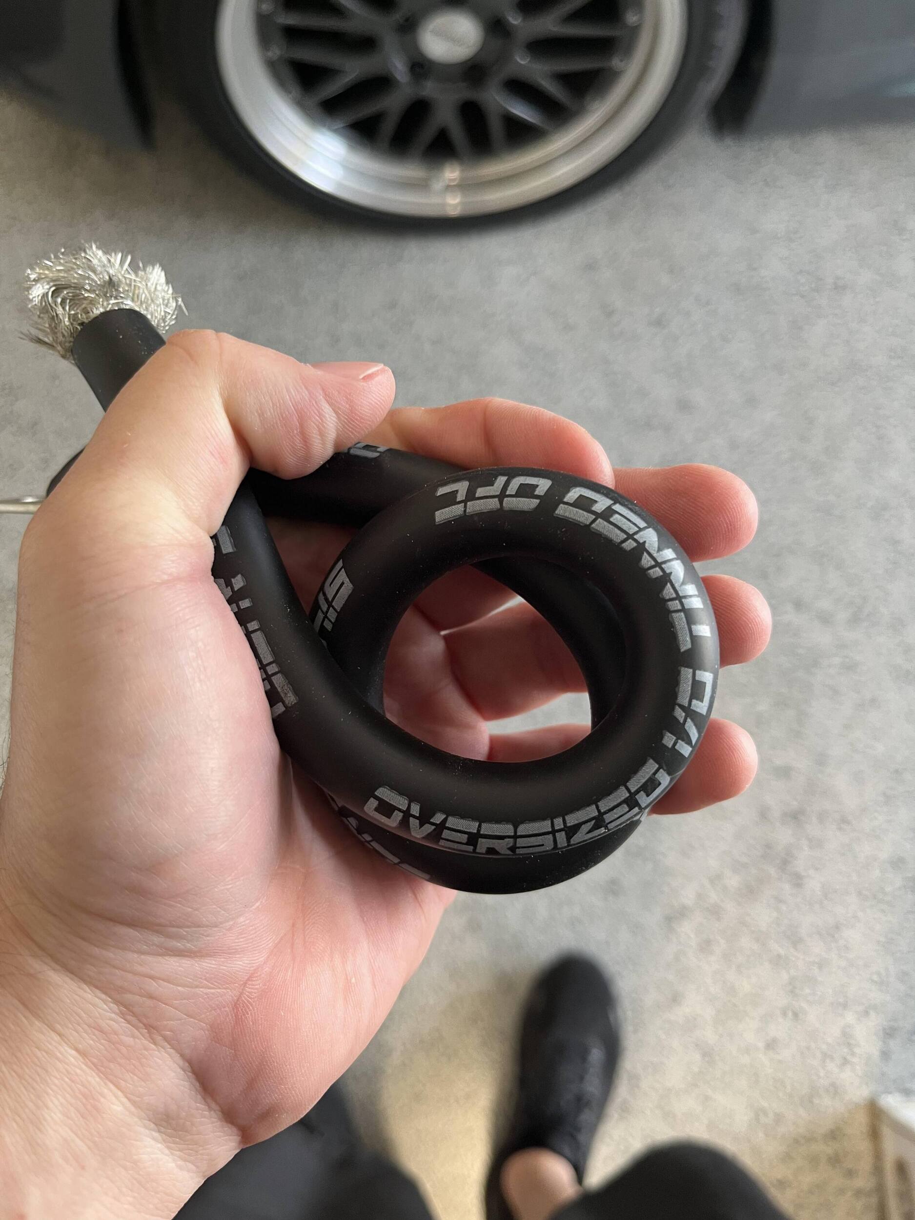

I can see the big difference in wire. The welding cable doesn't flex as easy but I can deal with that. The ACDC wire on ebay is also .083" larger diameter conductor and is the same price. But I really like the other wire being more flexible.
Anyway, why in the world do they state 1/0 but it is actually 2/0? Is this a marketing tactic?
Diameter is almost irrelevant - going from 1/0 to 2/0 only nets you about a 10% increase in diameter, it's the amperage rating that matters. The rated amperage at a given distance for the wire is what you want to look at. I use the stiffer welding OFC for the long runs as the cost difference is substantial, the more flexible KnuKonceptz for the amp plate after the distribution blocks. Aesthetics and ease of use for the inside after the blocks.

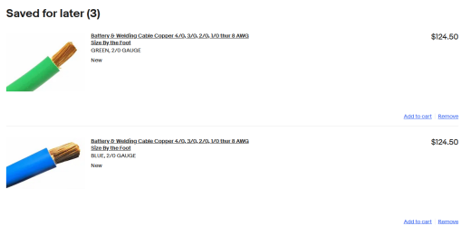

So I have officially decided on my main wire. It's on ebay from acdcwire. I have chosen blue for positive and green for ground. Won't see much of it but looks cool nonetheless. I have taken advice from ...I think @Doxquzme to use some Knuconceptz after the rear battery to alleviate flexibility issues.
