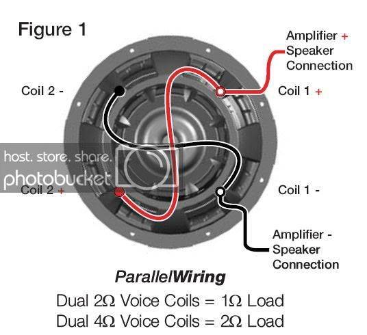

Thx for the reply man //content.invisioncic.com/y282845/emoticons/smile.gif.1ebc41e1811405b213edfc4622c41e27.gif . I didn't put the gain all the way, the amp has 18db of bass. I set it at 3 or 5 max, because more than 5 might burn the fuses again. All the eq's of the amp arent set to the max, they are set less than mid. Also, both subwoofers are connected just like they appear in the manual. U have the manual right? In the manual there are 2 pics, one to connect them in parallel and one to connect them in series. Mine are connected in parallel. just like in here:

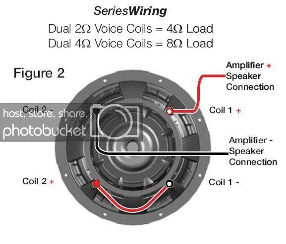

Since both coils are 4 ohm, If I connect them in parallel it will decrease impedance by half, different than connecting in series, It will double the impedance to 8 ohm and might cause damage to the amp.
and there is the other diagram, in series:

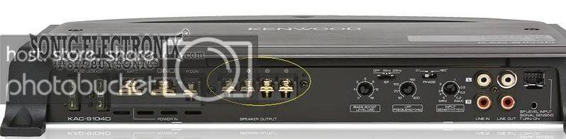

Many mono amplifiers have 4 speaker output terminals (two positives and two negatives). Lets compare a stereo amplifier capable of driving a 2 ohm load on each channel to a mono amplifier capable of driving a 2 ohm load. Let's say that we have four 4 ohm speakers. If we want to run all 4 speakers on the stereo amplifier, we would simply connect 2 speakers to each channel. Now, when we look at the mono amplifier amp with 4 speaker terminals (the same number as the stereo amplifier), you might think that you can connect 2 speakers to each pair of speaker terminals. The problem is... the speaker terminals inside the amp are connected together in a parallel configuration (2 positives together 2 negatives together). So, if we connect 2 speakers to each pair of speaker terminals on the amplifier, we actually have a 1 ohm load. You can check to see if the terminals are in parallel with an ohm meter."
That's the part I'm lost atm, how do I have to connect the wires to the amp?? Can someone help me on doing some kind of diagram?
I need to know the connection that I have to do from the speakers to the amp here:
...peace...
