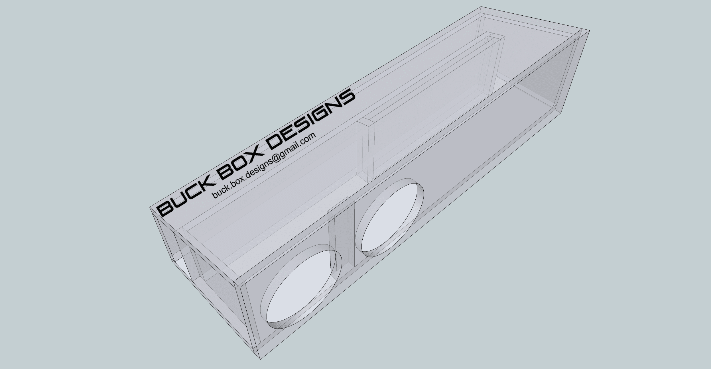

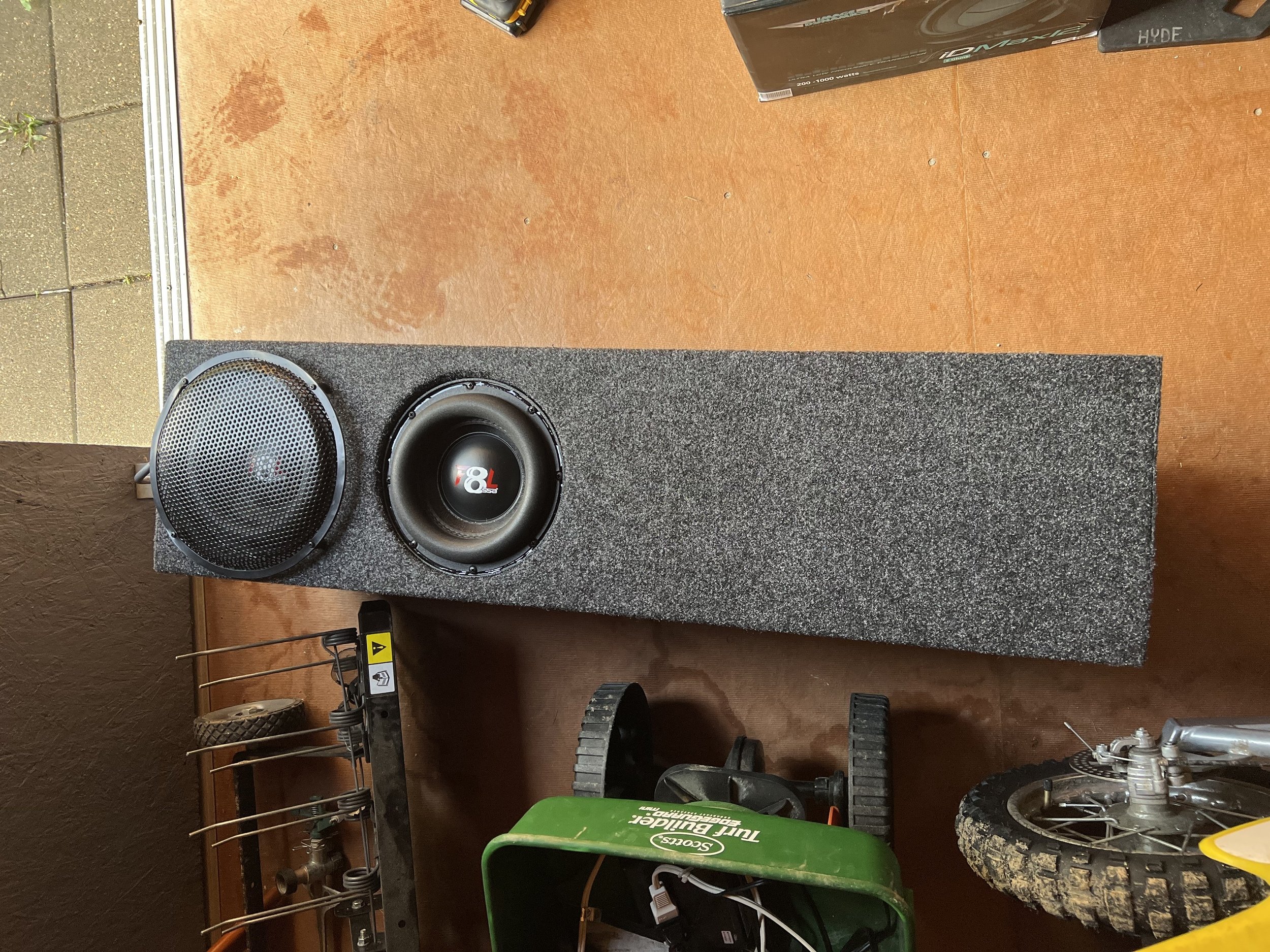

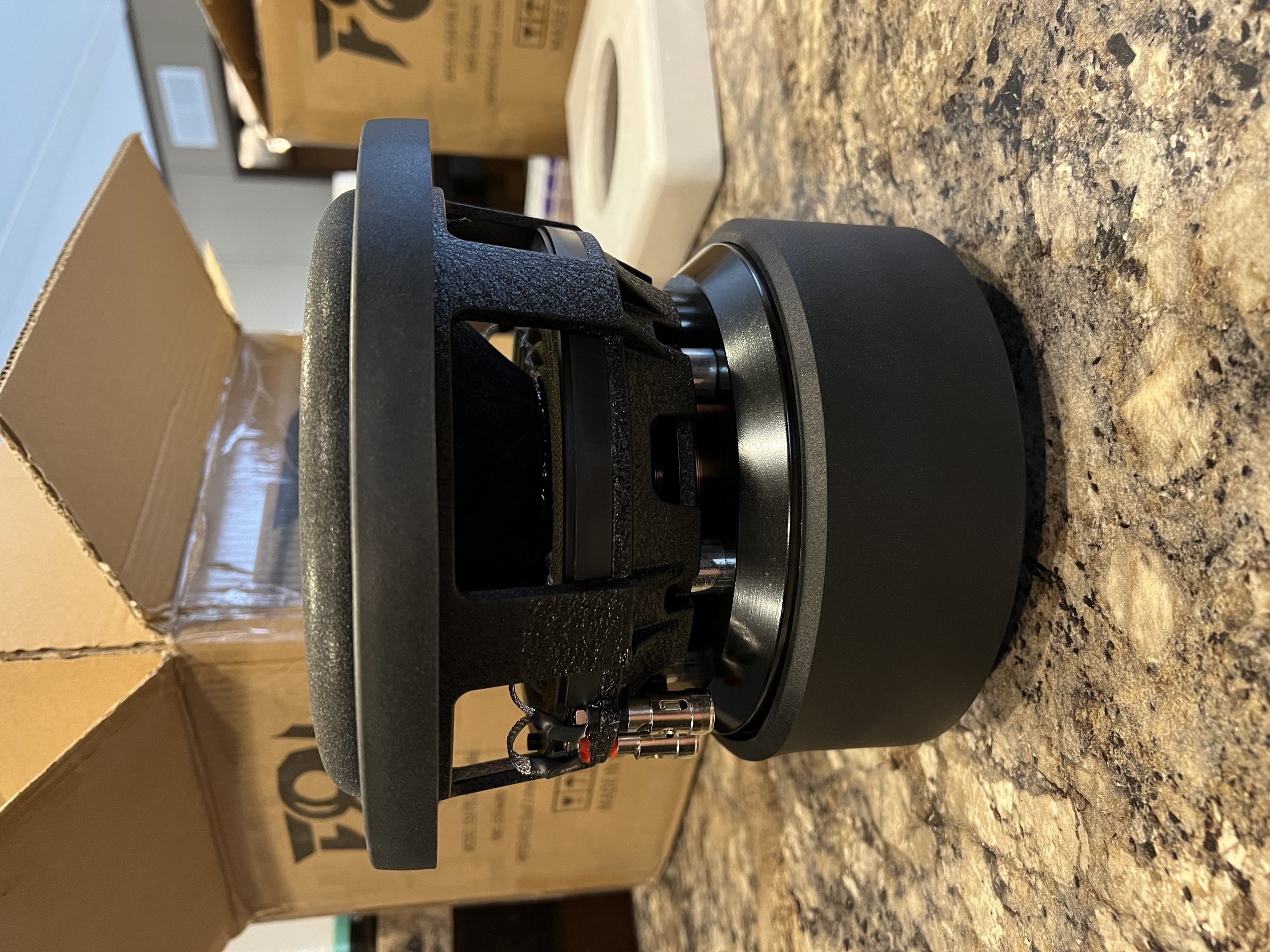

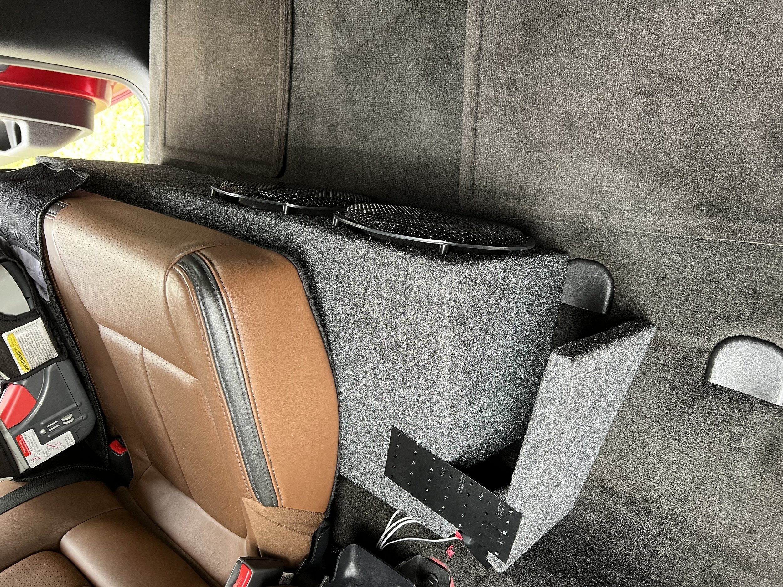

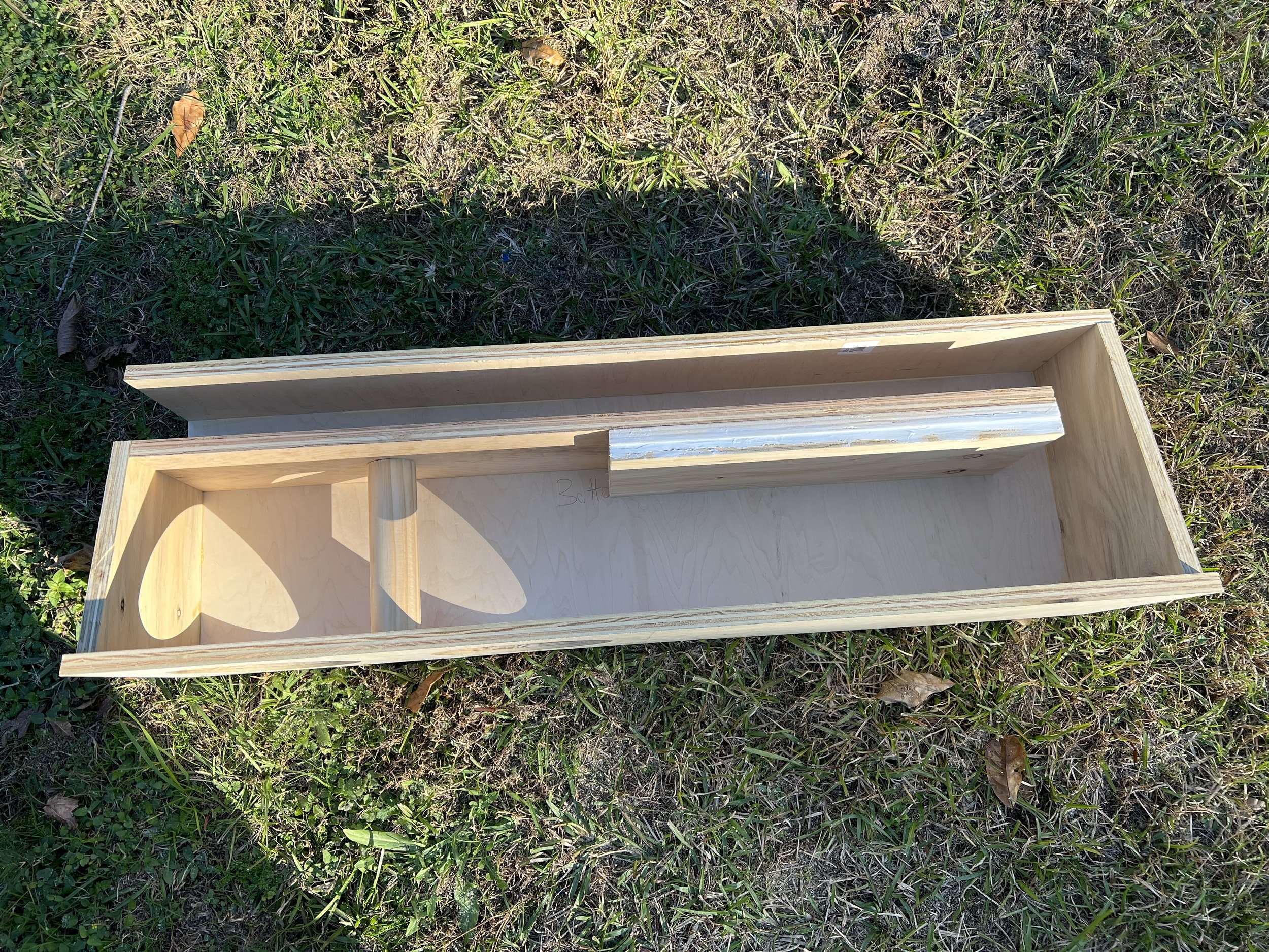

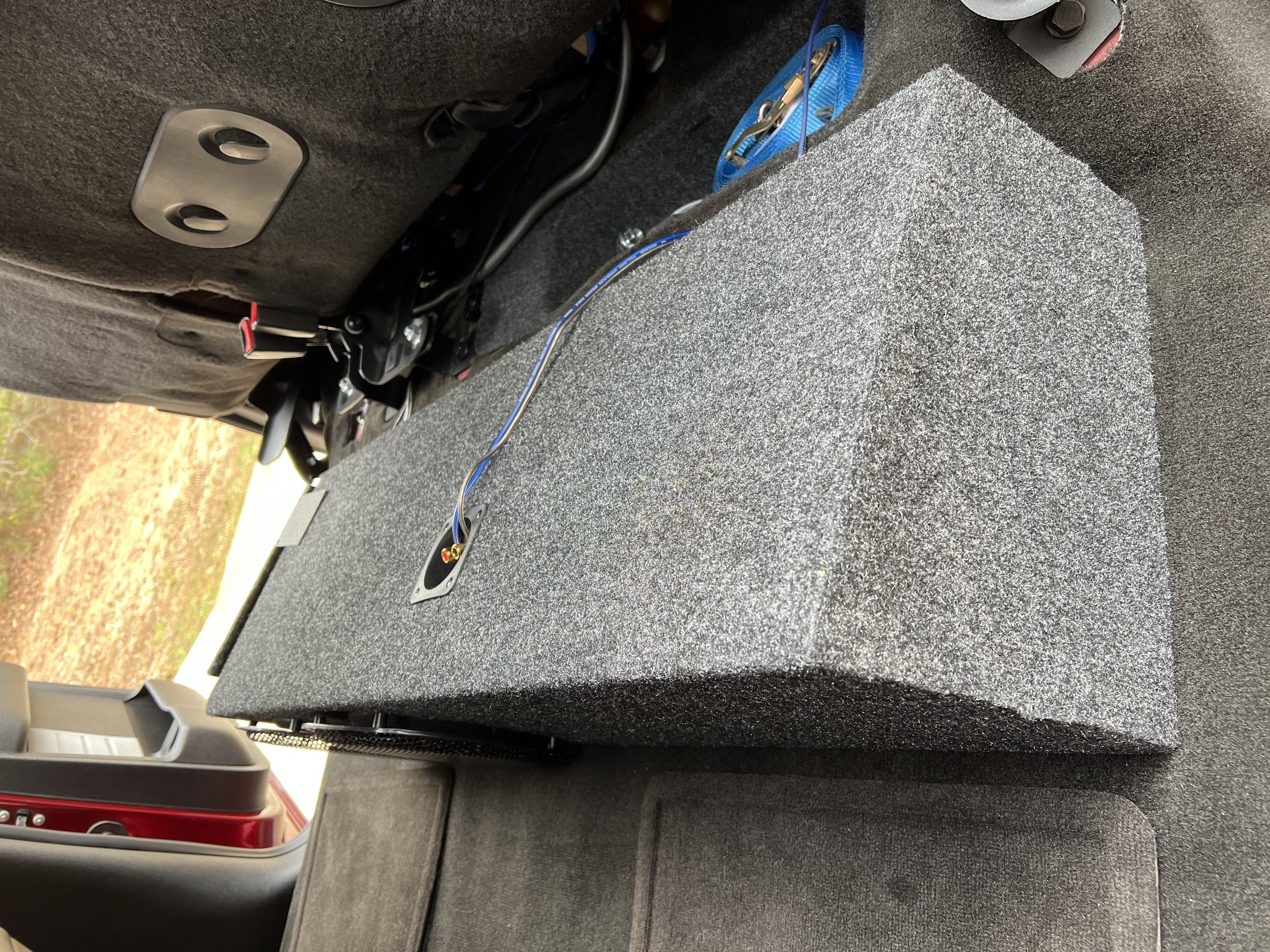

Well I finally finished up the build for my truck, and I must say it’s sounding dam good. These little 8s get deep and sound smooth. @Buck hooked me up with a nice design. 1.1 cubes net @ 30 hz.

Ok, I'll say this now. You see how your box is sort of like a tapered t-line? It's still a ported box, but look at the steps from the back of the sub airspace to and follow it through the port.
