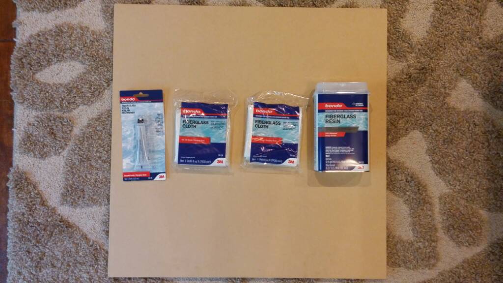

Thanks for the advice itcharles! I went out and bought most of the supplies needed to make the enclosure. I have not bought the sub yet. I am going to start the build and see where I end up and how much space I have. Here is a photo of what I got. The items may not be the highest quality, but it's what home depot had.
Awesome keep us updated on your build. You may inspire others.
