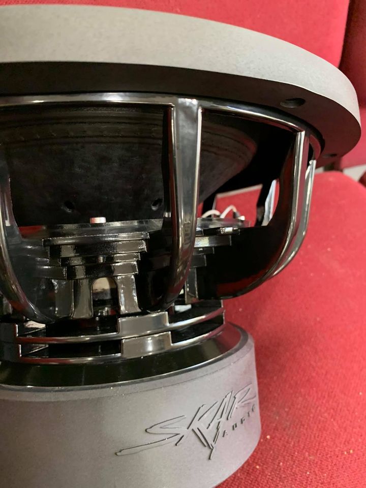

Skar is not on the same level as Sundown. They just take Sundowns build house parts and throw them together to make a subwoofer. Sundown actually does all the R&D to make sure you are getting quality equipment. Kevin of Skar scammed a ton of people, doesn't know car audio, and lies about the TS specs of their speakers/subwoofers. All about the $ over actually loving car audio like Jacob from Sundown. Jacobs wife is more knowledgeable about car audio than Kevin. :whistle:
Go with a Dayton HO 15" use the saved money to get a well built to spec box and a good amp.
I mean look at this... Double stacked cooling rings on a 12 spoke basket that was designed for great cooling..
