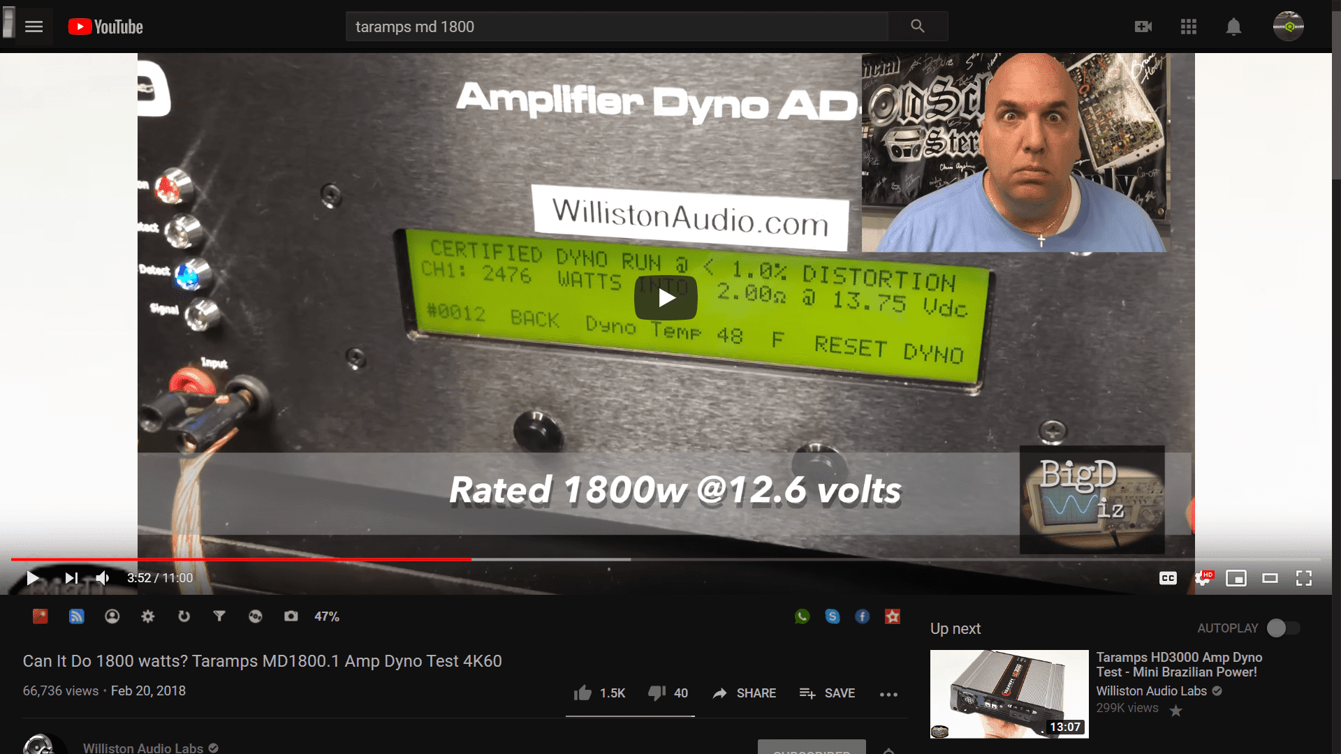

There is no MD3000 dyno, only an HD 3000 which is a full range amplifier of a totally different line.
there is a dyno of the MD 1800.1 2 ohms version and that amp does way more power certified than the soundstream at a much lower voltage aka a lot more efficient. there's 1 ohm and 2 ohm versions of the taramps md3000.1 idk why you only looked at 4 ohms. If an 1800.1 amp dynos for 2476 clean certified how much do you think the MD 3000 is going to dyno?
If you are going to do research, might want to really check out everything there is to know rather than just pick one amp you have a boner for, it'll save you a lot of money, get you a lot louder.
