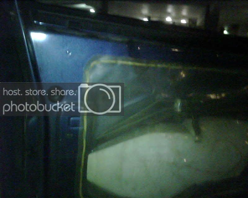

ok do you guys think i should deaden over this?
I have started the process of deadening the doors already. All holes are covered except the one with the Styrofoam in them. It sits pretty tight in there and it sits in grooves.
I dont have any current pics since i have started the deadening. I already removed the plastic covering the foam.
2000 Monte Carlo.
thoughts?
2000 Monte Carlo.
thoughts?
Weird man i just started sound deadening my 04 monte this weekend got about half done(driver door and trunk lid) I just tore out that styrofoam. Let me know how it works out for you. I'll be finishing mine this weekend
yeah id like to finish mine this weekend but its just to **** hot. I'll let ya know after i finish it
