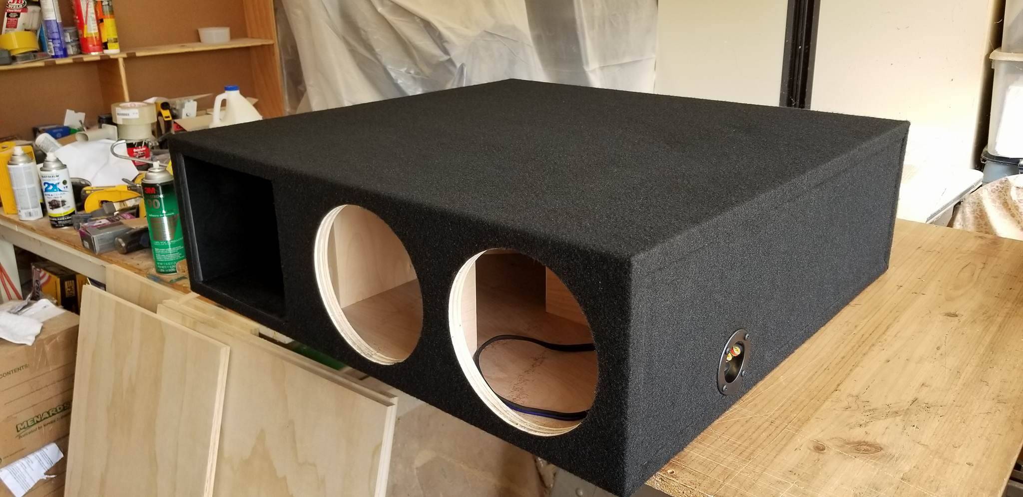

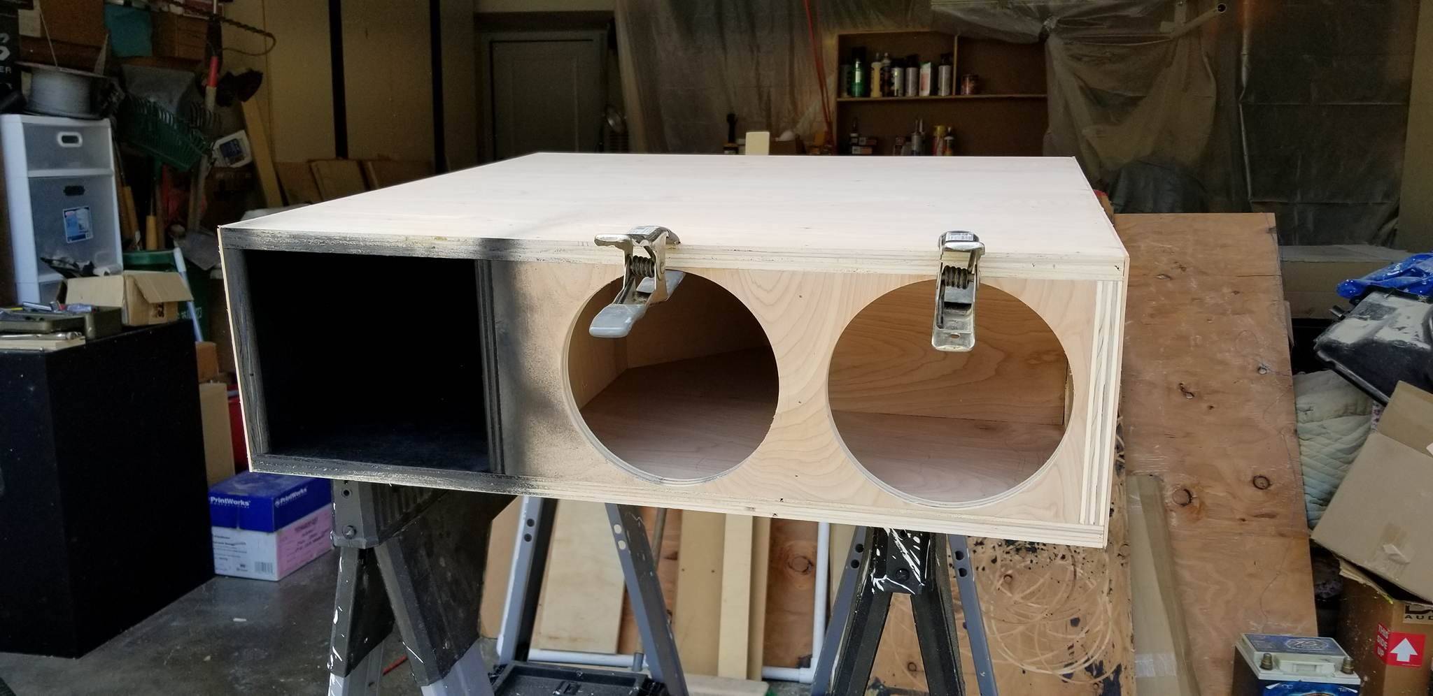

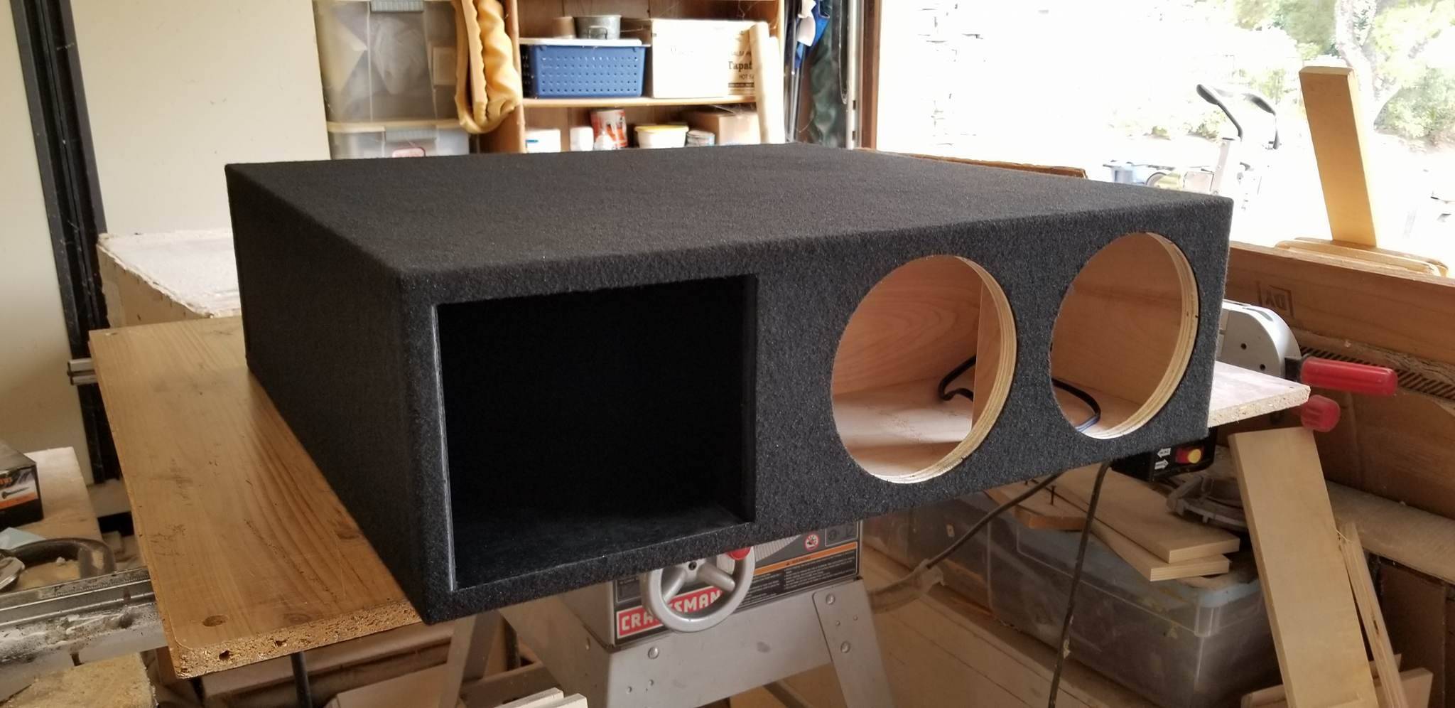

Because of some size restrictions I put on myself in the new build I'm going to start I was limited to 8s. I hit up CSCStang with my dimensions and asked him to try and make a Tline for two Sundown SA8v3s work and he worked his magic and was able to make it work...
I can't comment on the sound yet as I'm still waiting for some install pieces to arrive and need to make room in my workshop for the build but the quality of his work for the money can't be beat IMHO.

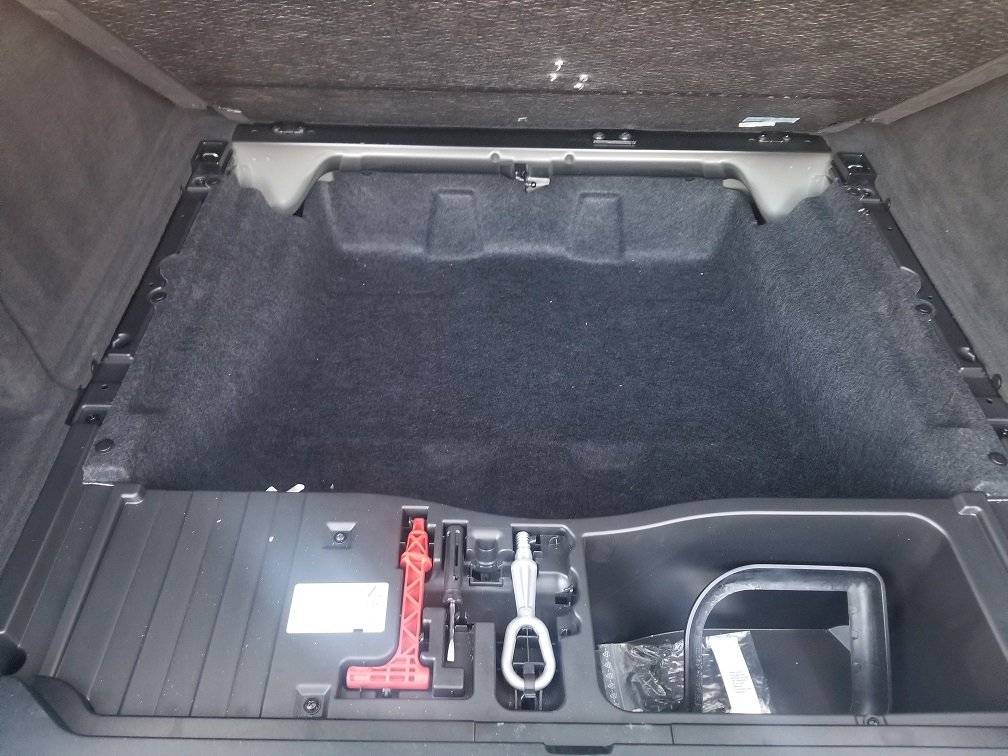

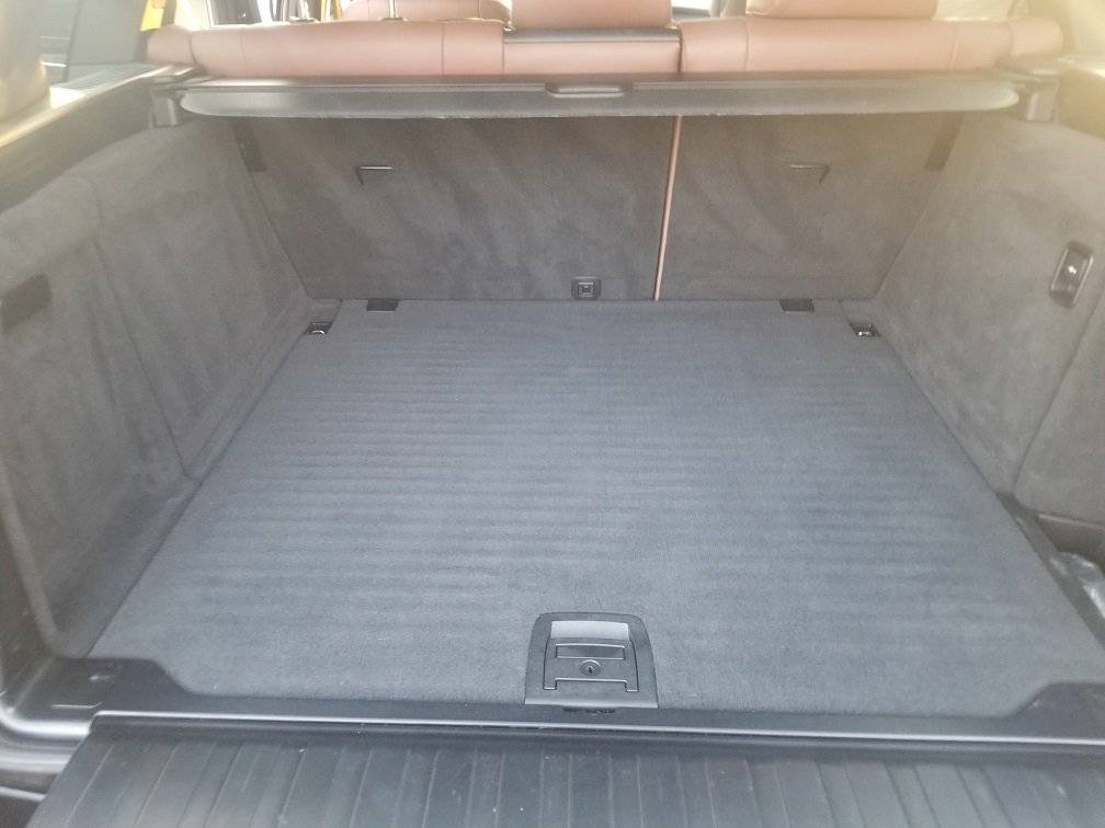

2013 BMW X5 diesel. It should be stealthy as hell too. I plan on putting it under here...
in this cavity...
It'll fit in there? Hope you plan to make a large opening or something to let the bass thru...
It's a tight fit but it fits. There should be enough gaps for the air to get out as it's not air tight. If not I'll cut a big hole and have a grill built for the hole.
Just wondering how far away the subs/port are from the wall compartment?
I ask with upmost respect because I think your gonna have issues "blocking" sound/bass inside that area. Might be an idea to create a big baffle out of wood and grille cloth and still use the space above. If that door is removeable.
gorgeous but man that's huge for 8's.. don't think i've seen a tline with port that big (or if i did i didn't know it was a tline)
you are too used to your "labrynth" enclosures... //content.invisioncic.com/y282845/emoticons/rolleyes.gif.c1fef805e9d1464d377451cd5bc18bfb.gif Thats standard size for T line, maybe a bit too small to be honest, but he is space restricted.
