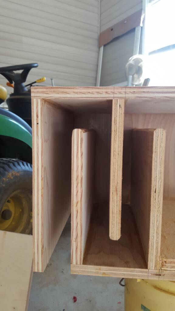

Will be using 4 Skar MA8 D2's in my new setup. Having difficulties with the enclosure. Currently I am looking at 48.25" w x 20" h x 13" d (external measurements), with a 3" w x 18.5" x 30" l port. Calculators (Torres and Xplicit) show it to be 5.76cuft gross, 3.84 net (.4cuft displaced by subs) with tuning around 32-33hz. Does this sound acceptable?

What part of GA are you from? Not sure what kind of power you're going to run, but personally I'd drop it down to 2.8cuft net. Unless your running 500w or less, 3.84cuft net is way too big. Try to keep it between 0.72-0.78 @ 32hz and your vent velocity around 26-27 m/s on however much power you're going to run. I'll do a design for you and post it up here In a few.
Edit: I also wouldn't do a labyrinth port side firing like that. You want as much length that you can get of straight port before the first port bend, having the opening right at the bend is going to kill the efficiency of the box. The one on inside the box isn't as important, but a bend at the port opening like that will make Hella noise...ask me how I know.

What would be the best way to go about doing the port with it side firing?
One port wall across the bottom of the box is much more efficient. And agreed with the dealers recs on net cubes....

Ive had great luck with subs forward port up. Side firing work great as well.
Try to keep bends to a min.. It just creates turbulence.
One thing i suggest you do is try to keep the distance between the woofers and the port the same..
