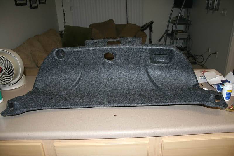

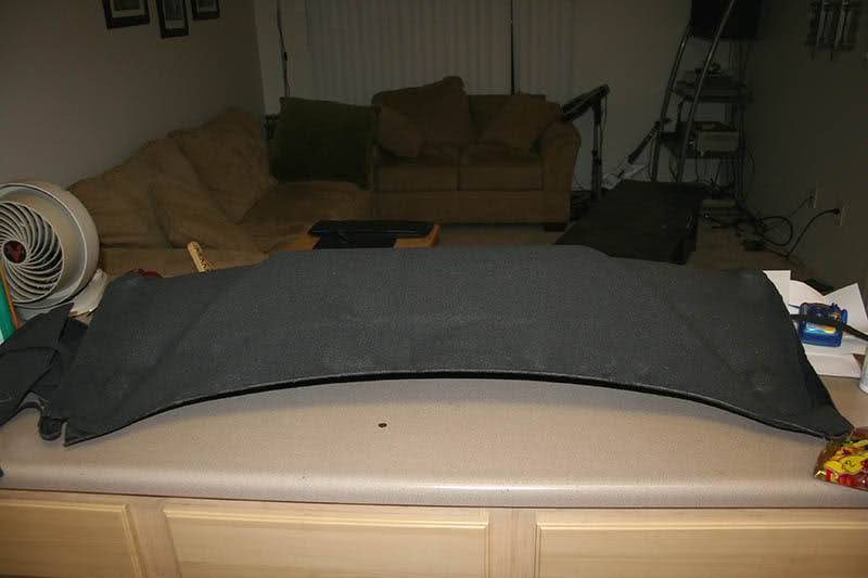

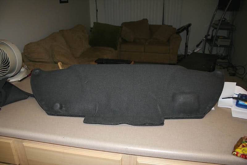

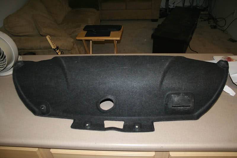

Trunk Liner -
In my process of deadening the trunk, I decided to add some closed cell foam (Ensolite) to the back of the trunk liner. I used some spray adhesive and did it all in one piece. I tried my best to match all of the contours of the trunk liner, and think it came out pretty good.
Awesome job mang! Not a big fan of the amps, but as long as it does that trick for you, then that is all that matters. Love the attention to detail of the entire install. I may pick up a set of those RSD's if I don't like my Alpine SPX'S. They are a nice set, but very mellow IMO.

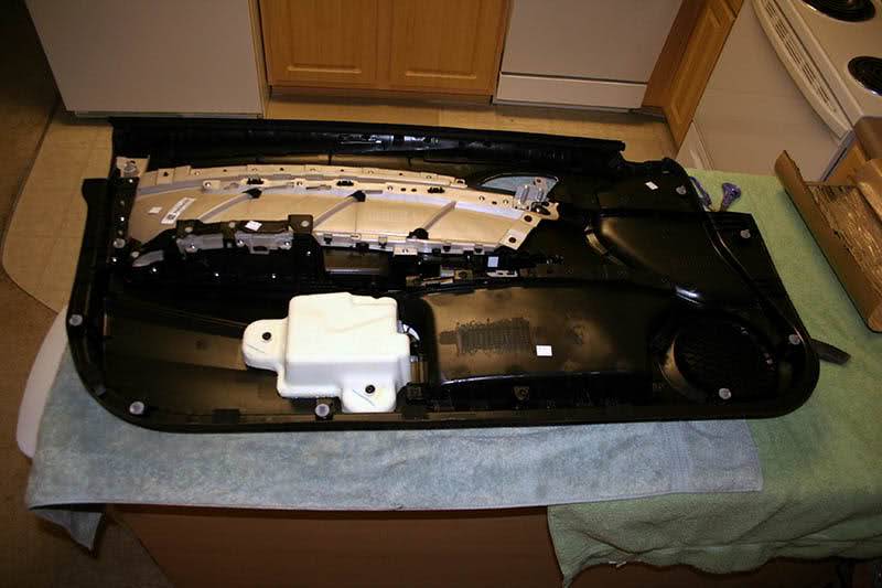

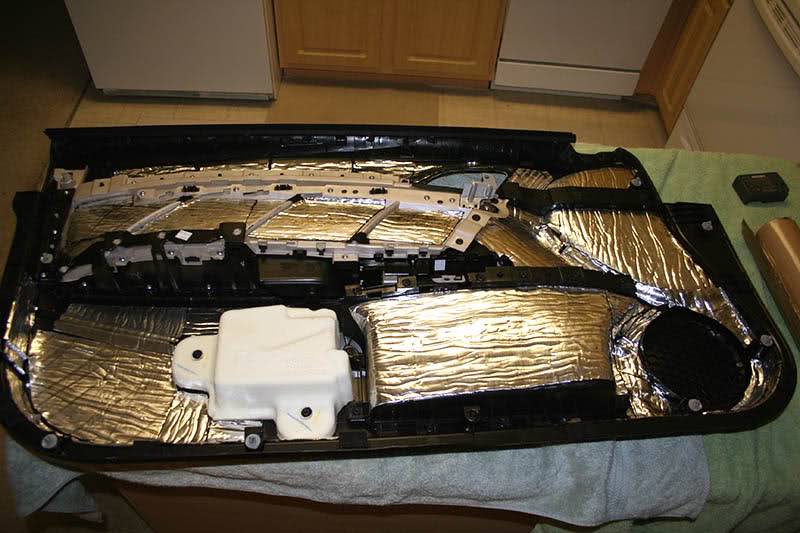

Door Trim Panel Deadening -
Even with the stock speakers, when played at anything past a medium volume level, I noticed that the door trim panel and armrest area would vibrate like crazy. I decided to do some deadening action on it. I built up a lot of layers around the speaker grill, just took whatever scrap I had left, and piled it on.
those 'quick connects' for the speaker wire... did you make those or are they sold like that somewhat? very slick...
