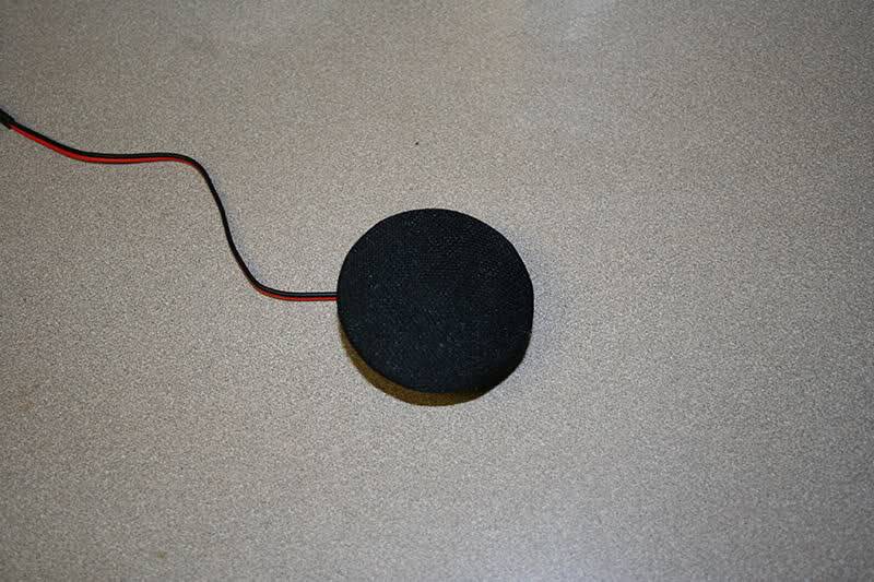

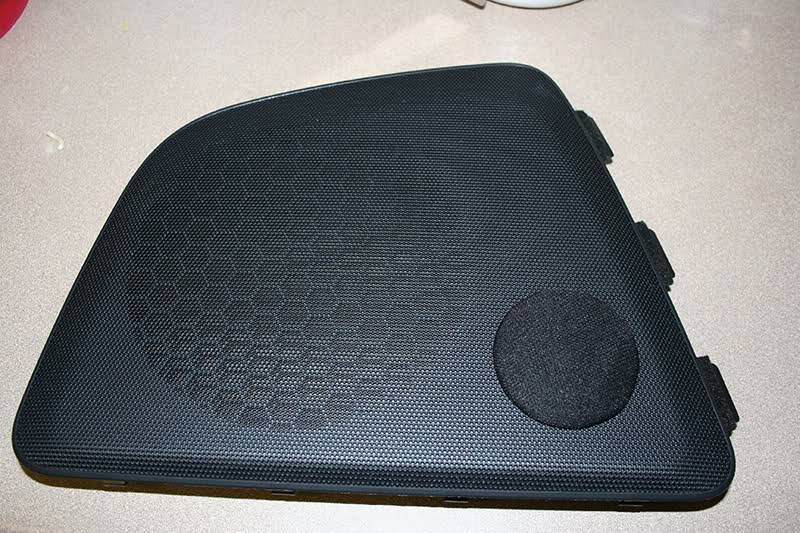

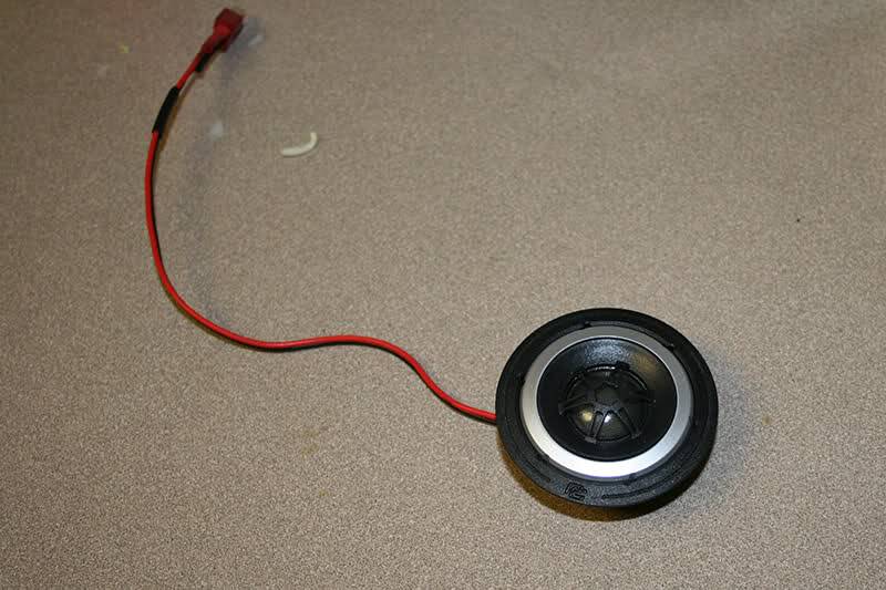

Usually, for SQ applications, you do not want to have a rear soundstage, as it can mess up imaging. I actually like having a bit of detail coming from the rear, and decided to keep a rear soundstage. However, you do NOT want to have too bright of a setup, since the human ear can pick up high frequencies much more directionally than the low. I did not set out to buy a comp set, as there are no locations to put the tweeters, but the Phoenix Gold RSD's were a fantastic value, and give great midbass response.
I had to decide where to mount the tweeters, and decided it'd be safest to just modify the stock grills. The grills are actually only "grills" directly over the 6.5 speaker, the rest of the grill is solid plastic, and wouldn't let any sound through. I figured if I totally messed up, I could just buy another set from the parts department. I cut a hole in them for the tweeters to be mounted to. I added two layers of speaker grill fabric over the tweeters firstly because they were too ugly to be mounted naked, and secondly to help attenuate them a bit to avoid having too bright of a rear soundstage.

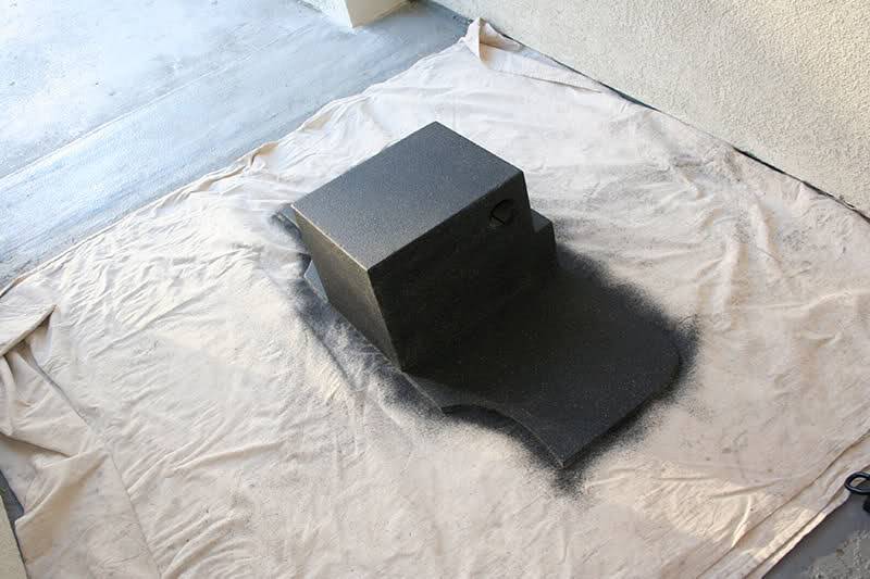

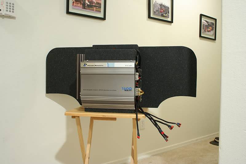

Since I am not concered with SPL, and require my sub to be able to reproduce a wide range of music accurately, I decided to go with a sealed box. Another huge requirement of mine is for the sub/amp mounting system to be completely modular. I designed it to be able to be removed from the car in under 30 seconds using only 1 allen wrench to loosen 2 grub screws to remove the power/ground wires from the distro bock. All other wires are able to be disconnected via plugs at the sub/amp box. This allows me to easily pull out the entire system in case I need to put something in the trunk and flip the seats down.
My sub's specs call for 1.25 cubic feet of volume. I designed the box to be closer to 1 cubic feet, and added some polyfill to make up for the lost volume. I used 1/2 inch MDF for the box's construction, and designed it to fire towards the back of the car. The face is flat, and takes up the rear space of the trunk and serve to hide all of the wires. The trunk of the coupe is much bigger than I need on an everyday basis, so I won't miss the lost space.
Here are pics of it face down while I was painting the back of the box. I used some textured paint for it. I hate carpeting boxes. Don't have the patience for it at all! You can see the mounting hole for the speaker terminal cup. The curved parts at the base are to clear the contours of the trunk.

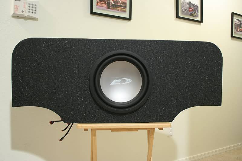

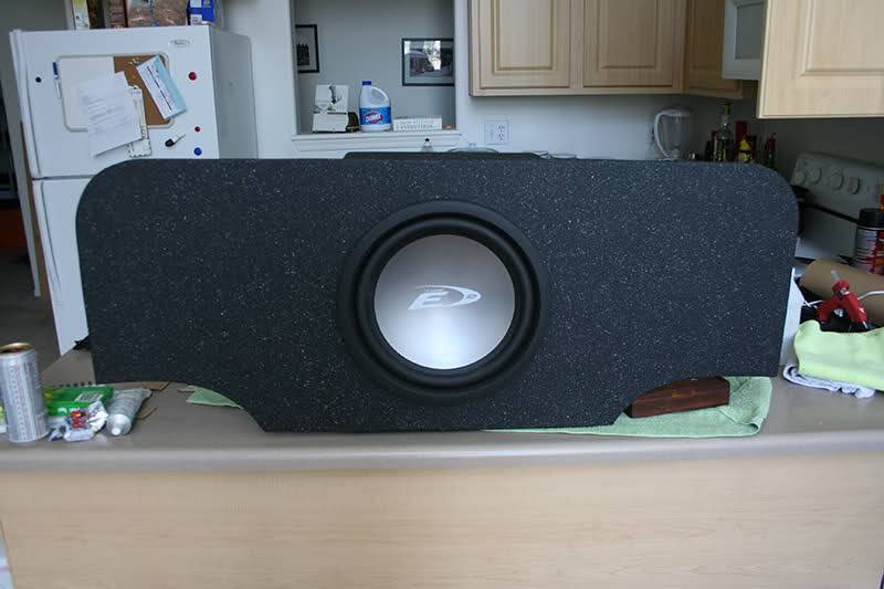

Here is my sub installed into the box. I used just regular wood glue to attach the polyfill to the inside of the box. Ran some silicone caulking on all the joints to seal it up well. Pretty happy with the looks so far. I'll be mounting the amps and crossovers next, and wiring those up. Stay tuned.
Box complete (99%) -

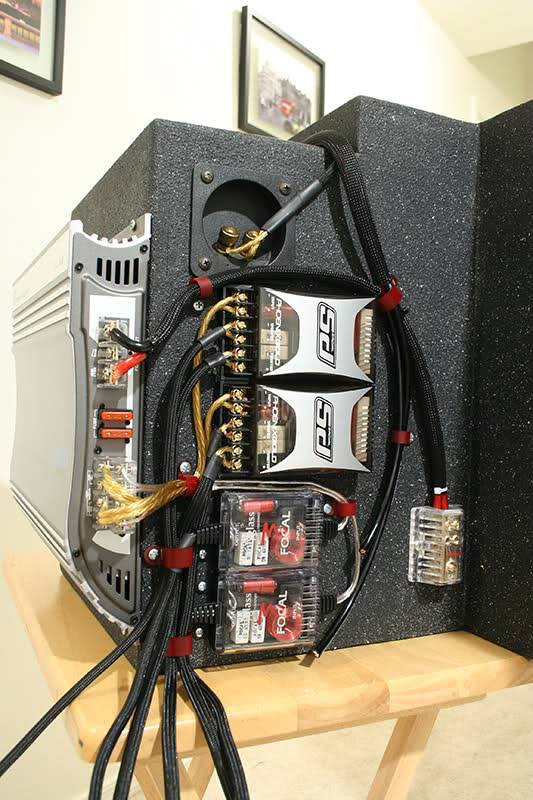

Got the box all done. Mounted the amps and crossovers, and did all of the wiring. None of the screw should have penetrated into the box's cavity, but I put glue on the threads of each screw juuuuuust in case.
Here are some closeups of the crossover side. I got some tech flex for the wires, helped make them look pretty. The two bundles you see exiting are for the right and left side interior speakers. Helps to keep them organized. I decided to mount the crossovers on the box instead of in the doors because they have some adjustments on them, and I didn't want to go through the hassle of opening my door if I ever wanted to make an adjustment. I used Dean's Ultra plugs for all of the connectors. They are designed for RC car usage, but are very useful here. Each plug has a male and female end, with specific polarity, so you can't plug them in and reverse the polarity. Also, they are very sturdy and require a good bit of effort to unplug them, so I don't worry about them coming undone on accident. Lastly, they are very low loss and have a huge contact surface between the male and female plugs. Very nice indeed. Only bad thing about them is that they require soldering, which some people don't like doing. I dn't mind it at all personally. For those of you with sharp eyes, you'll see the only thing I'm missing is the ground distro block. It's in the mail!
