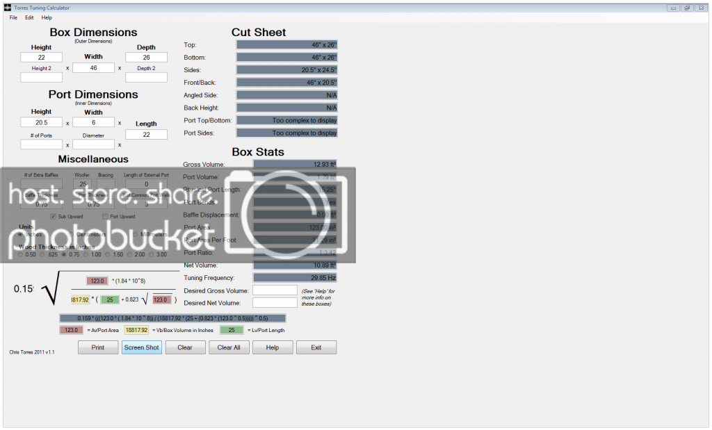

I'm getting a couple of stereo integrity 18s(same subs) for my Escalade, here's what I got, if it helps, feel free to correct me if I've done something wrong.
