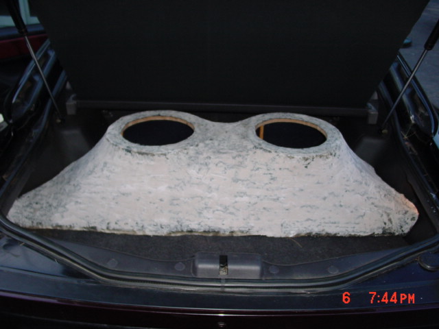

Ok lets see...
power 600rms, 10in woofers, 18mm one way excursion, 2cu ft

Whenever i heard port area, i was thinking the area that the whole tube took up. i dont have that much area to work with length though. My box is only 7 1/2in deep and 16in back.
Thanks Jmac for putting up with my noobness. Heres my fiberglass box, I AM NOT about to build another one anytime soon. This winter im going to build a huge box in the back of my winter car (trooper) though.

So that's 2 ft^3 gross volume ? Have you physically measured it out ?
If not, grab a 1 liter container and pour liter after liter into the box until it's full and don't forget count every liter you pour in ...
yes. i used a one gallon container and converted it to sq ft.
How wide is your enclosure ?
So we're looking at ...
2 ft^3 gross volume
- 2 x 0.1 ft^3 driver displacement
- port displacement
or
2.2 ft^3 gross volume
- port displacement
4 feet on the widest and 3 on the shortest. and its the the first option.
