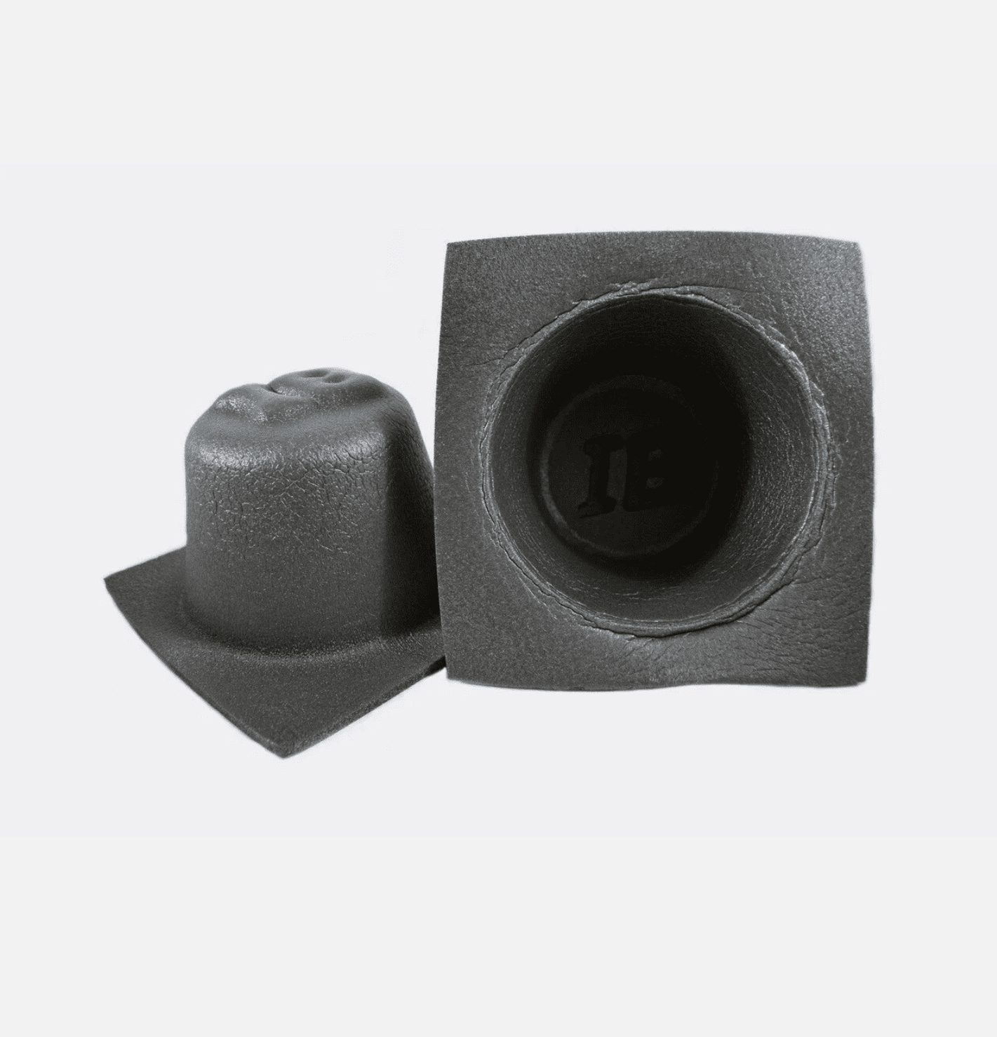

Not alot of options the nvx silicon baffles give you a lot of cover but you can't really seal the entire back side to be truly waterproof without affecting frequency response

I like using foam baffles. I have had the current baffles ~4 years. As far as frequency attenuation, I hear no discernible difference sans baffles.

I may get some of those foam speaker baffles and cut a hole in the bottom of them supposedly improves the sound quality so they're not completely enclosing the speaker just over the top or I may just leave them alone the speakers that were in my car the stock ones we're not covered my car is 10 years old I just removed the stock speakers they looked perfectly fine.
