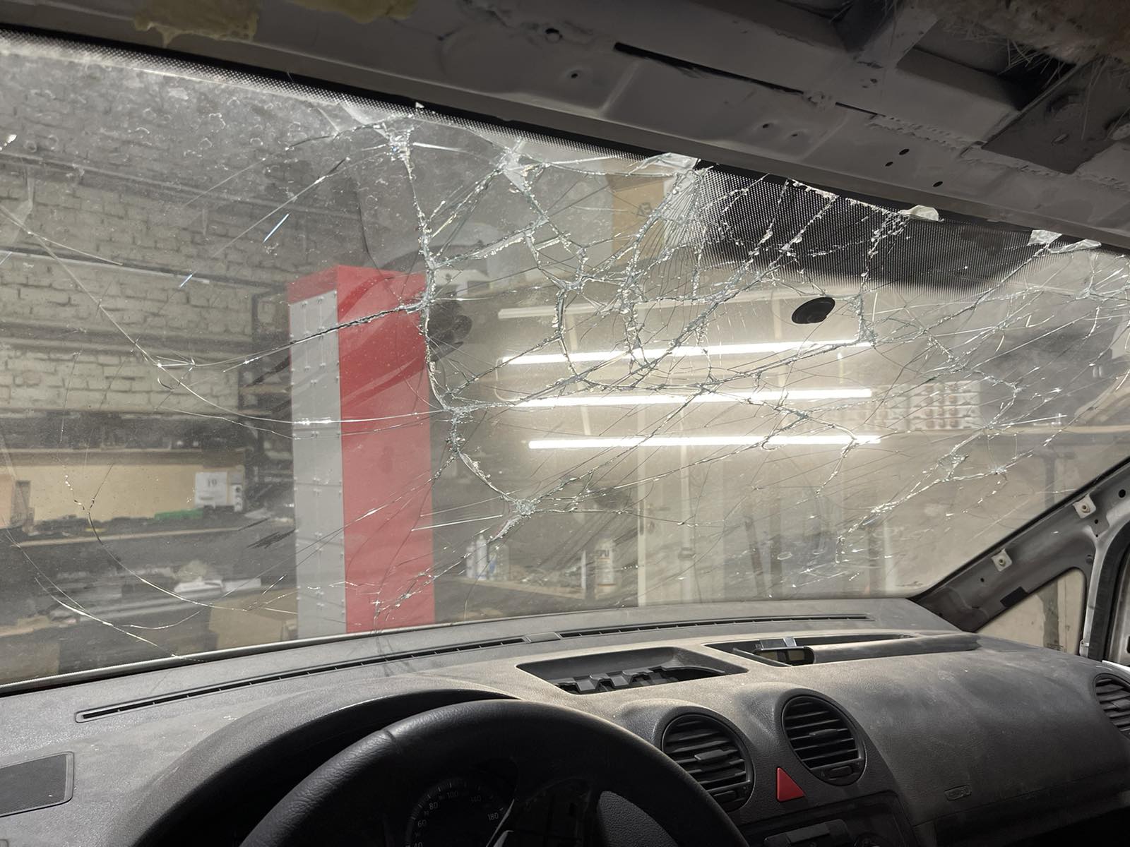

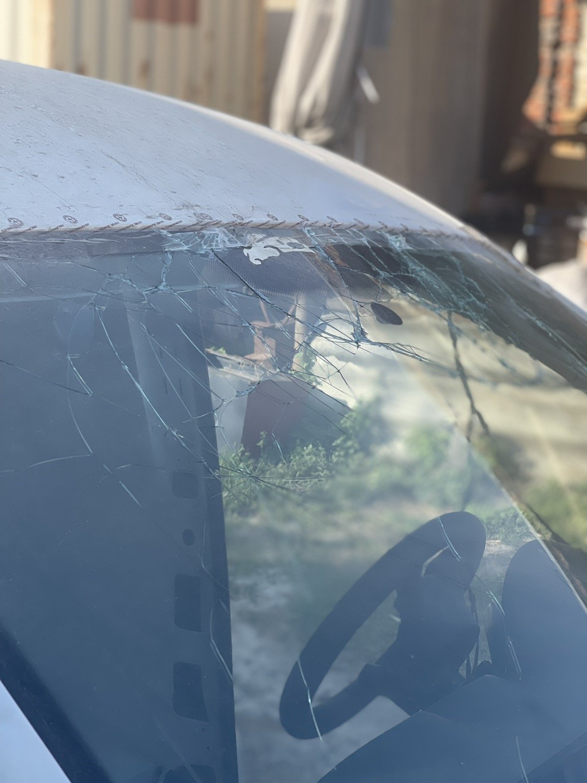

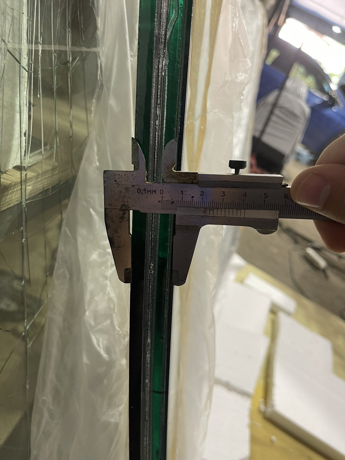

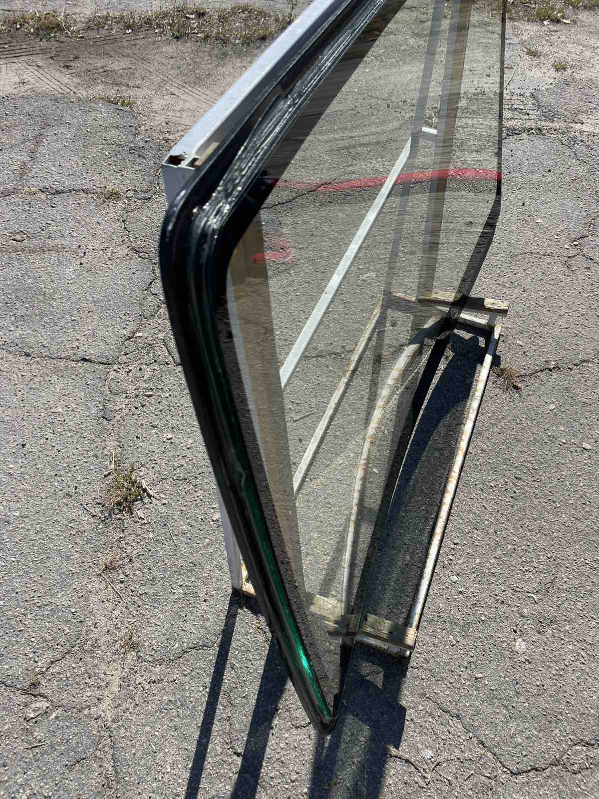

The first start was made in order to understand the weak points of the car. On a broken windshield, our first result was 160.3DB with a power of 17000W. The glass turned out to be weak, we tried 3 methods of gluing, it does not help, so we ordered armored glass!

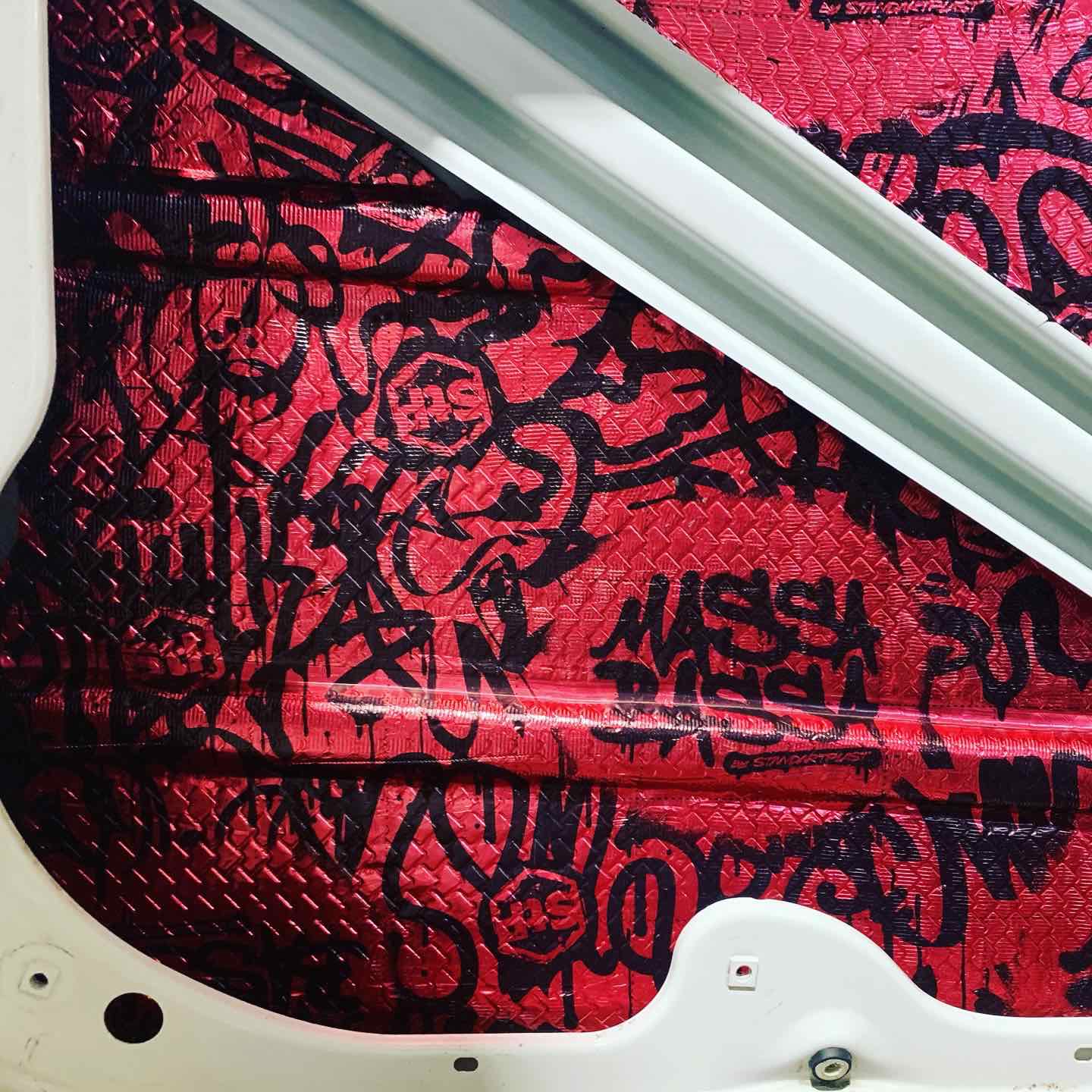

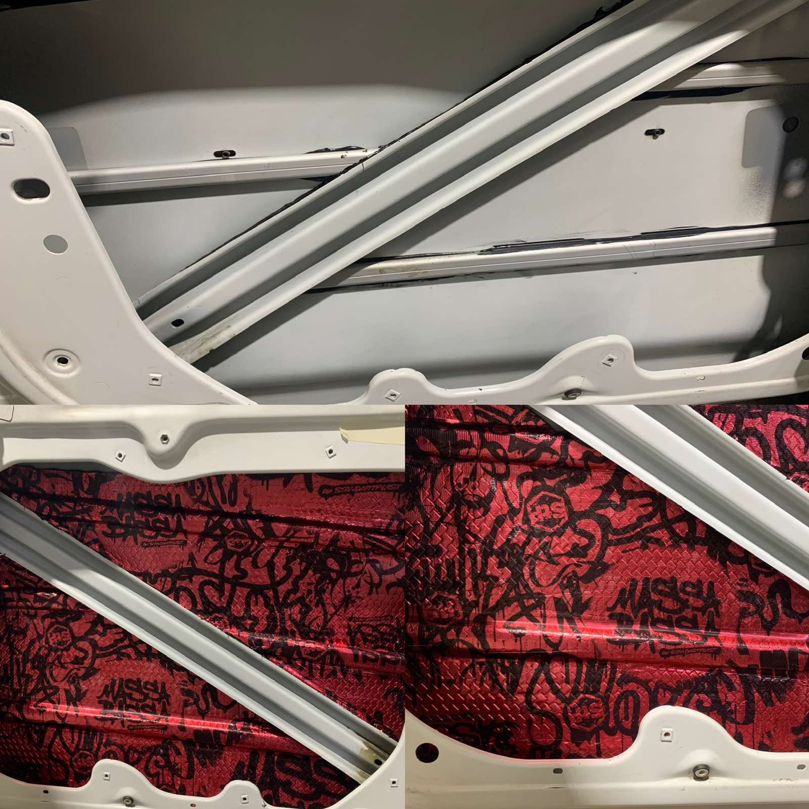

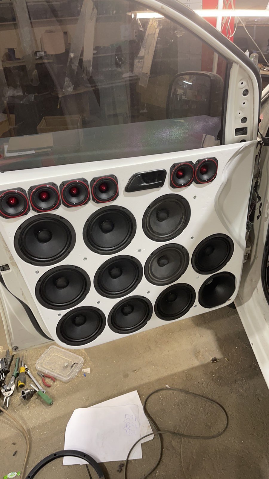

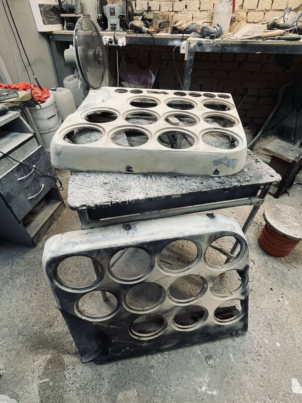

doors, loud doors. We tried to approach the hardness of the door with a special approach. Sealant and aluminum profile, inside it is a frame for fixing the skin.
a protective part will be added to the front part later, it will also be decorative

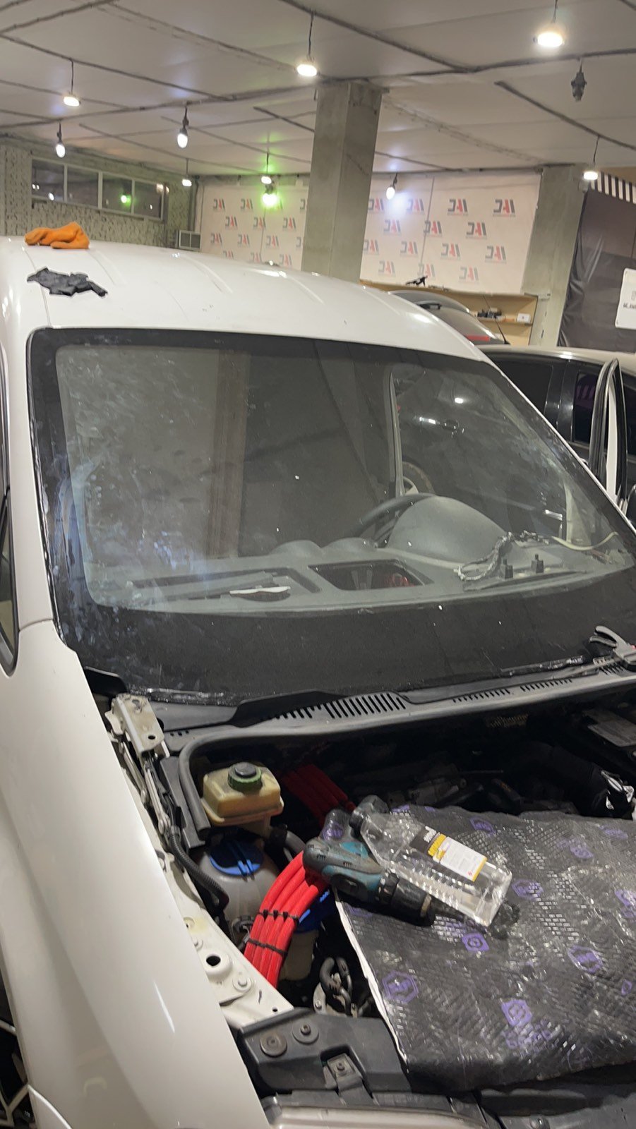

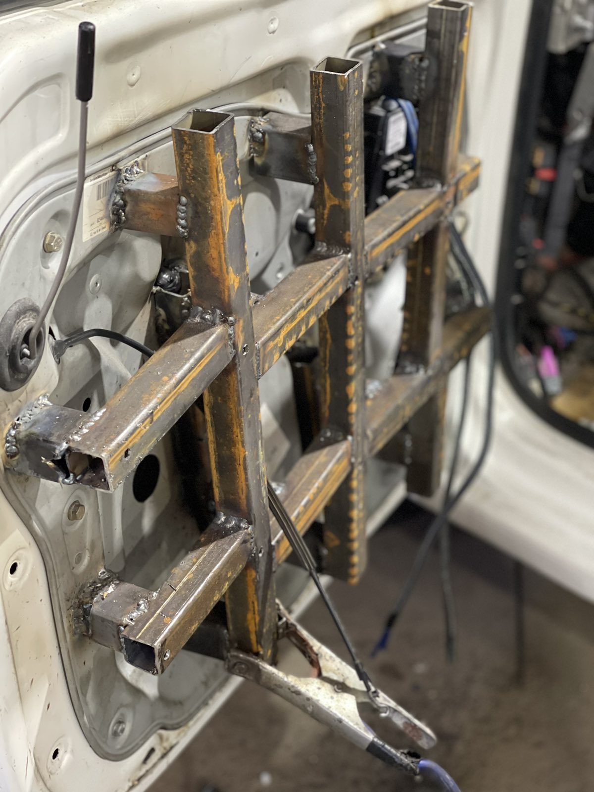

after replacing glass and minor improvements, the result has changed. At the moment it is 163 + Db with a power of 18K.
The next step is to disassemble the door and reinforce it with a metal square around the perimeter. The corner of the door moves very strongly, so this must be fought ...
