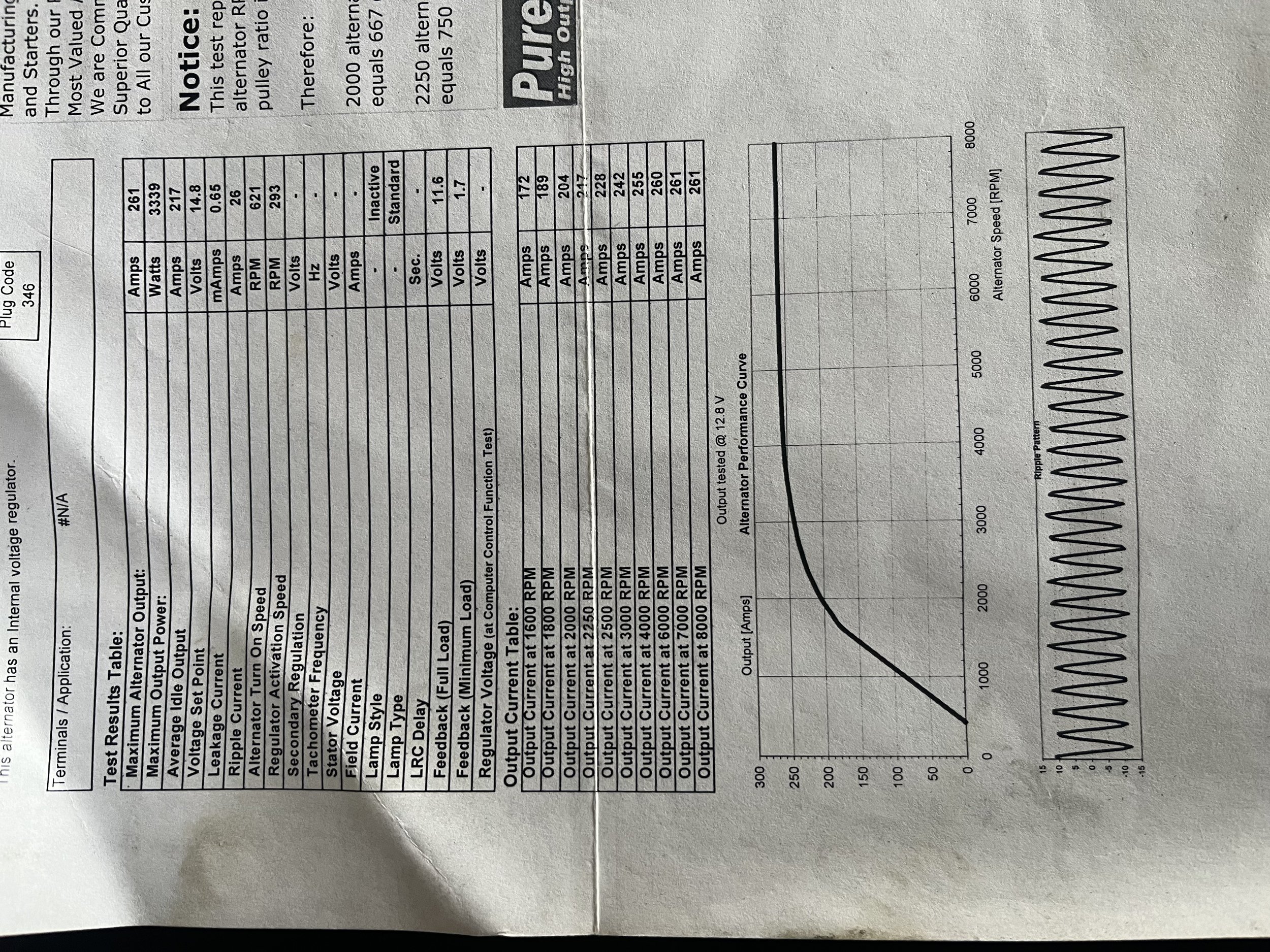

This is the sheet on my alternator. I would guess if I wanted a different output than 14.8 I could have it. True, it may only make peak power under limited circumstances but the proof is in the pudding. Or rather it’s on the spec sheet.
This one was hand made in AZ.
Why is idle rpm 217 amps, and 217 amps is clearly not until 2250 rpm? They don't even test it below 1600 rpm?? I'll have to see if I can find mine, but my Mechman does about that, but shift the curve about 800 rpm lower.
