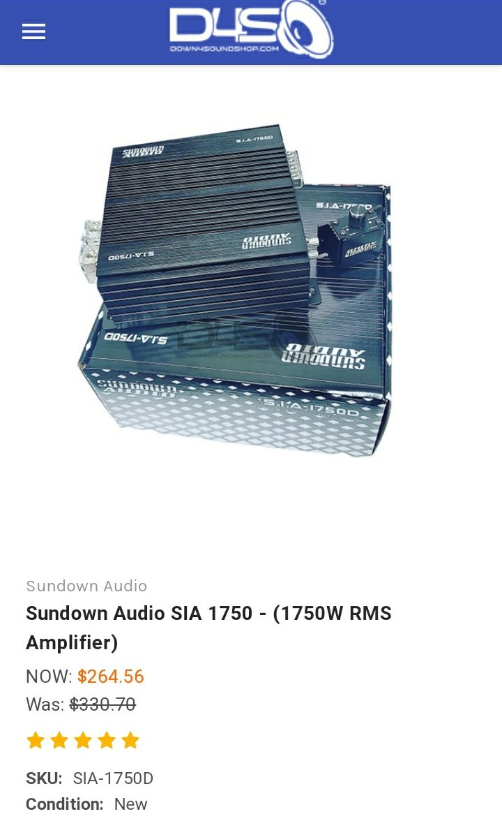

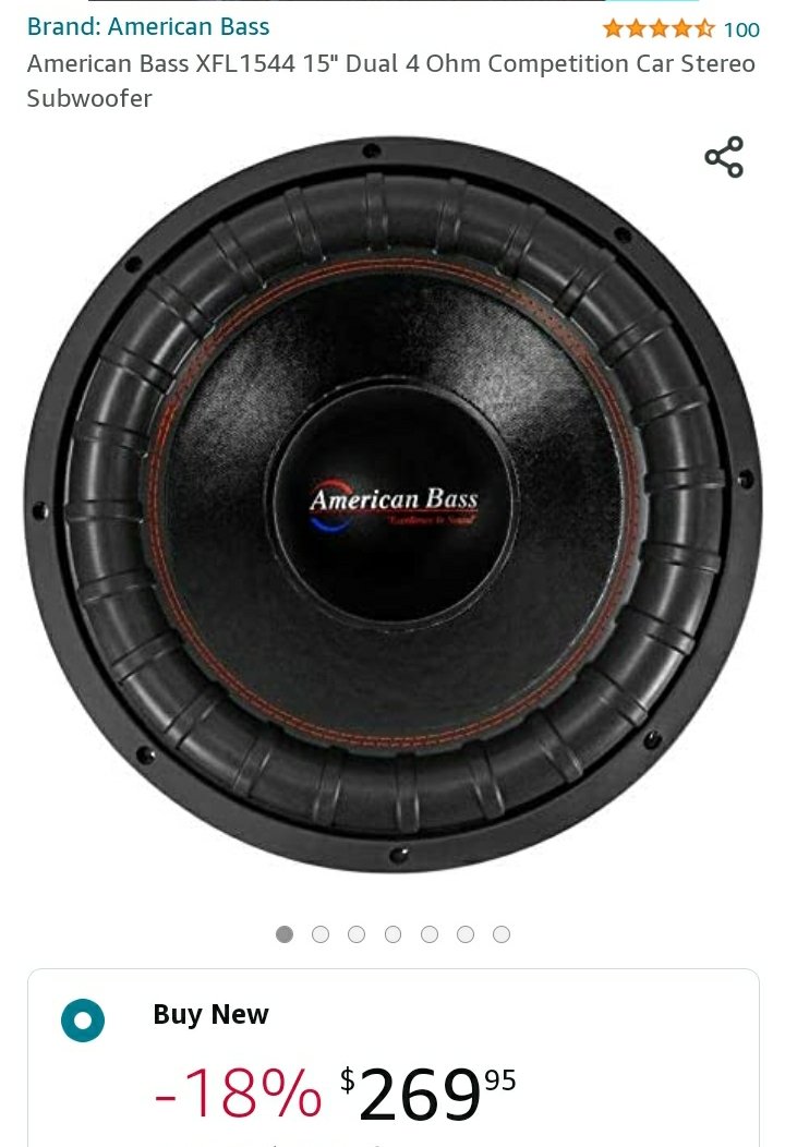

No on the Comp Q IMO. This would work well. 1,750 watts @ 2 ohms and around $500.
View attachment 43078View attachment 43079
This does sound nice and in a perfect world I would run it, but would my 117 amp alternator and red top optima battery be able to handle this and a 4 channel amp that supplies about 400 watts rms total. I hate to ask so many questions, but if not would I rather be better off with a Kicker 15, single 12, 12s, or 10s. The American Bass seems like it could throw down, but I don't know how well given my power and box size limitations.
