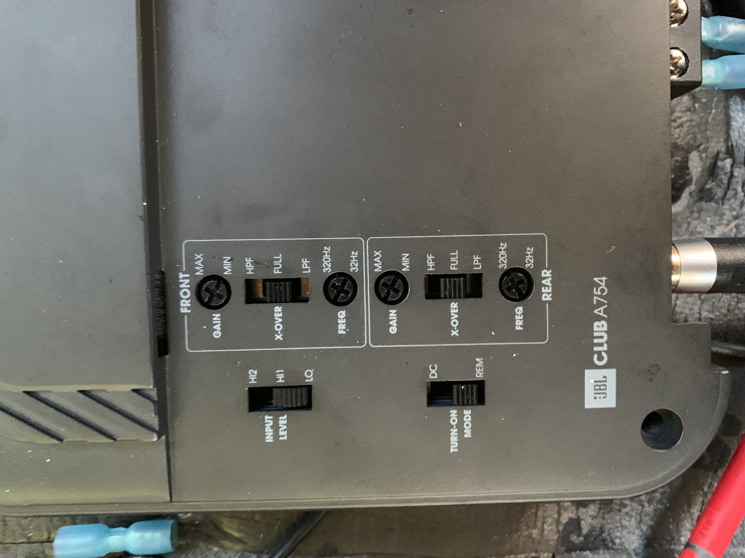

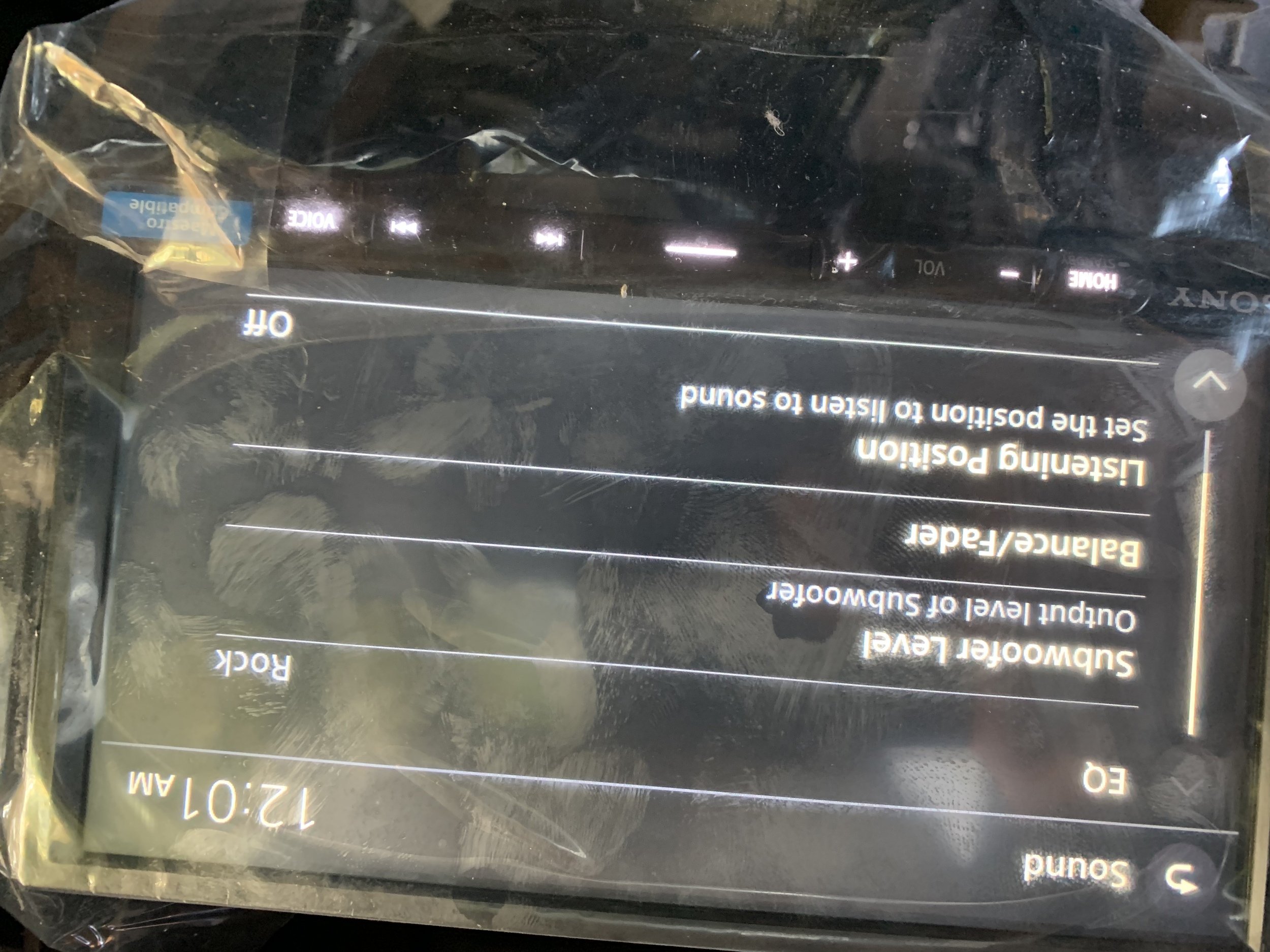

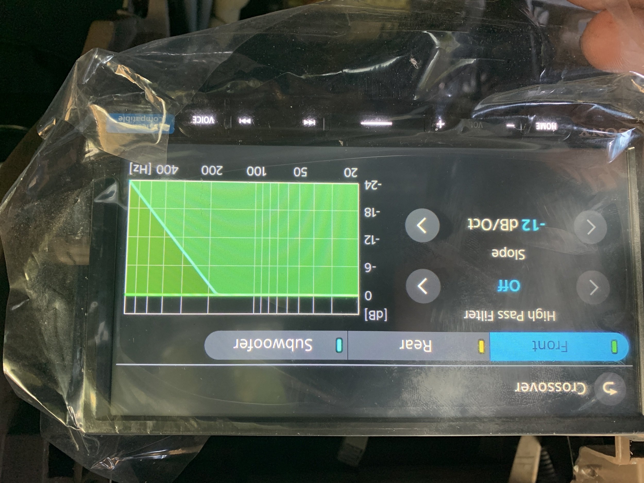

So both head unit and amp settings are set to “full range/thru” ?

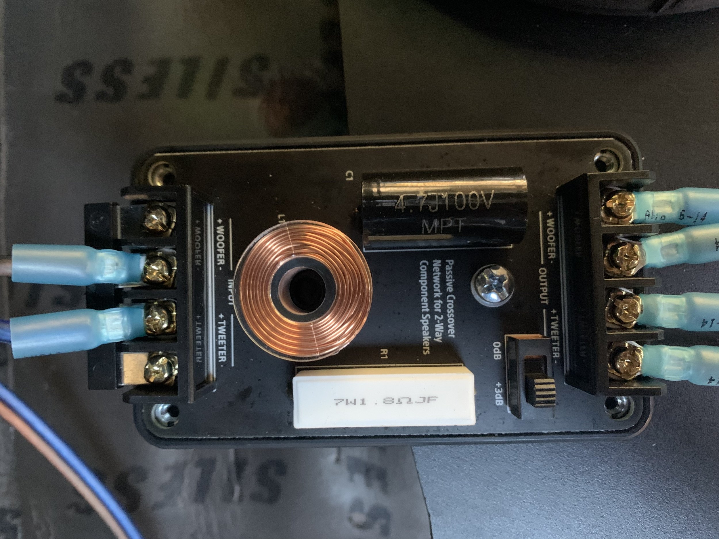

Amp yes, head unit doesn’t have those options. Here’s how it all looks:
The passive x-over inputs are wrong. Put the inputs on the woofer, then run a jumper to the tweeter. Pos to pos, neg to neg.
there is already a jumper on the input of the x-over. But still switched it and no change.
do keep in mind this whole set up worked just fine on my home system.
Make sure you aren't hooking up the tweeter to either the full range input or the mid/woofer output. I can't think of a reason the crossover would work properly on a home receiver and not in the car...
