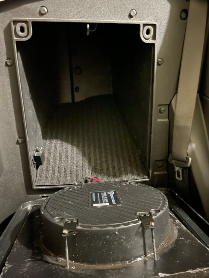

So I just installed by 10" subwoofer into the door of a storage compartment behind the passenger seat of my Slingshot.
The Subwoofer is held by a thick hood board on the back of the plastic door ( the hole compartment is plastic like the majority of the interior of the Polaris slingshot)
The door sits pretty tight and is sealed with some from and the lock gives it extras stability , but of cause nothing but a wooden enclosure which can be about $500.

LOL.. What the hell is going on in that 3rd pic?? Deff not a proper environment for that sub, let alone any sub for that matter. get an enclosure built for it, or try using some tools of your own and build one. Its not rocket science for a sealed enclosure
... just wanted to find out why the subwoofer is just wobbling .. hardly any bass coming out.. before I take further steps. I still don't now 100% of the housing is causing the extreme movement of the subwoofer thats what I stuffed jackets in there to see what happens and documented. Sure it's not rockedsicne but I want to eliminate all possibilities before I kill my storage. ( So if Acoustic Foam material would have been the answer, then these jackets would have given me a hint)

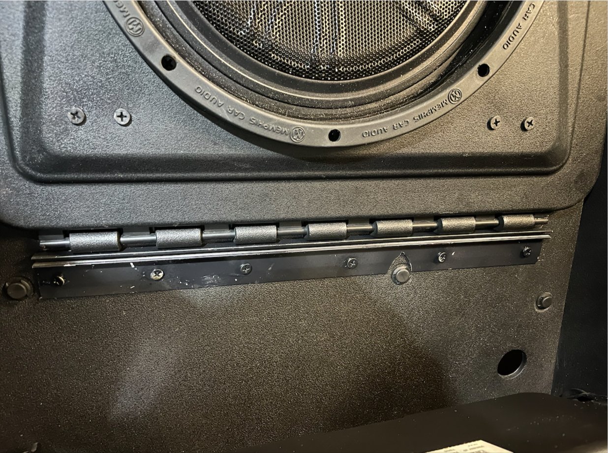

After installing 4 different subs including " Free - Air Subwoofers " that suppose to be able to work great in any inclosure .. on cheap Rockville and one expensive Kicker .. I had the same outcome every time .. a lot of wobbling .. rattling and minimal bass , I found the best solution :
A small active sub box that let me keep 85% of the storage . Needless to say this solution doesn't produce the biggest bang but probably my biggest bang for my bucks lol :
42343
Still kind of heavy so I supported the plastic hinges with a metal strip :
42344
