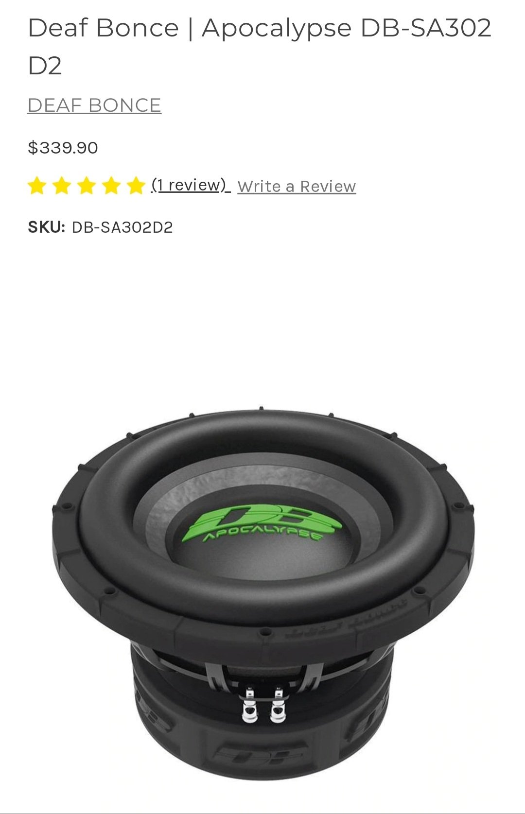

One of these in a properly built ported box on a 3K amp should light that car up. Maybe, a Sundown SFB3K.
