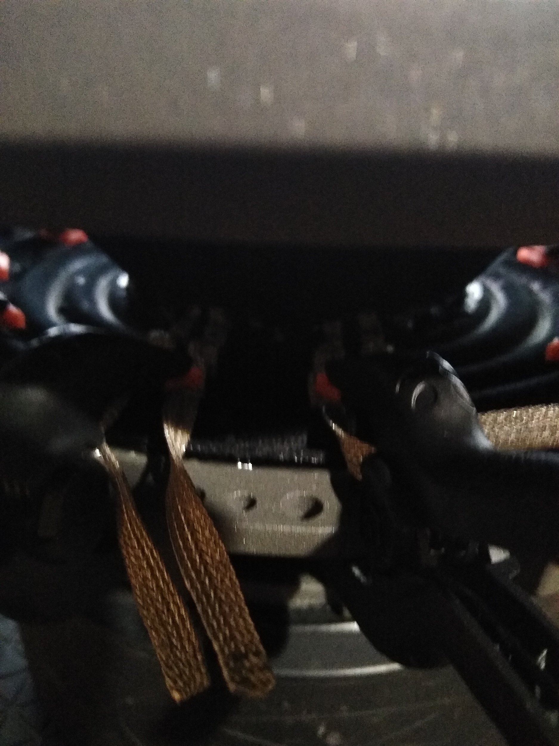

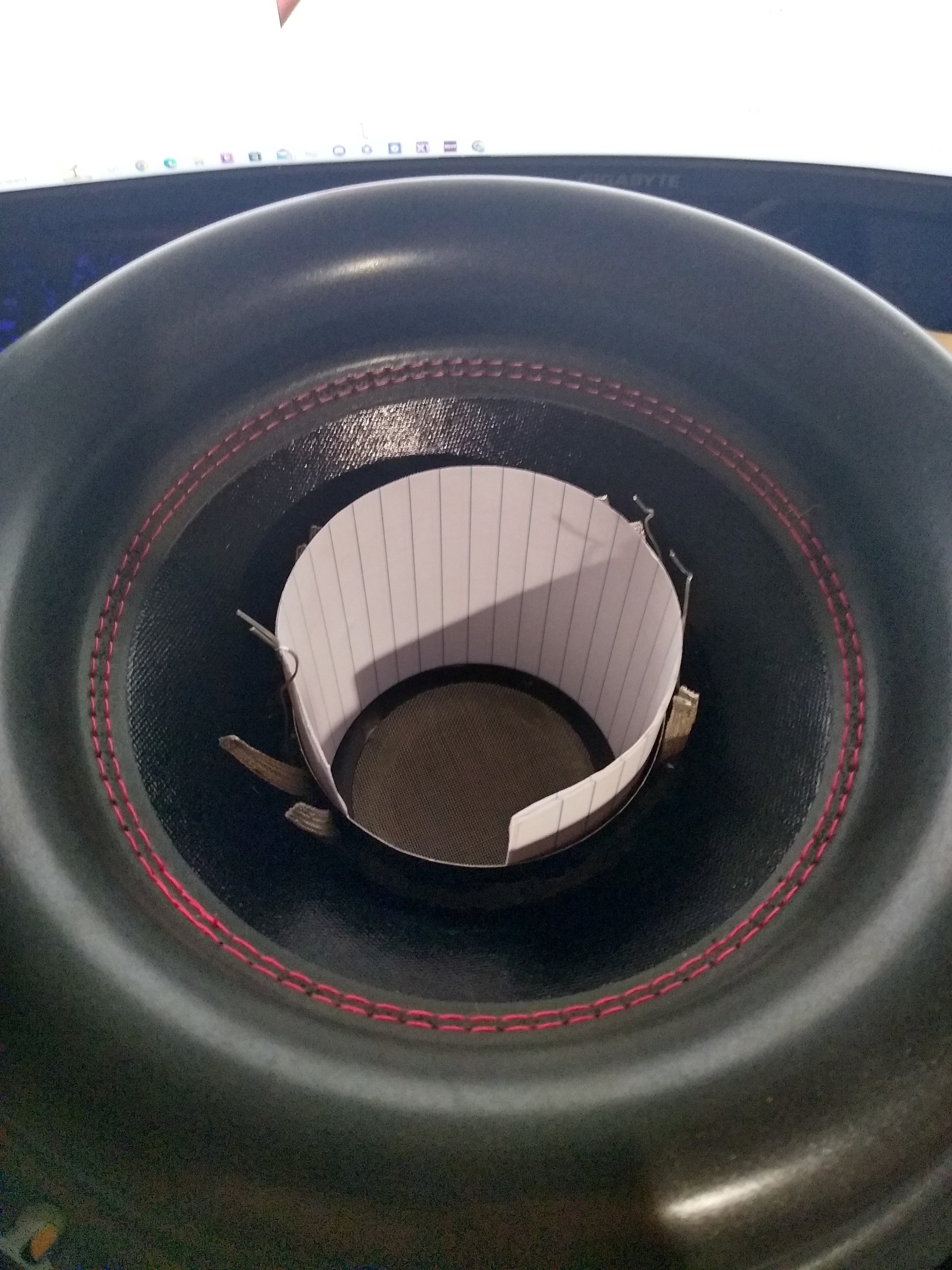

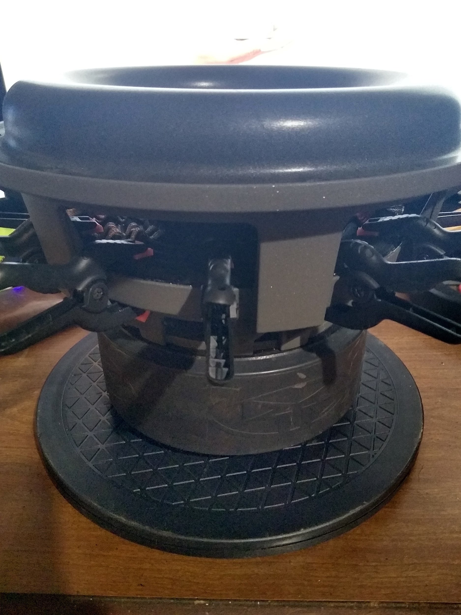

Setting the HX2 Power motor up for a 12" as it was previously a stock 10". Went with a crossfire type 6 spoke basket, 9.25" 3 layer progressive spider pack, mega roll non pressed kraft pulp cone and a USA precision econowind 2k watt coil šŸ˜. Used the super thick CA ultra glue for coil to spider and cone. Used 6000 for spider landing, will use 6000 for surround and dust cap as well. Let's see where this goes, I am following another build that was successful so I hope this will turn out good. Those that don't know I'm just a novice and do this for myself and to help buddies, so pros will be much better.
