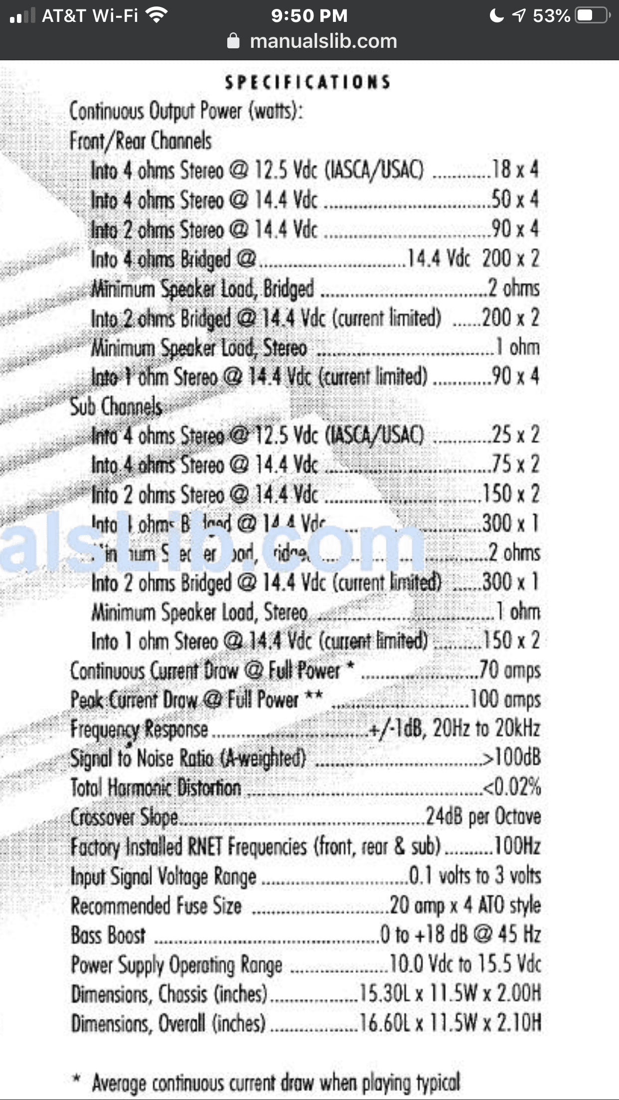

I have two 2ohm dvc subs that I’m trying to wire into an xs6600 Phoenix gold. What is the best way to wire them? I’m thinking both subs coils in series then both subs wired in parallel and bridged on the amp subwoofer channel. I think that will be 1 ohm. Does that sound right?
Na I’ll wire each subs two voice coils in series should be 4 ohms total per sub. So if each sub at the amp is run in parallel and bridged. I thinks it’s one ohm
It'll be a 2 ohm nominal load if series/parallel is used, if the amp is a multichannel and bridged on a pair of channels into a 2 ohm nominal load, the bridged channels will each "see" 1 ohm but not many multichannel/2ch amps are rated 2 ohm bridged and will last.

Yes you are correct! I’ll prob wire them at 2 ohm on channel 5,6 on the amp. The manual shows it’s 1 ohm stable though

Just buy a real mono/"2" ch amp. It would be better for your subs anyway, and the power supplied by that amp is barely enough for the subs. There's a ton of mon amps out there ranging from $100 to $10k
No. That will give you a 2 ohm load. Each sub in series is 4ohms, then paralleled to the other sub returns it to 2ohms. You are better off using only one sub. Your sub channels are rated at 150x2@2ohms or 300x1@4ohms. No way you can use both efficiently. Also, experience tells me that most dual 2 ohm subs are high power units. So your amp may not be enough to make one sing, much less two.
