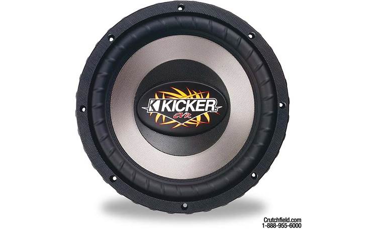

Are these any good in a sealed dual enclosure for $100?
29996
Link to specs: https://www.crutchfield.com/S-qp83qMY99Jt/p_2063C12VR2/Kicker-CompVR-CVR12-2.html
Put the pair in 3 cubes sealed and you should be happy.
Some dude is selling them in a sealed dual enclosure (box is sectioned off to each sub) for $100. They're 400 watts rms each. They look great and a little dirty. I was gonna go meet up and see how they perform.
I had the model before those. Same specs but different cosmetics. Did very well in 1.5 per sealed.
Make sure you know if they are dual 2 or 4 ohm to better match up with whatever amp you will be using.
They are dual 4. I still would have to get an amp. He was selling an amp called renegade by Rockford fosgate and its only 500 watts at 2 ohm. Those are 800 so I'd need something more powerful. Also i want to run it at 2 ohms so that my alternator isn't working too hard.
