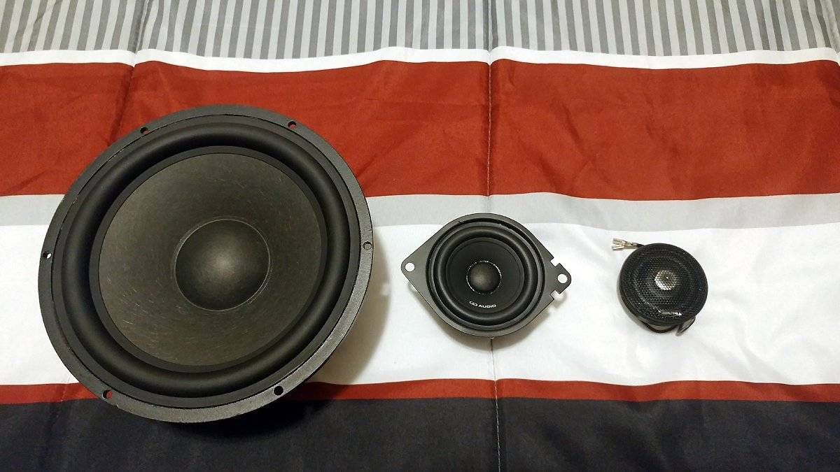

Well, My tweeters are on the way. I went with the Alpine Tweeters. I think the price is fantastic considering how much the Alpine component set cost for the SPX-17Pro... $1050 suggested from Alpine. But you all knew that.
SilverFlute 6.5" speakers are on their way!!!
Now I have the 3-way front stage taken care of. Time to source two more amplifiers. Mike and Lisa.
I am also going to get a sheet of Birch to make an amp rack out of and either some black perforated vinyl or actual perforated leather to cover it in to match the look of the seats.
I still have one more speaker to purchase. The Dayton Ultimax 10.
Well, this is the door set-up. Silverflute, Digital Designs, Alpine.
I am going to run the US Acoustics Barbara Ann 100 x 4 on the DD's and Alpines @ 4oms per channel
A US Acoustics Lisa will be bridged on the Silverflutes 170 x 2 @ 4ohms per channels
A US Acoustics Mike will run the Dayton Ultimax 10 1500 x 1 @ 1ohm
If this doesn't give me headroom for days I am gonna **** myself.
