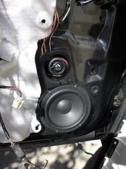

So I stumbled across this picture on a G6 forum. This guy put a 6.5" Silver Flute mid in the bottom and a 1" tweeter in the space above it... Judging by the size of the tweeter, that opening should fit a 3.5" speaker... right? What do you all think?

Nice! Some Aurasound NS-3’s would go nicely in that tweeter hole. Or some Tang Band bamboos.

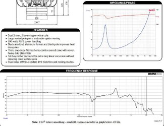

Ok... it is time to get some info and start the planning!!! @shredder2 this is what I have to work with. What specifically and exactly do you recommend for this exact setup? I want to do a single slot port. I listen to bass music with frequencies from the mid 20's and up (20% of the time) to all other music (80% of the time) up to 70ish hertz (Drums, Kick Drums, Bass Guitar, Piano, Jazz Instruments and Acoustic Instruments). I will run the Dayton single 10 all by itself powered by the US Acoustics Mike amplifier. This is not about loud but I imagine that will be a welcome side effect of the sub/amp combo. I want the sub centered on the baffle facing the rear of the trunk with a max of 14in tall from floor to top of the enclosure. I have the skills to build the enclosure with bracing and 45's. Rear deck 6x9 speakers will be removed. Amps will be on an amp rack. I now have all of the specs and they are as follows:
  1. Pontiac G6 GT Coupe -
    Interior Dimensions
    Passenger Volume (ft³) 90.1
    Cargo Area Dimensions
    Trunk Volume (ft³) 12.0
  2. Subwoofer - Dayton Audio UM10-22
    Impedance
    2+2 ohms
    Re
    3.2 ohms
    Le
    1.28 mH @ 1 kHz
    Fs
    26.9 Hz
    Qms
    3.08
    Qes
    0.59
    Qts
    0.49
    Mms
    227g
    Cms
    0.15 mm/N
    Sd
    327.8 cm²
    Vd
    622.8 cm³
    BL
    14.5 Tm
    Vas
    23.5 liters
    Xmax
    19 mm
    VC Diameter
    63.5 mm
    SPL
    84.8 dB @ 2.83V/1m
    RMS Power Handling
    500 watts
  3. Amp - US Acoustics Mike 1500w RMS @ 1ohm - I will be running at 1ohm and there will be a second battery in the trunk.
