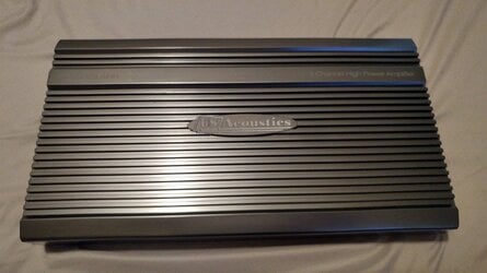

So no communication, no "Hey, this is what we found" no "Hey, the amplifier is fixed, it's on its way!!" I wake up this morning and my brother says hey, your package is on the couch.
Sent back in the same package... no notes in the box with the amp. I inspected the RCA input for channel #2 and it seems solid so I guess she is fixed. I will know as soon as I put her in the car and start from scratch with the 3sixty.3 :|
Glad she is back though.

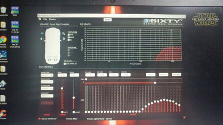

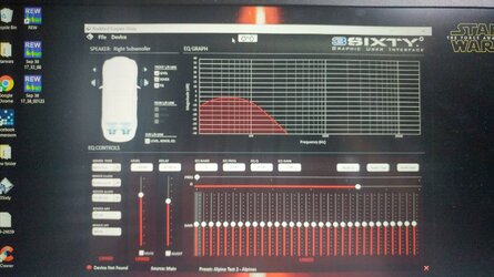

Ok, I Band-passed the sub. 32hz-80hz @ 24db

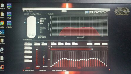

Reset the Mid-bass 80hz-2.5Khz @ 24db
Reset the Tweets 4Khz @ 24db
