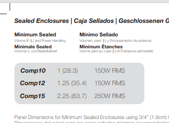

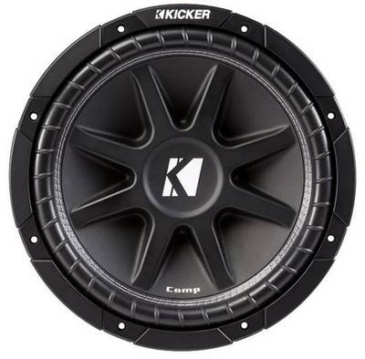

Two 4 ohm SVC subs that are 150w RMS each. They should be wired together for 2 ohms.
That amp is 600w RMS at 2 ohms.
That enclosure is only half the air space those subs are minimum recommended for.

Those kicker comps are from 2016. They may have included the wrong ones, but more likely the are dumping off old stock to make room, and he is the sucker that bought em.

Here are the ones in the package they just bought, that this same seller has for $99.90
The difference is $84.06 each, ($168.12 for 2). I hope you're still in the 14 day window. If you are here, is what I would tell them. This package is horrible and the speakers don't fit in this enclosure, and this amp is too much for these speakers. The Correct speakers would have been ^ (and give them the item numbers). I would tell them, I think this is their fault for a bad package (and it might have been an accident, were not trying to point fingers and get people mad, we're trying to make this better), and I want them to pay for the return shipping on your subs, you pay the $168.12 difference, and then they send those other subs that can handle the power and fit in that enclosure. I guarantee he will be much happier.

2) Enclosure is way too small for those subs. IMHO those subs belong in 1.5cuft each, if not closer to 2cuft/sub. (High QTS & VAS). Those would be good subs for an infinite baffle set up, terrible subs for an under the seat enclosure with very little airspace. That enclosure (airspace) screams 10s to me.

The subwoofers you included in this package are the 2016 Kicker 43C124 Comp C12 Sub 12" 150 Watt RMS 4-Ohm SVC. These are rated at 150w RMS and require 1.25 cuft of airspace. ( https://www.kicker.com/app/manuals/subwoofers/comp/2016_Comp_Rev_F.pdf )
The amplifier is rated at 600W RMS @ 2ohms. (which is what these subs are rated for at peak).
The enclosure in that package is listed at .6 cu ft per sub (which is less than half of the minimum required sealed volume).
