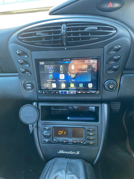

I have had one other idea, and am sure that it must be something others here are familiar with. One of the reasons I have picked the Alpine ilx-507A is that it has Tidal (and I have a subscription to the high rez items). But I note that it also can connect high res files via USB. What I would like to do is have a small SSD tucked away, along with a cable for the USB (so it can be removed and replaced). I don't want cables dangling (hence my preference for wireless and the ilx-507A over the ilx-407A, which is not wireless). So, has anyone done this? Old hat? Is there a USB port that can be recommended for the purpose (to be fitted inside a small case below the air con).
The small case is behind the gear shift ...
This is how it should look after installation (above is my car, but below is off the 'Net) ...
For those interested, my old but nurtured 2001 Boxster S ...

Just to complete this thread.
Installed: Alpine ilx-507a 7" head unit, Alpine KTA-450 amplifier, Focal ICU-130 speakers in the doors, Focal ICU 100 speakers in the dash, and retained the Bose speakers in the rear tray. There is also a 1 Tb SSD (in the tray) feeding the HU with up to 192kHz/24Bit FLAC files. With Apple Play there is also Tidal streaming.
What an upgrade from original stock Becker radio and Nokia speakers!
Thanks for all the advice along the way.
