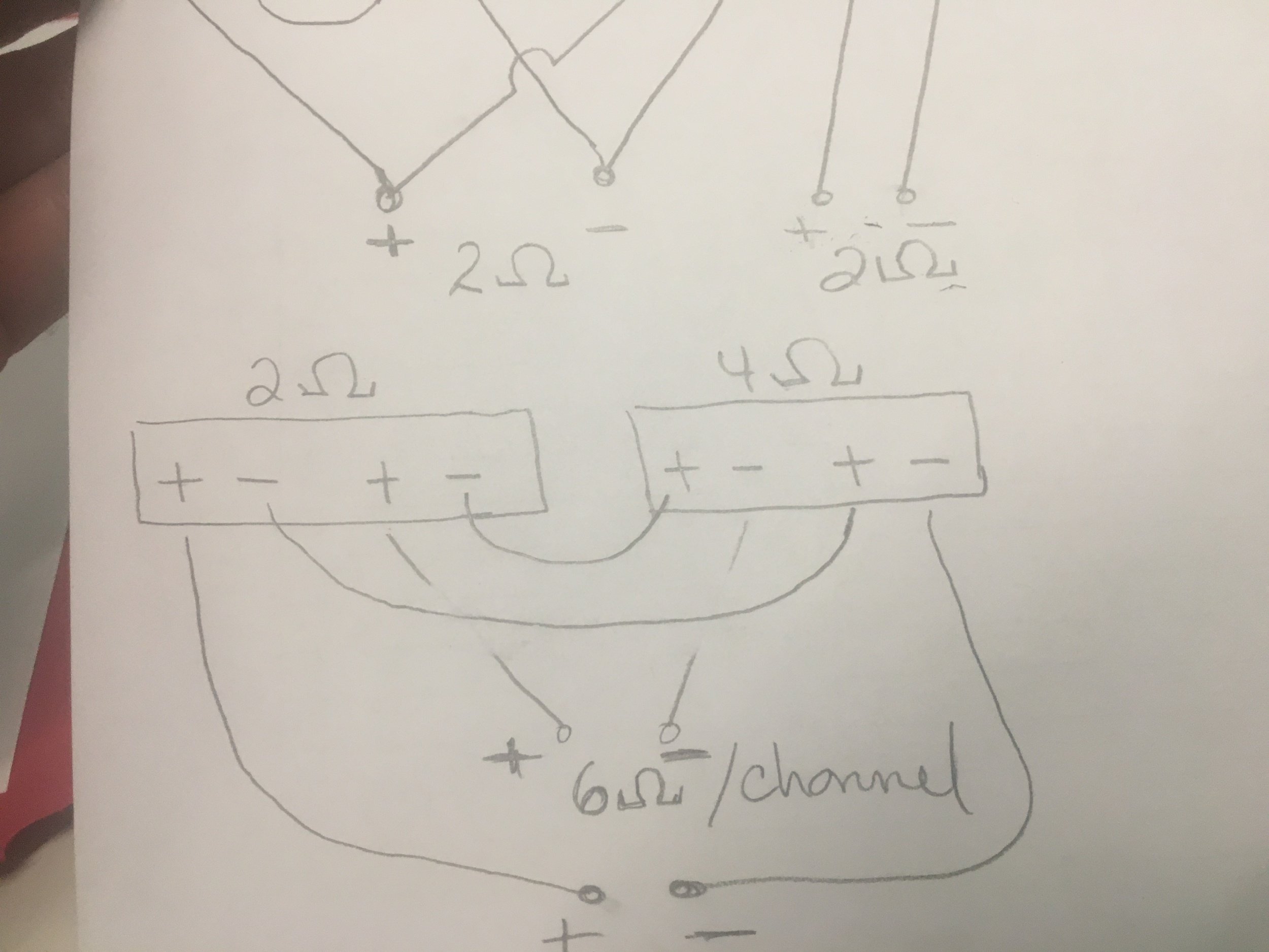

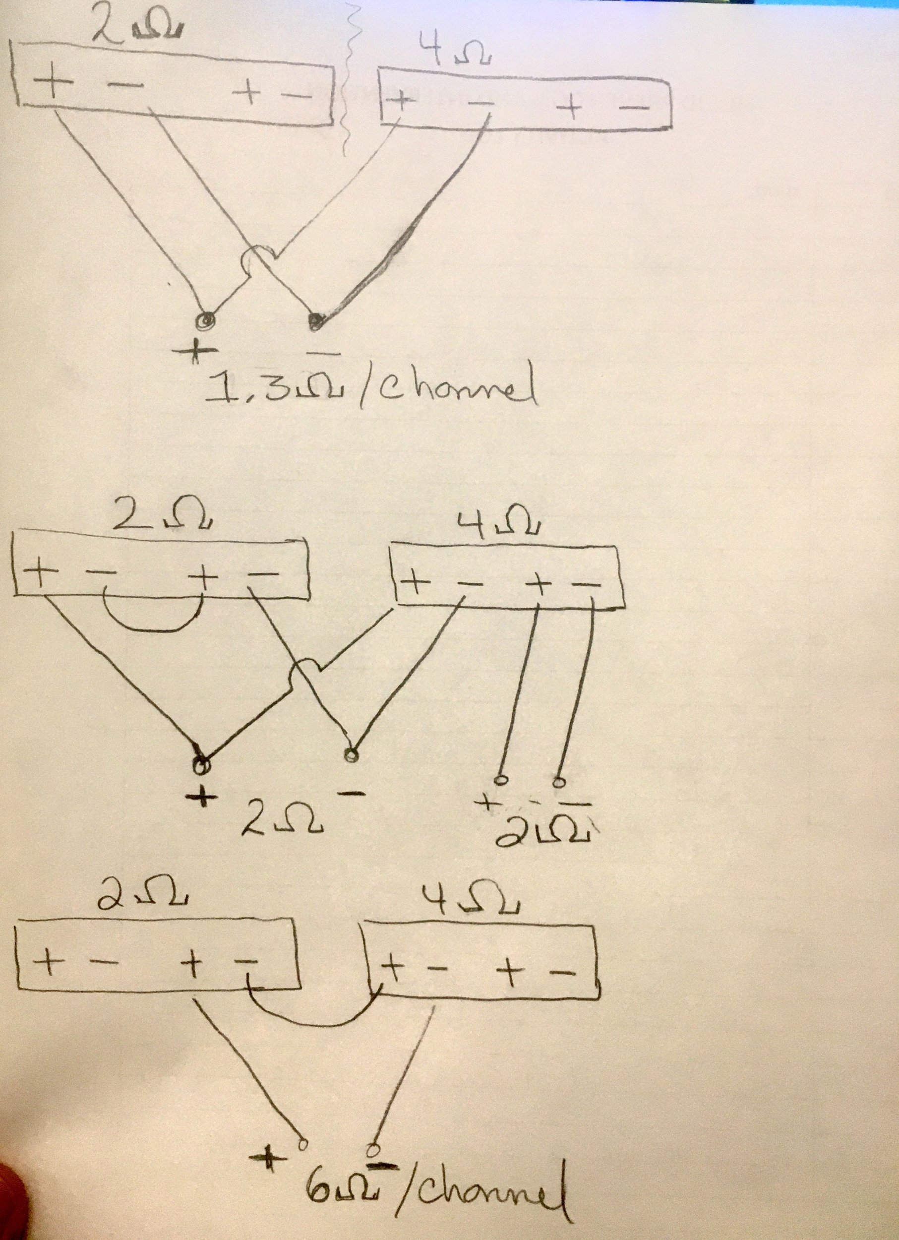

For consistency, I would go the 6 ohm route. I'm guessing you can't afford to be risking a toasted amplifier by experimenting. Diagram coming shortly.
6 ohms is the least risk. I left the wires out of the picture for clarity. You would wire them the same as the ones shown.
****, man I’m sorry. I’m still confused. I see the bridge wire in the middle. The two wires going straight out to the +&— symbol what are those for? Can you finish the 6 ohm diagram?
You would bridge a positive and negative from the "outside" coils, just like is shown in the diagram, then run one wire from the remaining empty positive to your amp, then a wire from the remaining empty negative to your amp.
So the coils are fully connected in the middle? Neg pos to neg pos?
