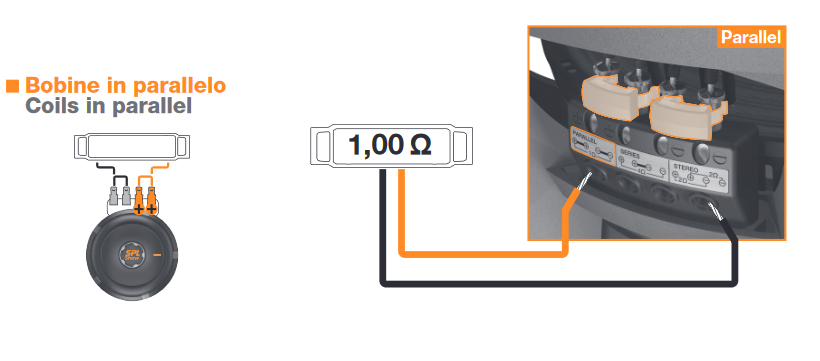

Do you have your subwoofer connected like this? If not, you need to connect it like this and run the wires correctly to the amplifier. It should have no problem at that point moving that sub. If it does, you may have to re-adjust the LOC to the amp using the C.L.E.A.N. lights on the amp.
Thanks for the reply. Yes I do, the resistance is 1.35 unloaded which seems good. It does a good job moving the subwoofer, but I feel like it clips earlier than it should and the bass boost is pretty weak compared to what I would expect. As for it clipping early I hope it's down to the fuse starving it for power but I could be wrong (100A fuse but 200A is recommended by Rockford). It's my first sealed system so I may be expecting too much power but it's barely louder than the old amp if it is at all. I should expect a noticable difference between a 500W and 1200W amp, no?
