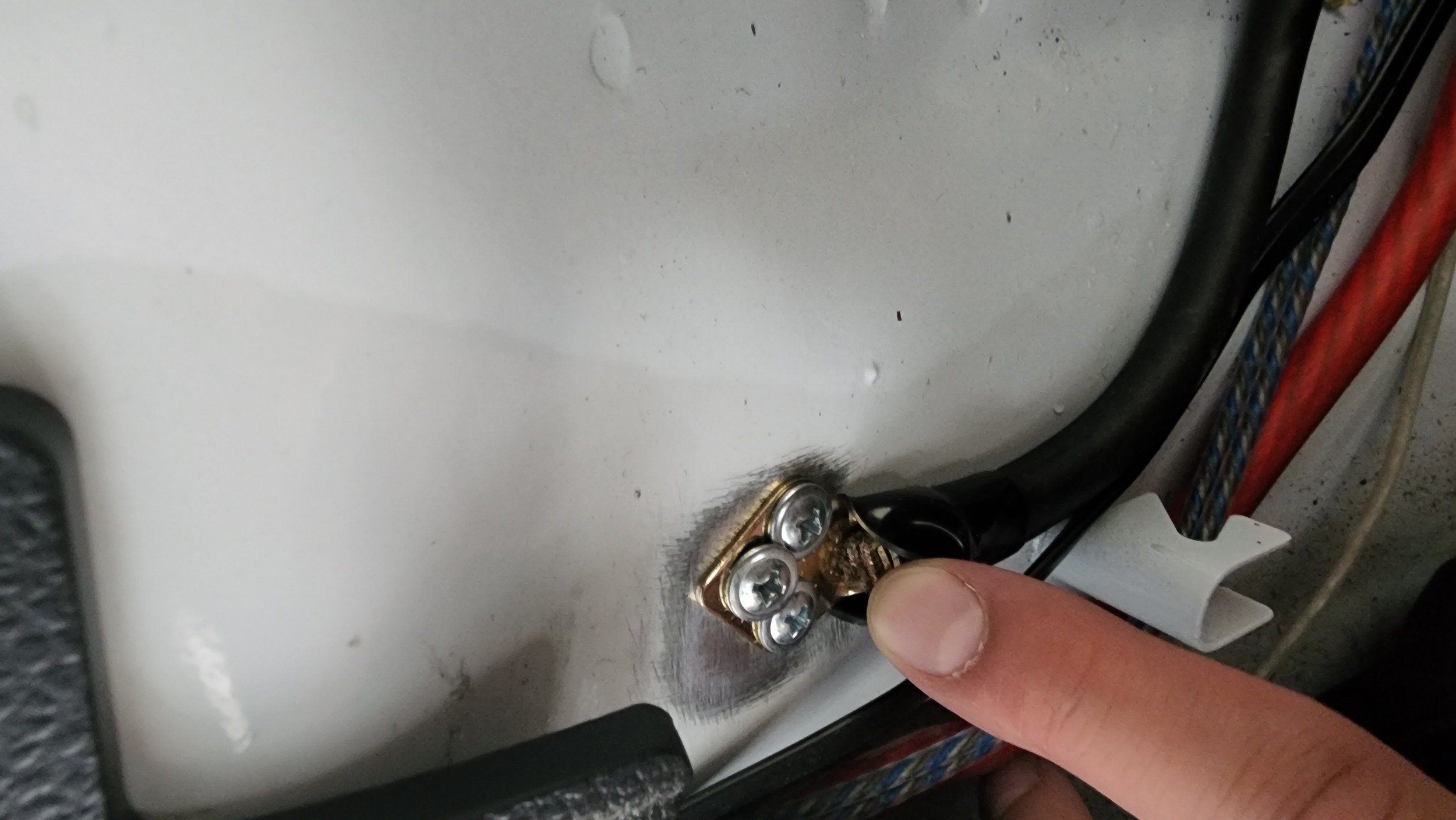

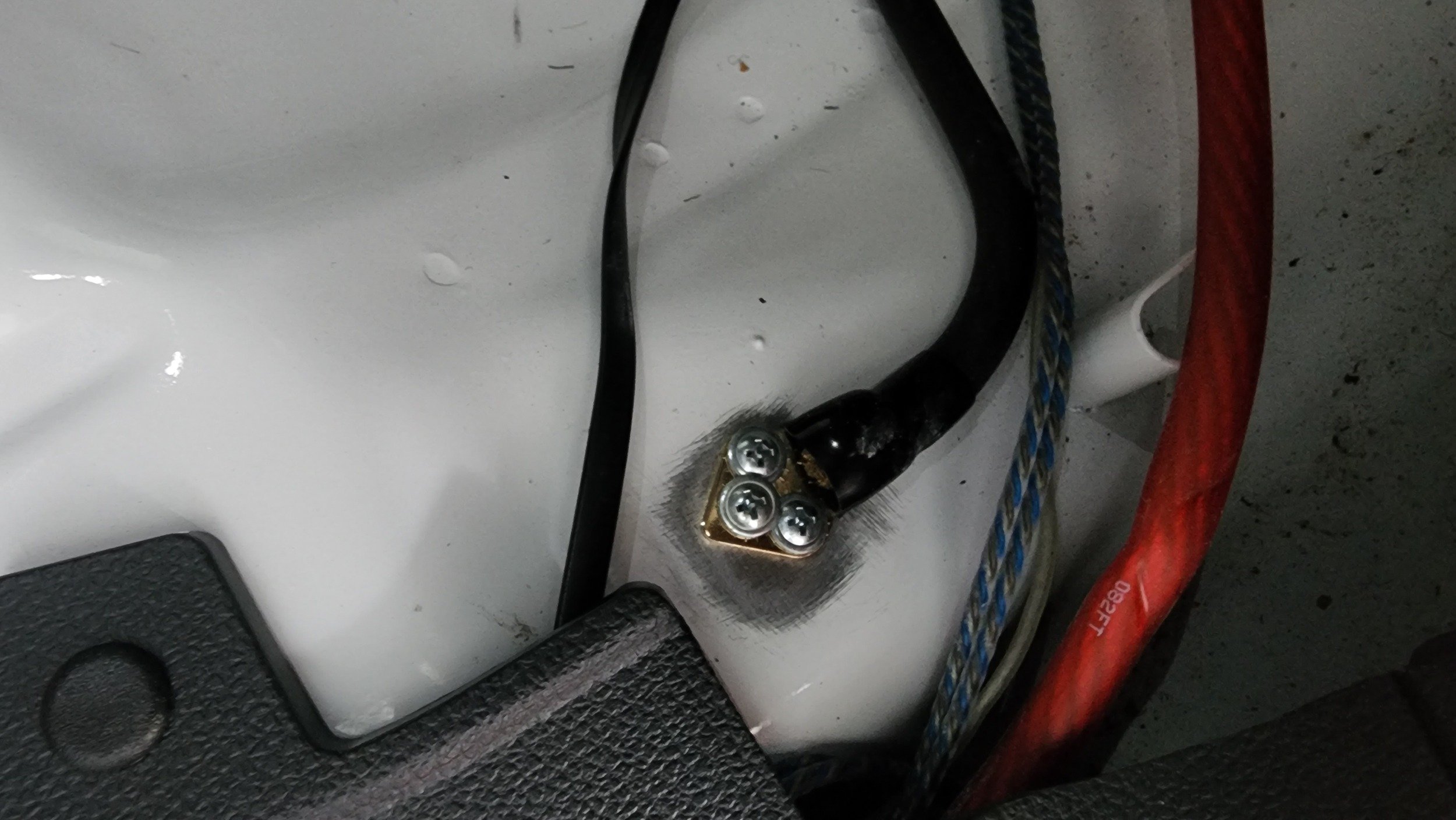

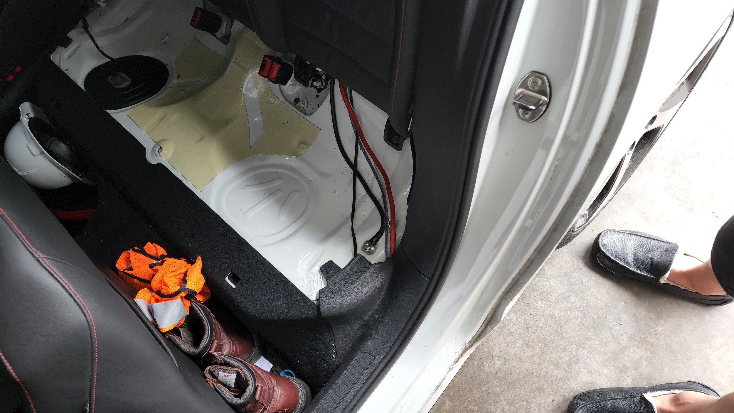

Here are some pics of the ground - I have been hesitant to take out any part of the car but at this point I'm willing to rip it all apart to get to the root of the problem.

That ground is horrible kinda embarrassing that a shop would do that. I would cut that end off, crimp on a good copper lug & heat shrink it. Then find a seat bracket with a steel bolt through it, take the bolt out sand off all the paint on the bracket where the bolt goes in so its nice & clean. Put the bolt back in and go from there. Been doing it that way for almost 30 years never had an issue with doing it that way.
