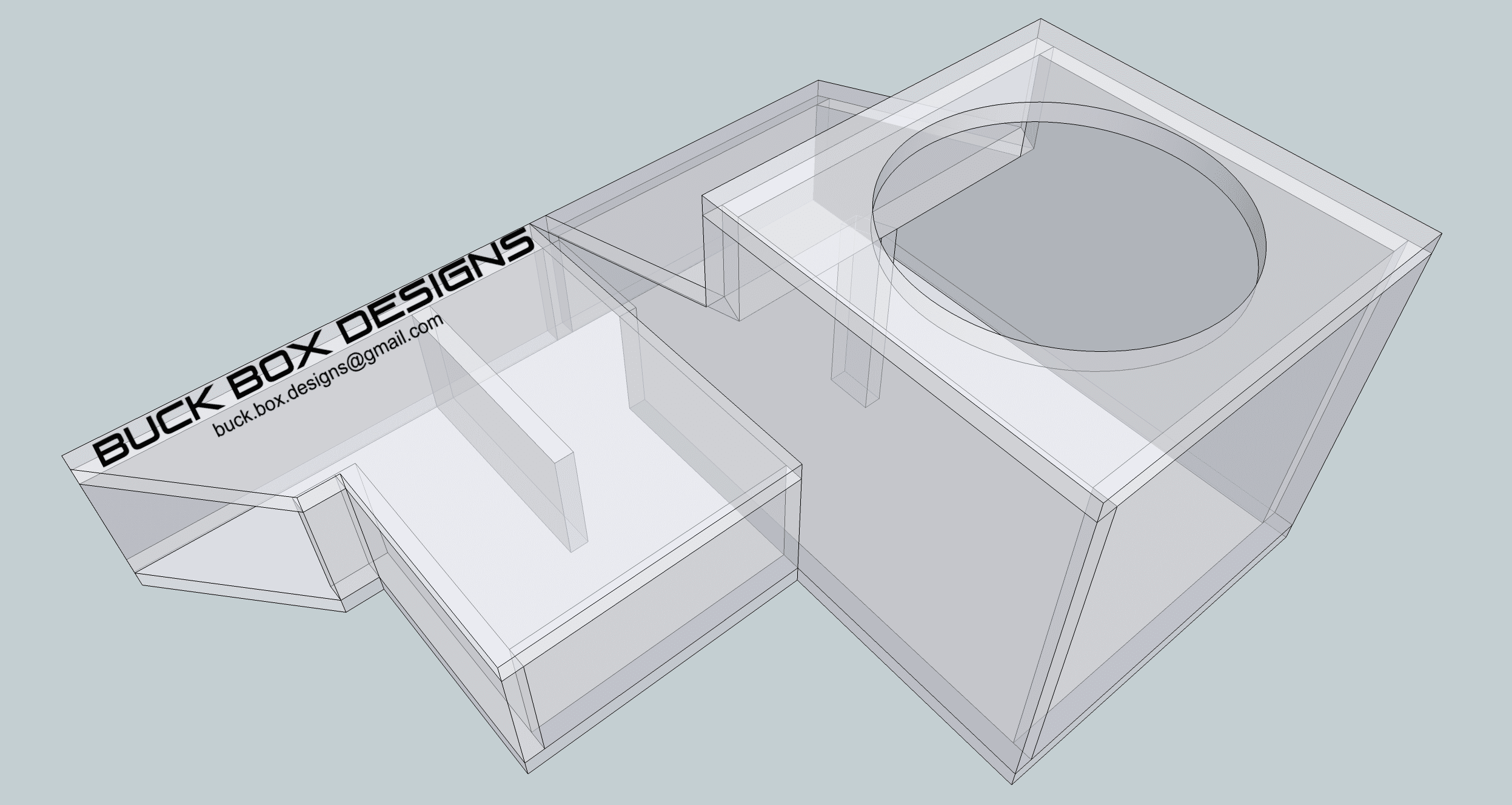

Box will be aero ported and I’m unsure exactly what it’ll look like but will go to Buck for design.

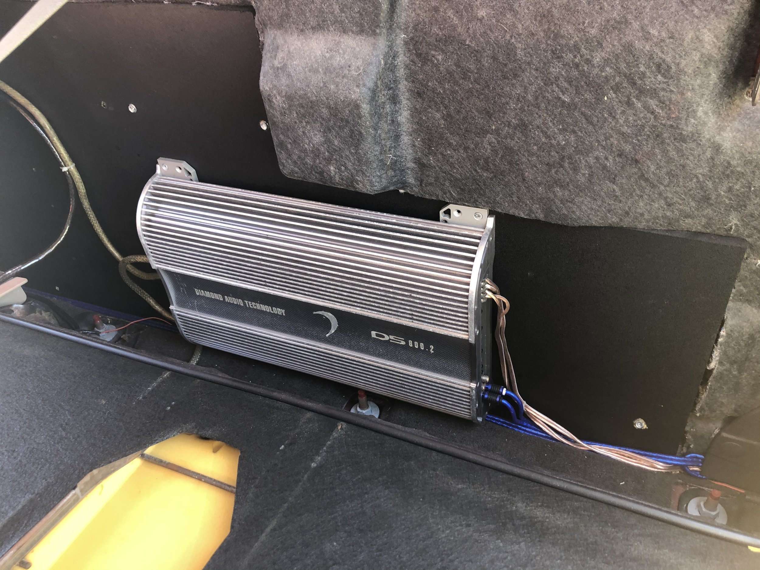

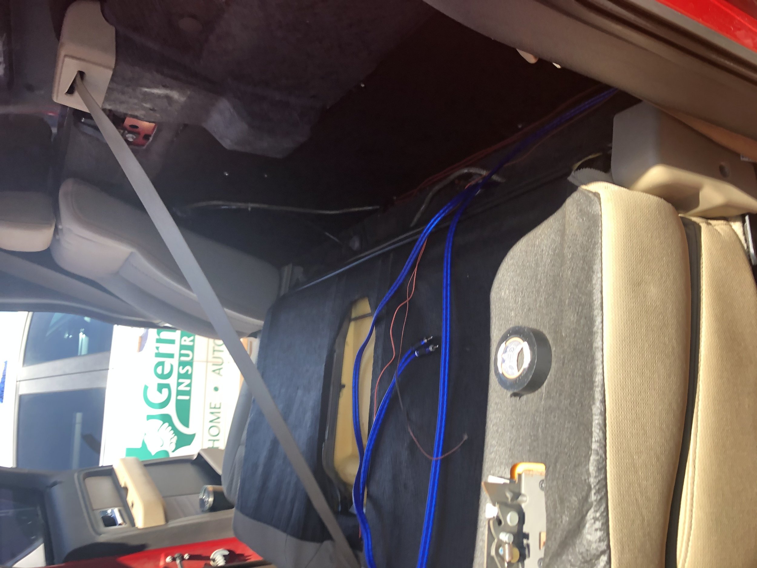

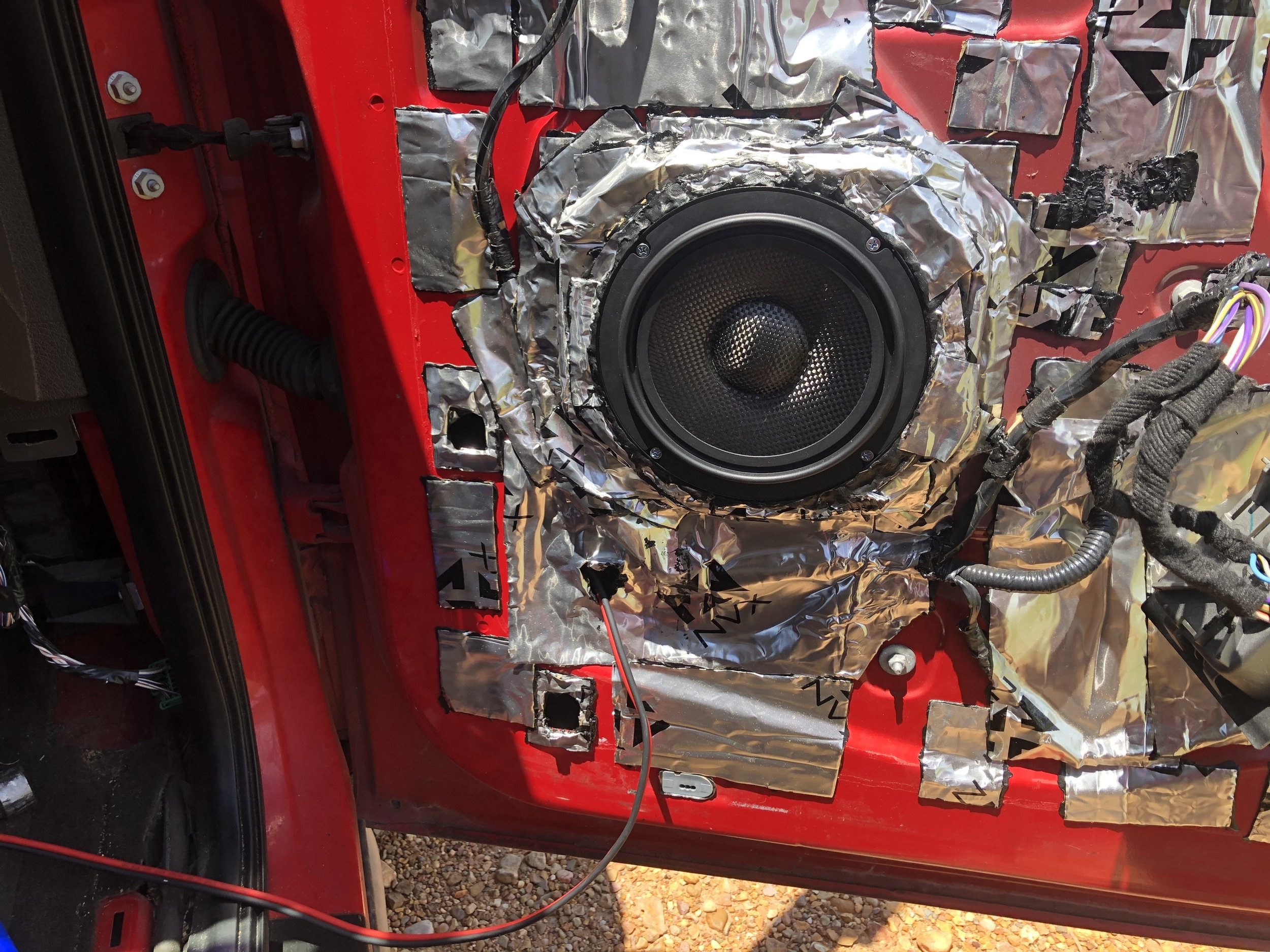

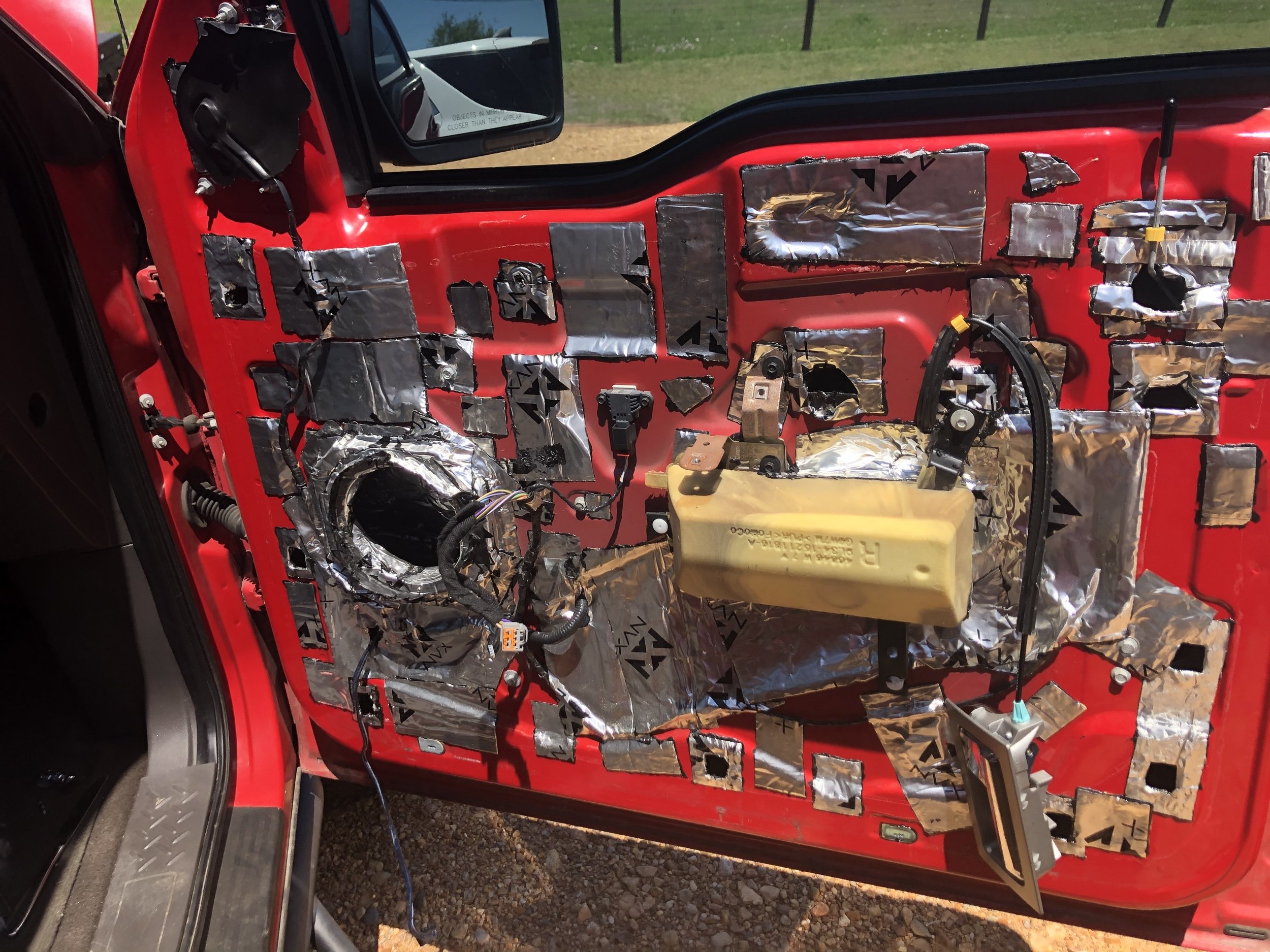

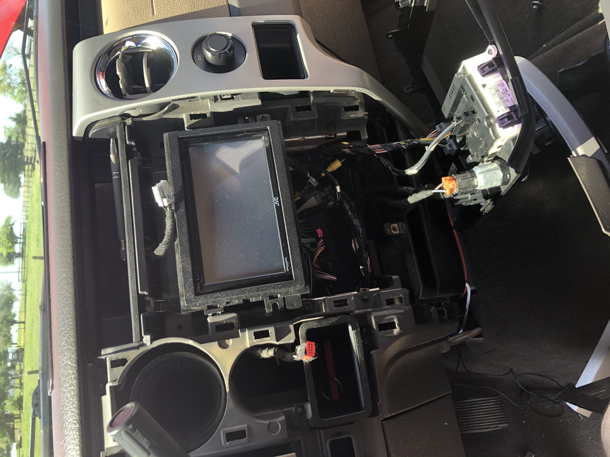

Here are a few photos so far. Removed my ID CSX components and my Diamond D5 600.2. I have all the speaker wire ran. I need to run the new power wire next and then install the speakers. I’ll be without bass until I get the box built.
Man that last picture reminded me of just how much I hate put that sound deadener on.

Yes. I have everything sealed that I can at least. These panels hook in so I may address that soon to completely seal it. The deadener is NVX brand. I got it free a couple years ago with my Image Dynamics order from Sonic. I found a glitch in the system haha. It’s ok stuff. Definitely liked my second skin stuff better but it was free so why not? I have crossover points set but that’s about it and they really do sound great so far.
