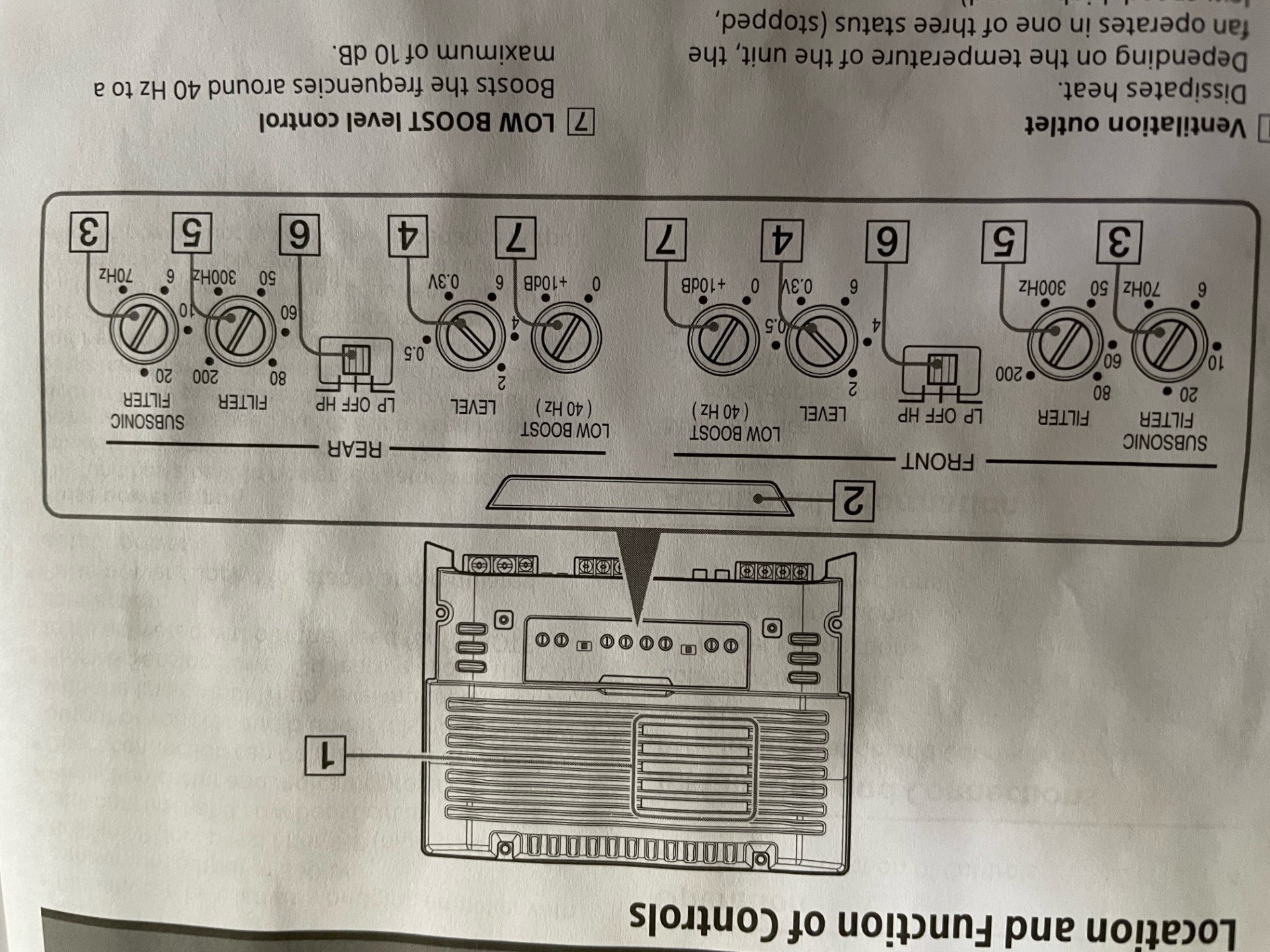

I finally got my Sony amp that's listed in my signature installed yesterday, but I have no idea what some of the settings are for. It has a subsonic filter adjustment, and low boost level adjustments for both front and rear speaker channels in addition to the HPF, and LPF cut-off frequency adjustments, and gain controls for both channels. What are the subsonic and low boost level adjustments for and how should they be set?
Subsonic is the lowest frequency you want your speakers to play at. Alot of users set this 5 Hertz below their box tuning frequency. Low boost is Bass Boost. I have been told this is set at 45Hz, but some amps I have seen they have a pot to adjust this frequency.

This is what's under the amplifier cover.

Subsonic blocks anything below it. Filter blocks anything above it when set to Low Pass or anything below it when set to High Pass. Level is the Gain for those channels. Low Boost is bass boost at 40Hz.
I would set the x-over switch to HPF and the frequency pot to 80Hz. Then set your Gain to your desired voltage.
Sub sonic full clockwise and low boost full counterclockwise.

How do the level voltages work since they go from 6 to 0.3v? I thought 6v is louder than 0.3v? Sounds odd to me since clockwise is usually louder than counterclockwise for gain, but 6 is counterclockwise and 0.3 is all the way clockwise. The speakers get louder the closer to 0.3v, and the manual says turn it clockwise if the speakers aren't loud enough.
If you know the source only puts out 1 volt, then you set at 1 volt. If you set it at 6 volts the source's 1 volt will not be able "push" easily through the 6 volt "choke" point. Therefore it will be quieter.
On the other hand, if your source puts out 6 volts and you set gain at 1 volt, those 6 volts will just ram through the 1 volt choke point. Therefore, it will be way louder to the point of signal failure, aka clipping.
