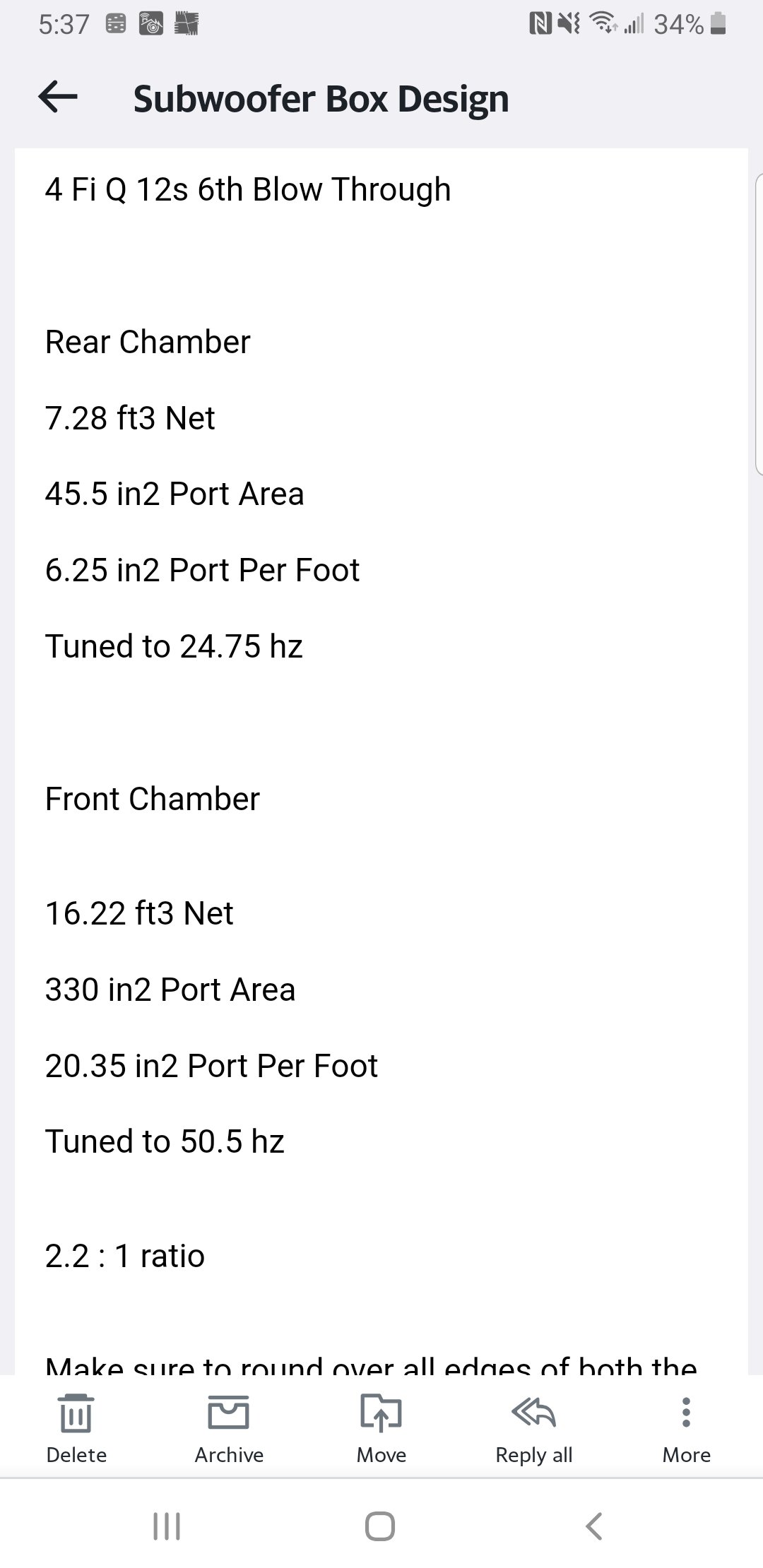

This box, the ported section, is 9.3 ft³ net. So decently big. Regardless if/ how much the bracing effects the enclosure, it needs to happen. It's just something I'm going to have to calculate beforehand in the future.
When I get to installing my box in my truck, it's a sh*t ton bigger. 16.22 ft³ in the front section (series 6th order blow through) so I'm thinking at least 2 braces in there (even that might be insufficient). It is what it is. Both builds are just daily, music builds. So the effects would be minimal to the musically listening I would assume. Though I don't really know a huge amount about enclosure design. That's why I outsourced that aspect lol.
I agree. I hope to not make this same mistake in the future.
Series 6ths can be difficult, if you’ve never done one before. It’s really just a ported box inside of a ported box, where the ports are what’s in series. I can give you some pointers on that; it’s really situation dependent.

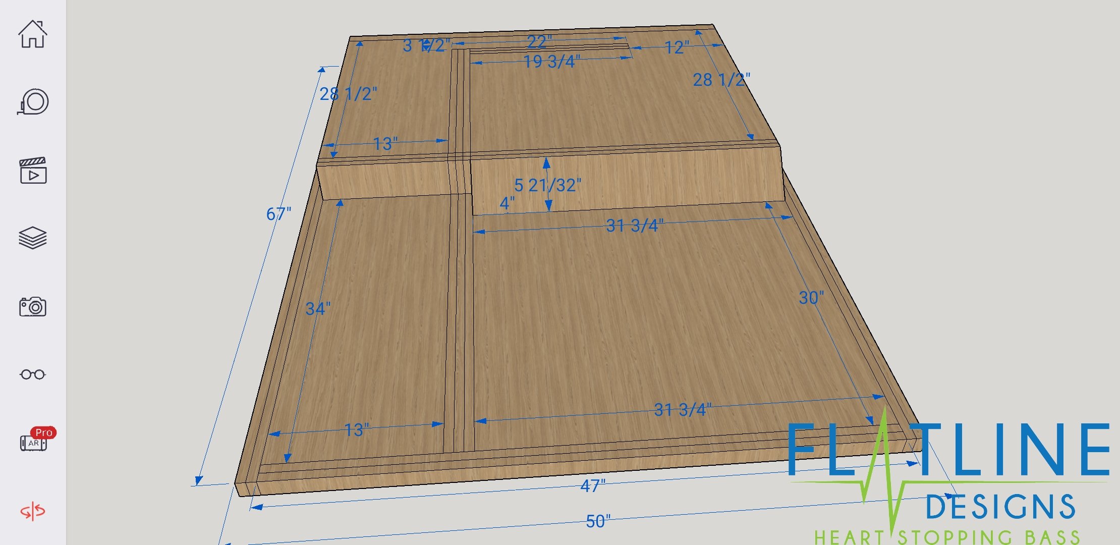

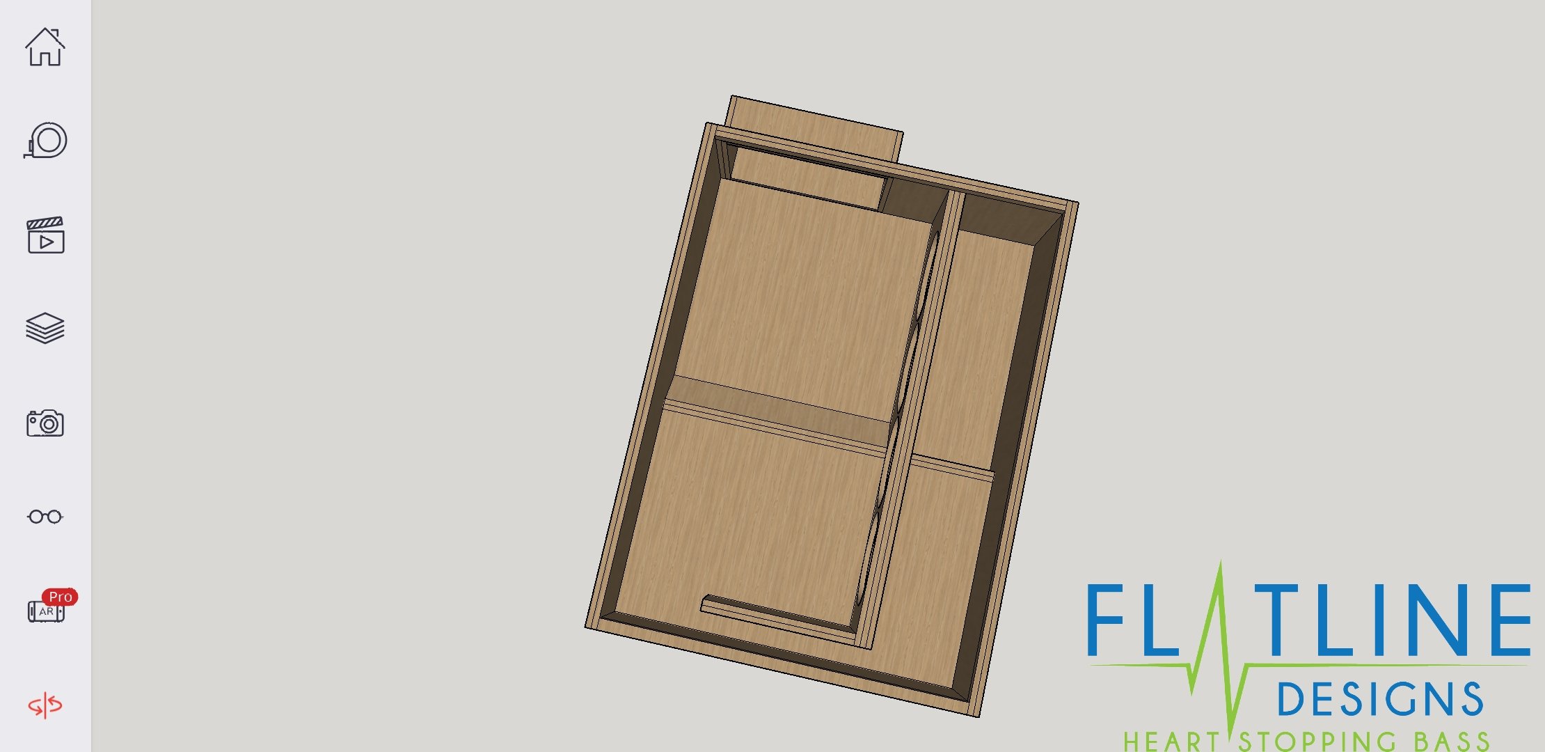

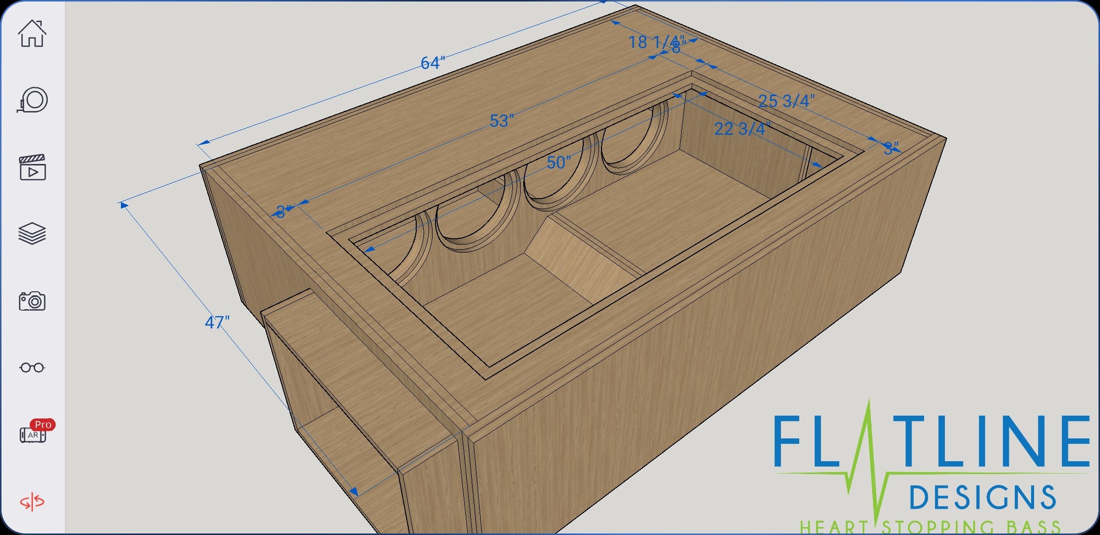

It's kind of a funky design, I know. My original plan was to mount the amps under the box. That's why that back section is raised. I have since thought better of that idea. Though I'm afraid of changing the design because series 6th orders are so temperamental.
It's also designed to have a huge plexiglass top. I'm not putting that in. I put a camper shell on my truck, instead of a tonneau cover, so I can still use some of the bed. So the top of the box will also be reinforced by lumber raising the top, so I can secure a "false floor" to sit kind of flush with the top of the bed.
I'm also going to cut vents in the false floor to accommodate 5 4" fans to keep air circulating for the amps
View attachment 40191View attachment 40192View attachment 40189View attachment 40190
I mean if you change it, you would just try keep the specs the same. I don’t think series 6th’s are quite temperamental, I just think the specs have to be correct for woofer, power, and what you’re doing with it. Series 6th’s just have to have proper energy movement through them, and the volumes are relative to the response you want. You can make a series 6th whatever you want, just as long as you do it correctly. That’s a pretty low tuning for daily, IMO, but idk what was discussed. Some people’s daily music is way different that others. A lot of people seem to tune around there with bigger series 6th’s now, for super lows.
I mean if you change it, you would just try keep the specs the same. I don’t think series 6th’s are quite temperamental, I just think the specs have to be correct for woofer, power, and what you’re doing with it. Series 6th’s just have to have proper energy movement through them, and the volumes a relative to the response you want. You can make a series 6th whatever you want, just as long as you do it correctly. That’s a pretty low tuning for daily, IMO, but idk what was discussed. Some people’s daily music is way different that others. A lot of people seem to tune around there with bigger series 6th’s now, for super lows.

Idk, your series 6th should be very loud. 4 12’s on that much power should slam. All you gotta do to change tuning is shorten the rear port, or even the front port. But changing the front port also changes the effective length of the rear port, so be careful there.
I was led to believe changing either port in a 6th would effect the other. Front or back.
So if I want to change the back port, shorten it for any reason, it wouldn't effect the front port? Also, would shortening to raise the tuning effect the port area for the rear chamber? I have no idea what the port velocity modeled to, but it's already small at a little over 6 in² per. Just being curious
