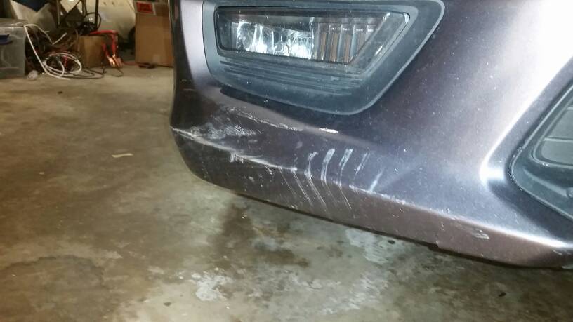

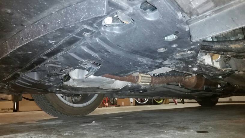

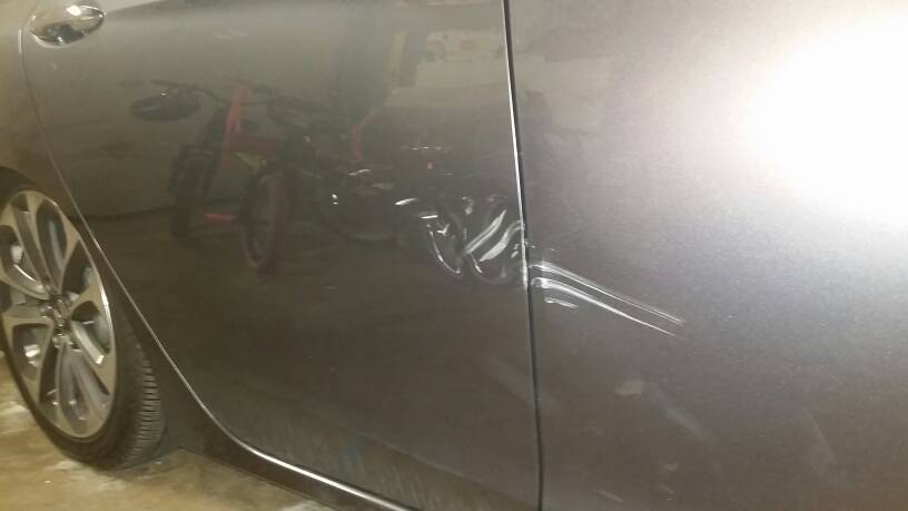

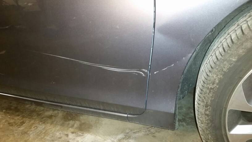

car was found today. nearly intact. some body damage and a few small items missing inside. all of the audio is there. they apparently don't know how to undo my puzzles.
Wow man ! I just saw it was stolen but to get it back in one piece is unbelievable. Around these parts it is stripped and burned overnight ! I am so happy to see that didn't happen there. And just a question, No hidden kill switch ? I wired a switch to kill power to ecm on mine and hid the switch well but my kind truck is very easy to steal.
