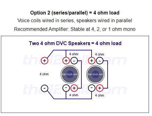

Theoretically, if you insist on this configuration, you would wire the two sony's like this
That is 4 ohms to one of the channels on the DUAL amp, the other would be the 4 ohm twelve. That only gives you 240 watts to the two 10s and 240 to the 12. This could work in the interim but you really need a different amplifier. If you do this, don;t tune them differently, nothing to gain tuning the tens slightly higher, just losing low end.

If you dont have any money to spend right now.. just run the tens on the amplifier as shown in 4 ohms bridged on two chs and not hard/gain cranked, and tune them to suite what you have and save for something around Tax return season? You still have two chs that you can use on the door speakers in HPF/Full
