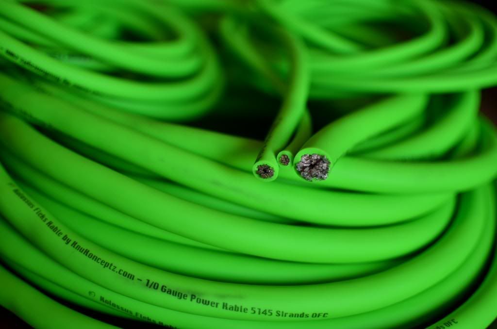

Dat wire
KnuKonceptz Kolossus Fleks Kandy cable. 50ft of 1/0ga, 10ft of 4ga, and 16ft of 8ga, all OFC. 4ga for my Levi, 8ga from sub amp to box, 1/0 for everything else to include 2 positive runs front to rear. This is half of the wire I need, this is all my positive. Need an equal amount in black for negative. Will be getting Sky High Car Audio wire from Jim.
