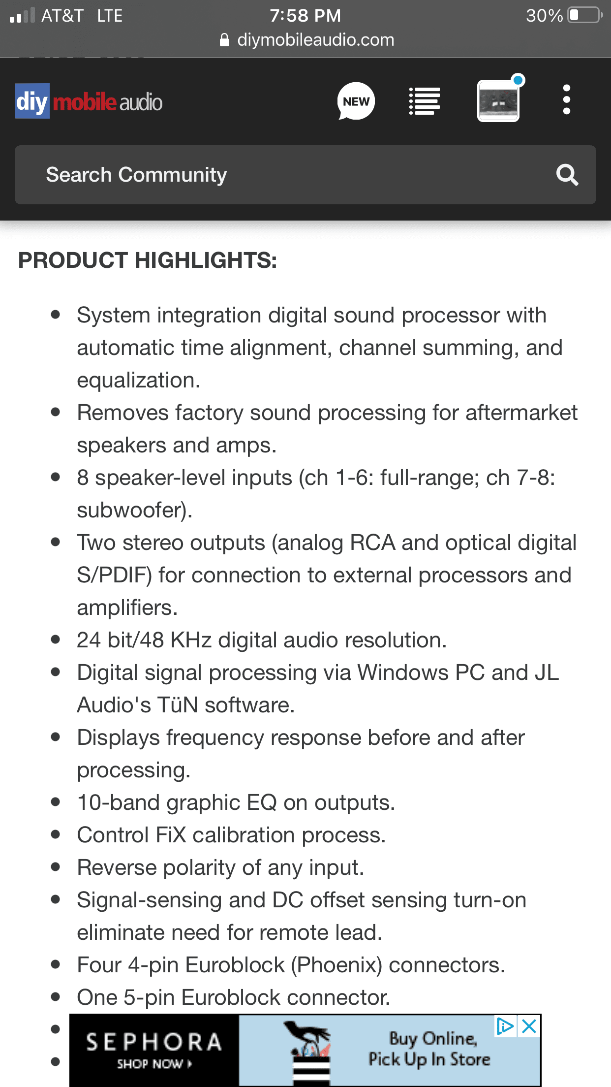

The fix will fix the stock signal so you will be getting a flat signal to your amps. The dsp allows you to tune the sound. I actually currently don’t run a dsp only because I don’t have the time to properly tune it. Once I get some free time back on a regular basis, I will be installing one.
The JL stuff is expensive new but you can find them used and creativeaudio has refurbs sometimes.
The Fix actually does more tuning than I thought. Guy on DIYMA is selling one for $300.

One or two, they are still subwoofer outs and are mono summed signals from both left and right. Even the 2 RCA subwoofer pre-outs on the 2nd one...
